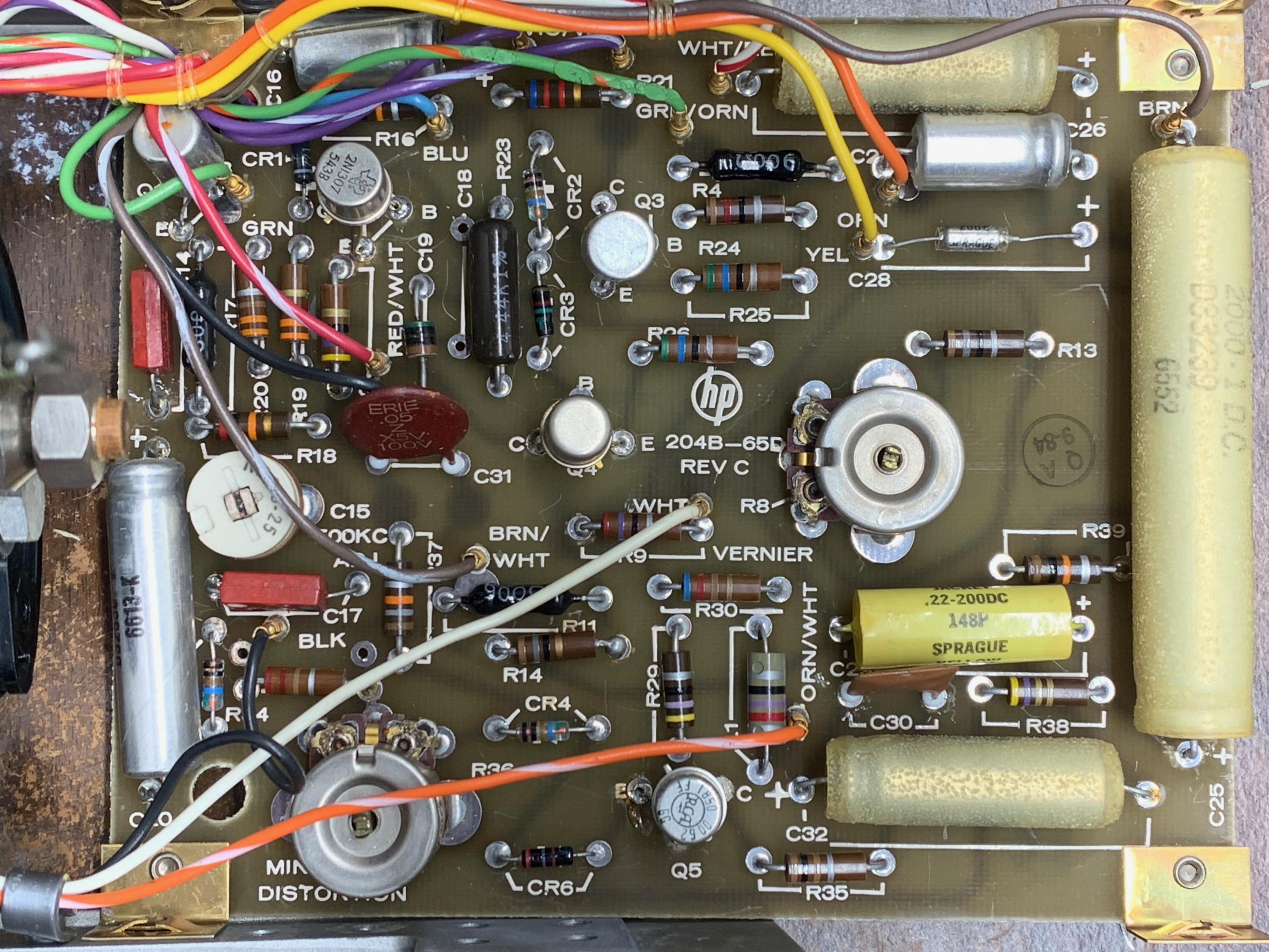

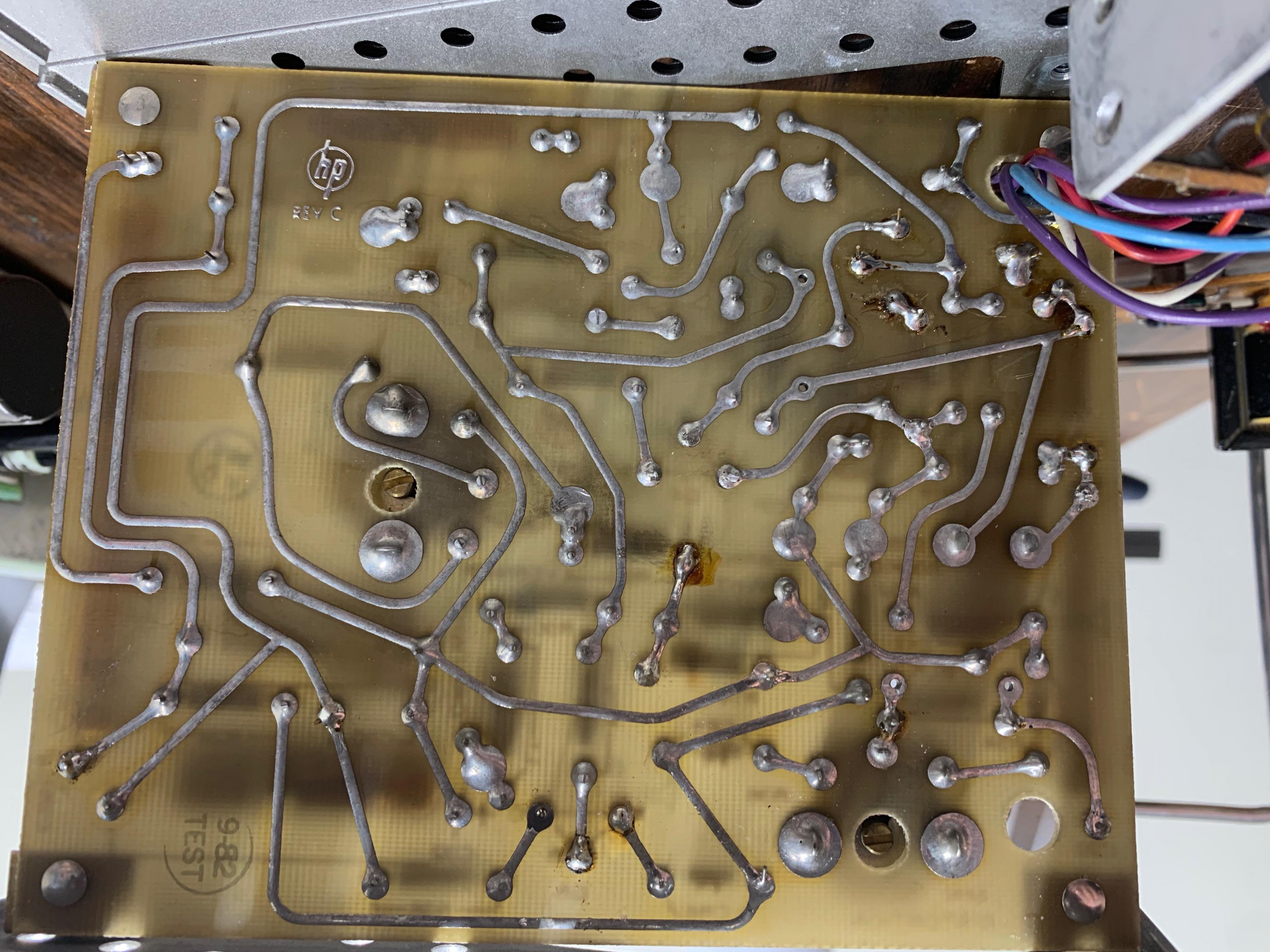

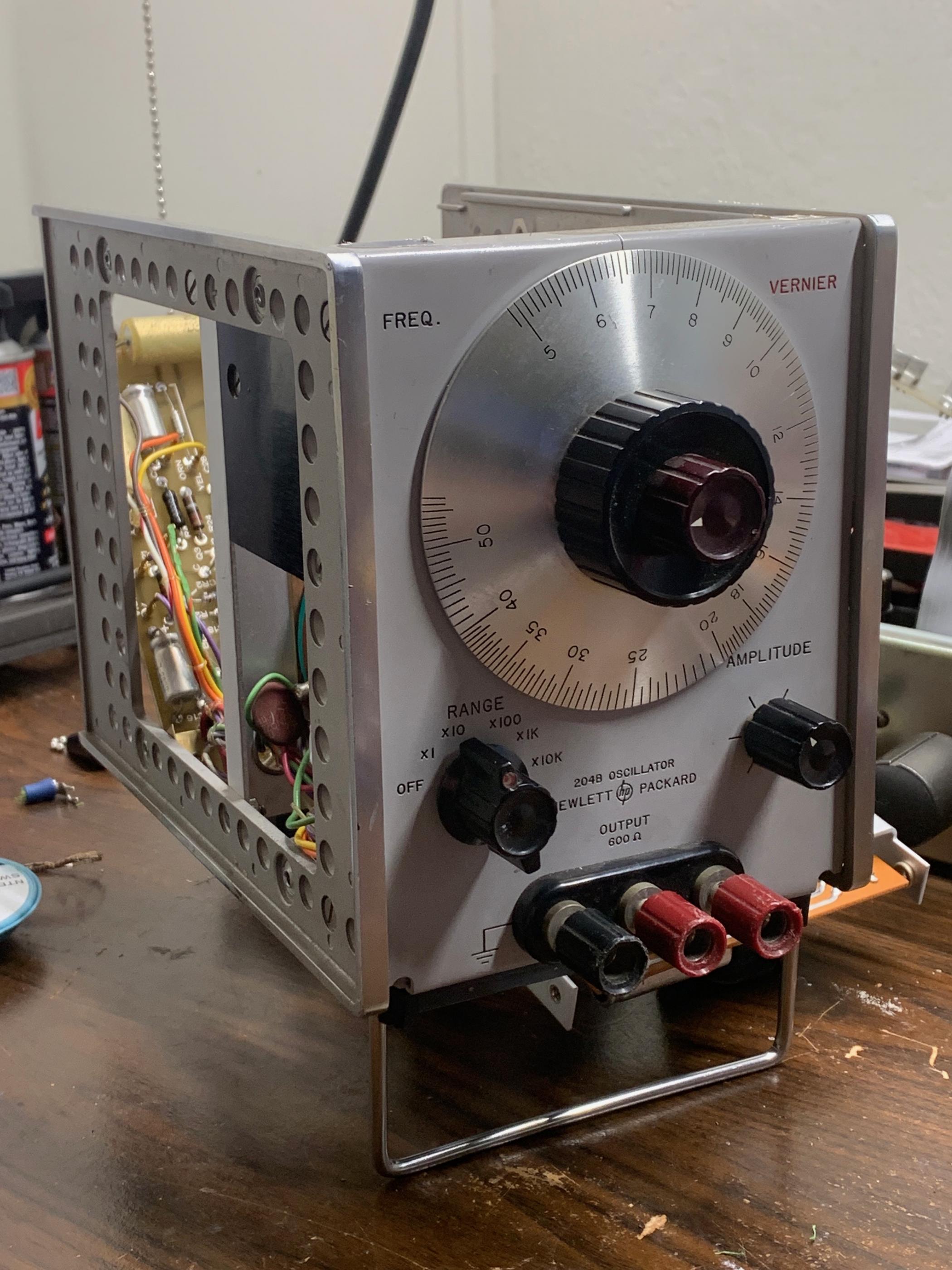

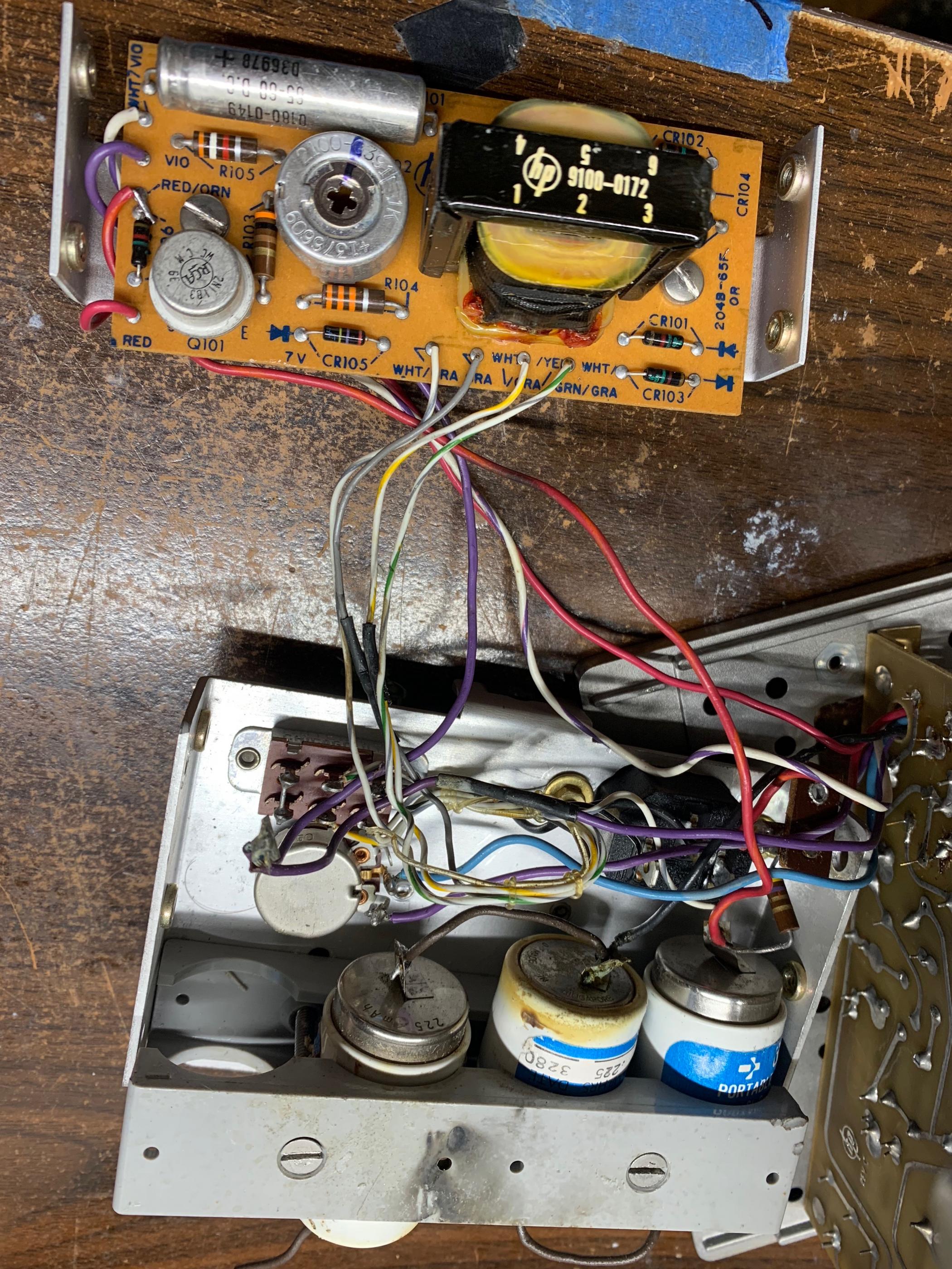

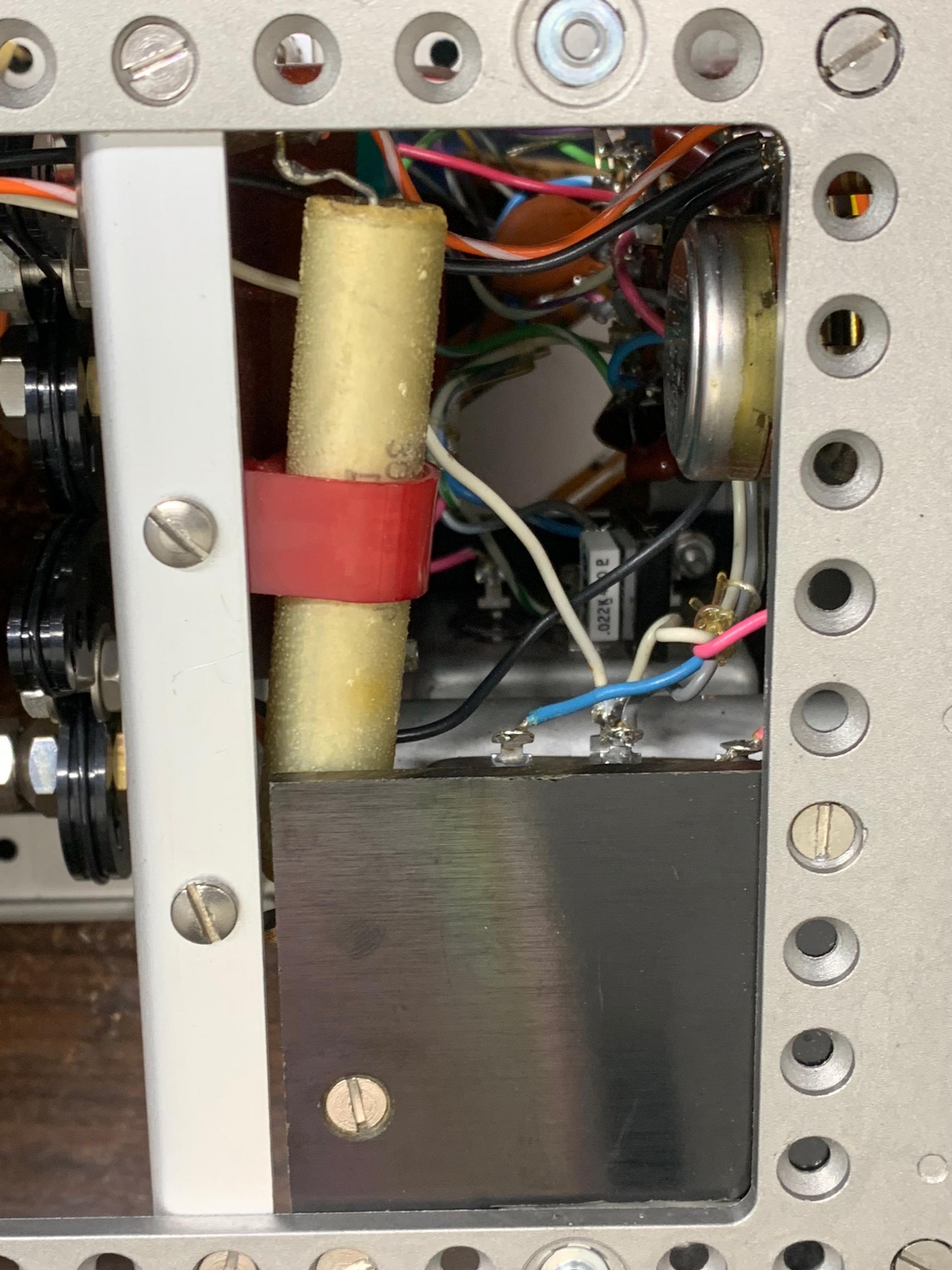

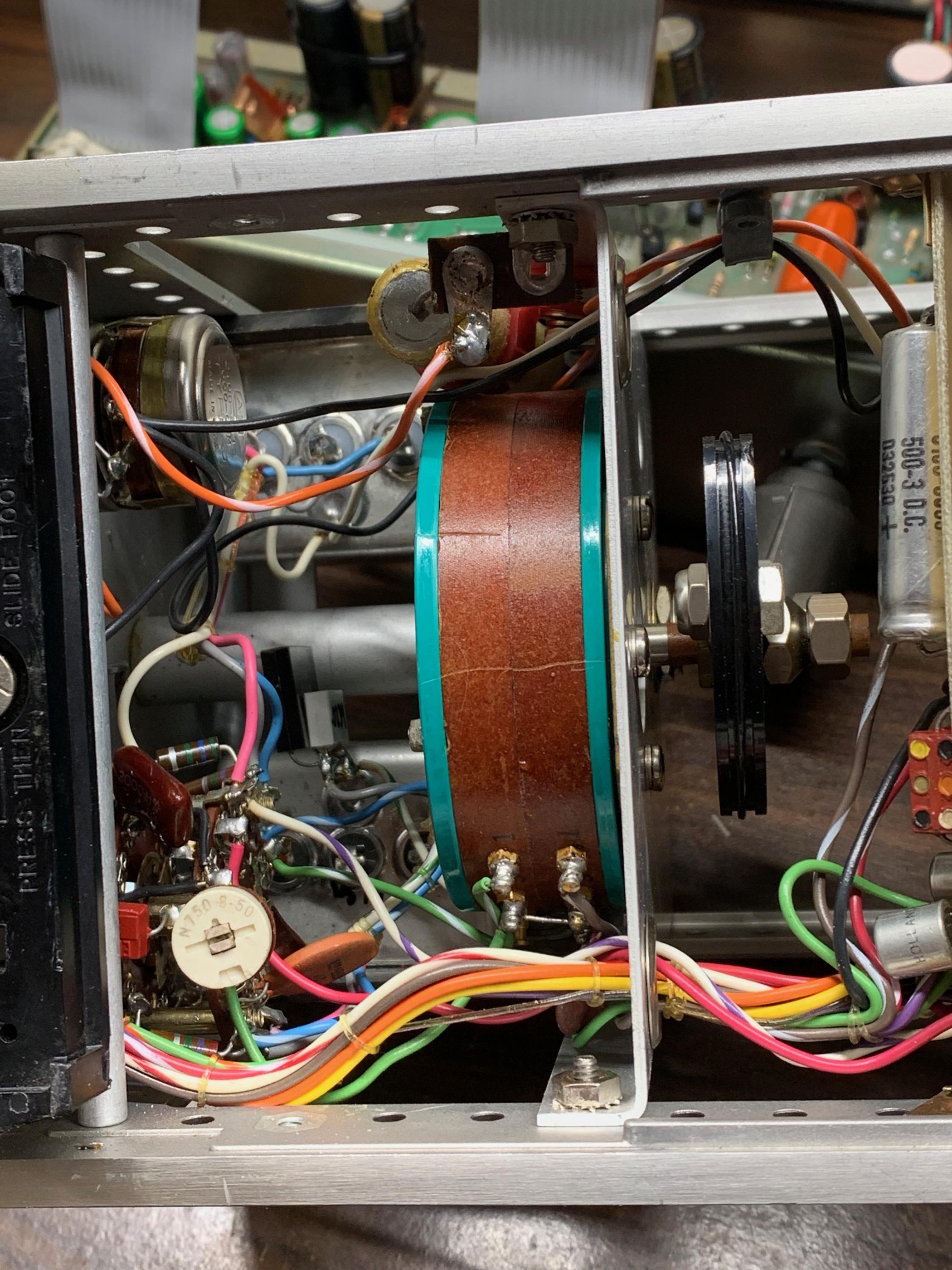

Here are some pictures. They are, in order:
* Batteries/power supply board
* Back of main board
* Front of main board
* Side of knob connections
* Bottom of knob connections
* Money shot
I noticed what looks like charring on the back of the battery housing (would be ~half way up when installed), as well as splices on some of the wires. I also see evidence of repairs on the main board. Otherwise, there are no obvious sings of damage.

Just browsed the schematic, and as mentioned earlier, the shown power supply is a constant current charger and NiCad batteries are used as a crude voltage regulator.
You´ll have "whatever they charge to" so even the +/-13V indicated are not guaranteed by any means.
Do you have the original charger circuit?
Best bet would be either:
1) make a simple +/-13V supply, I bet regulated +/-12V will be close enough, after all batteries will soon lose some of full charge voltage with use and oscillator "should" still be able to work.
Later will look at circuit and manual in more detail.
2) Do NOT connect a bunch of regular AAs, charger will overcharge and burst them, it´s a very crude one, no voltage limits, etc.
Hey! ... 60´s Technology!
3) Or you might, strictly for testing and repair, do NOT connect the charger circuit AT ALL, but given the price of Alkaline batteries, buying 20 of them will be more than building a proper +/-12V supply, which only requires 12+12V transformer - bridge - 2 x 2200 or 4700 uF x 25V caps, 7812+7912 - couple small heatsinks - couple ceramics plus spare change.
You might even use the original non centertapped PT and ground the center artificial ground, if positive and negative rail consumption is roughly the same. (don´t see why not).
