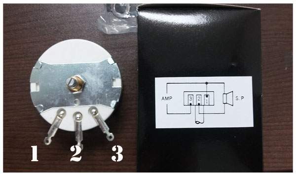

My speakers are bi-wire able.
Upper section consists 2 midrange drivers and tweeter.
Bottom section just bass driver.
I would like the bass driver to be more flexible in addition to whole speaker volume regulation from amplifier.
That means, while low level listening it can be fully engaged, when volume rises, I want to reduce its output to my liking. And I would like to do it on the way from speakers terminals of amplifier to the speaker post.
The best one volume pot for both right and left speakers. Is that possible?

It is not normal to control bass speaker volume with a 'pot', or more properly, an L-Pad because the power levels involved are so high, but this 100W L-Pad may just do the job if you don't listen at high levels.

Willys' blurb says the L-Pad's fine for guitar amps up to 70W. I'd be more conservative regarding the power it can handle from the bass frequencies in your Hi-Fi system. It's not too expensive if you want to experiment though - at least it may keep you warm during the cold winter nights to come!
The attachment shows how it is wired.
Thanks a lot for the link. That L pad is for one driver only right? I am not much DIY-er, but I guess I have to create some box. How should I connect the 3 pins there? And why not up to louder levels? Just what I have seen, the resistors in crossovers are usually 5-10-20 watts, this one is 100w. Sorry for my ignorance, just learning how it could be possible to solve this issue.
For one driver only and you've just missed my wiring diagram. Yes, house in a box.
Too much attenuation and the L-Pad will burn out as there's lots of power in the bass frequencies - about 80% of the power is in the bass.
Mids and tweeters consume only about 20% of the amplifier power. Rough figures, but they illustrate my point.

I can see your second post now, the connection is there, thank you �� The amp I am going to use is 150w/ 8Ohms. I am rarely listening to very high levels, if ever.
I have to caution you that yours may not be a good idea if you want lots of attenuation i.e. to turn loud bass down by a lot.
However, the price is low enough to allow for experimentation. Watch out for overheating of the control.
