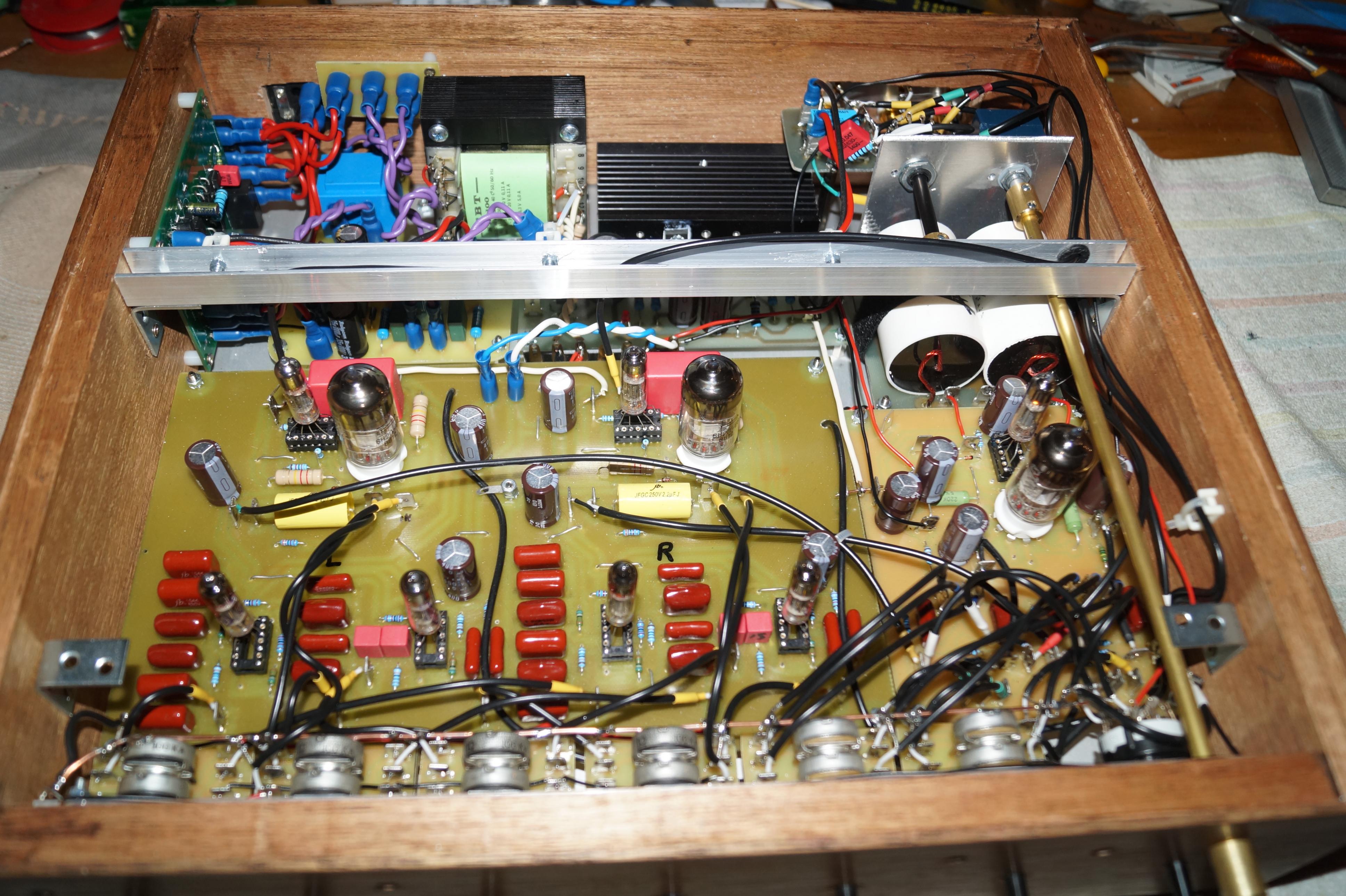

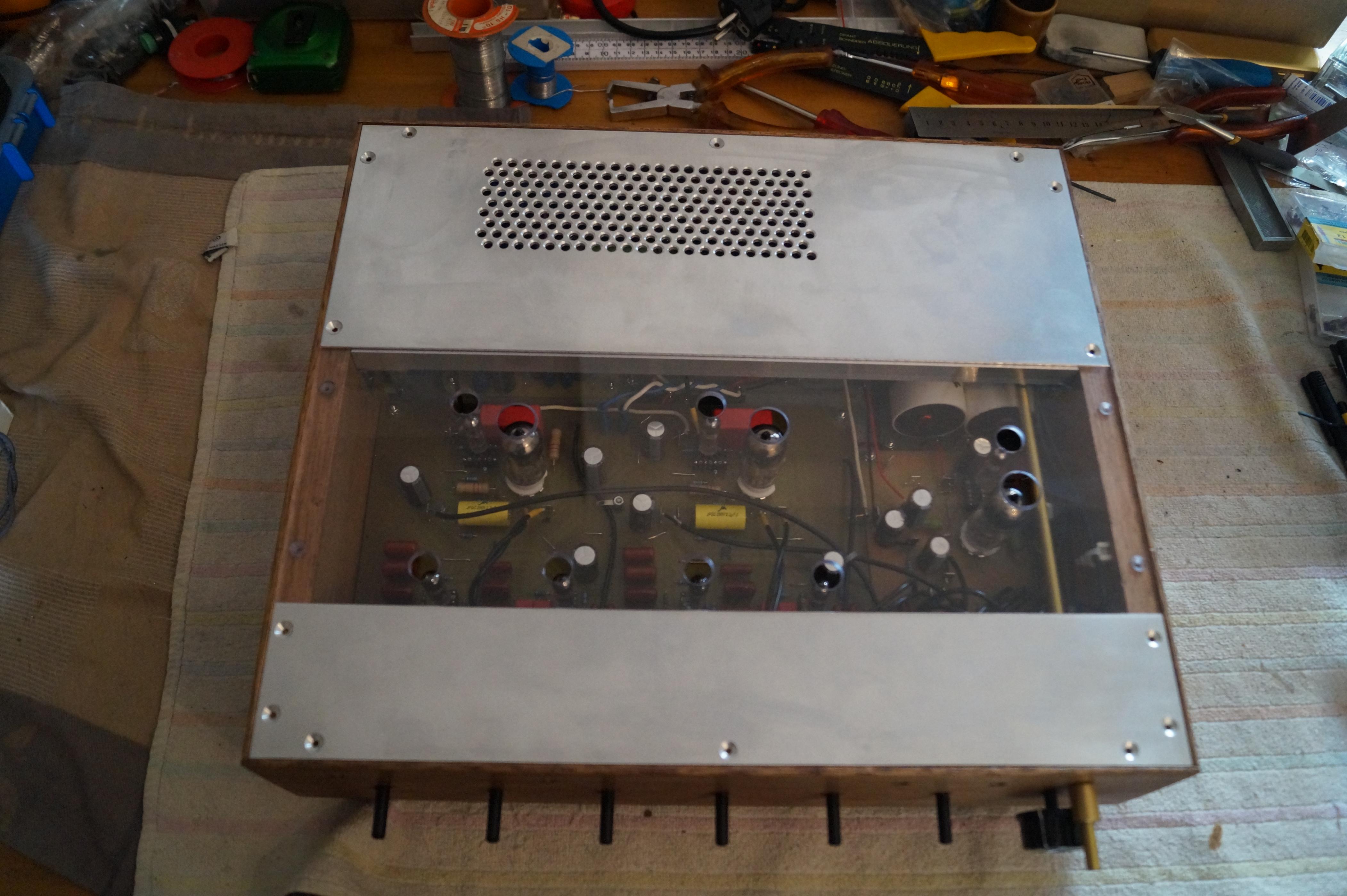

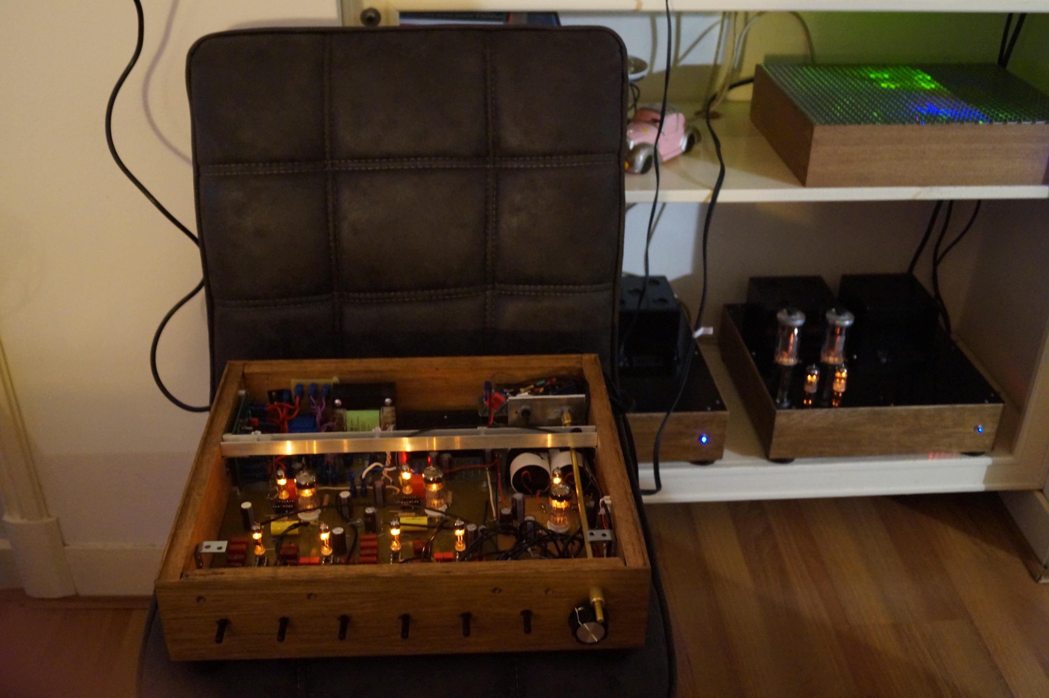

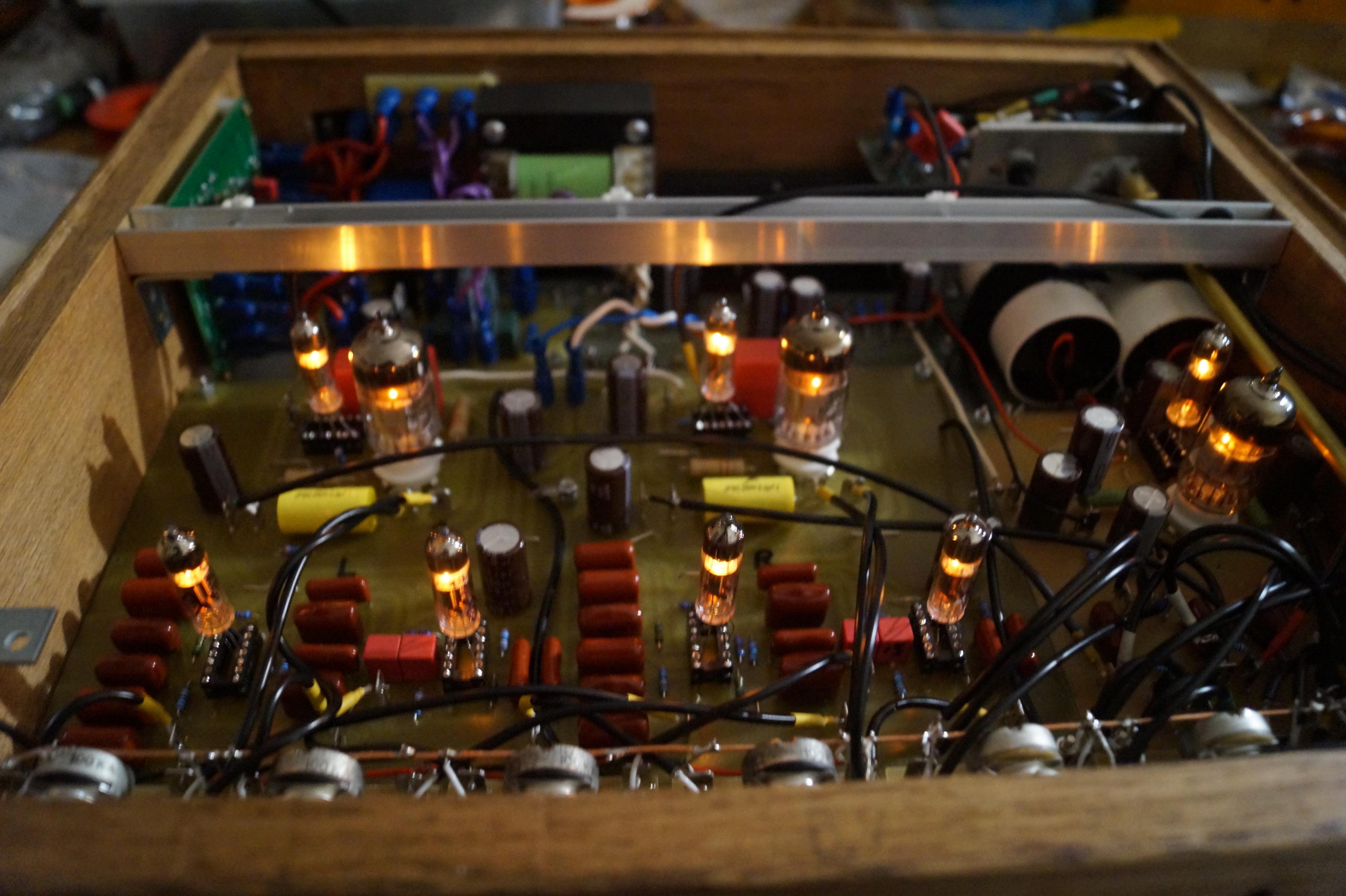

I have made a device that adds the feeling you miss with solid-state things.
It was meant to be,to correct sound fore 78 records after RIAA correction.
But it also did a great yob on dac,s between preamp .
Last year i made a proto for a friend, he is a DJ. After delivering i missed the sound so made a new one.
Now playing in.
It needs a week ore two to bloom.
I think it is the missing link.
Never going back
