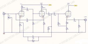

I see the R13 will be preamp output impedance not the inner resistance of output stage. It is usually 600R
If I use output transformer, the prim and second impedance will be what?
I have a pair of Lundahl LL9305 output transformer and it is 1+1:1.6+1.6, is it OK?
I would try them at 1+1:1.6 (parallel the secondary). Top of primary to the output capacitor, bottom of primary to ground. Ground the internal shield through a .01uF cap and add a switch to short that cap out to the preamp chassis ground (ground lift). Top of the parallel secondary to pin 2, bottom to pin 3, pin 1 to the shield. Gain and Zout will both go down a bit. You might need to play with the value of the output capacitor.
You might also take the opportunity to lower the 680 ohms cathode bias resistor. As is, it is choking the cathode follower. I would try something around 300 ohms. This will give it more output current (Iout).

The cheapest and easiest way to convert the output to balanced is to copy AN003 figure 2.4 A Simple Alternative.
This was adopted by B.Putzeys in his balanced volume control.
If you need to spend money, then you can adopt figure 2.2 using the output transformer. But note that "BEST" is adopting figure 2.3 to FIX the input stage.
And you don't need the FIX if the Receiver is already balanced and you adopt figure 2.4

Buy a pair of these and build them into a dedicated enclosure with RCA ins and XLR outs. No need to modify the pre,and if you don't like the result,you can easily sell them on later. Follow the included schematic.
