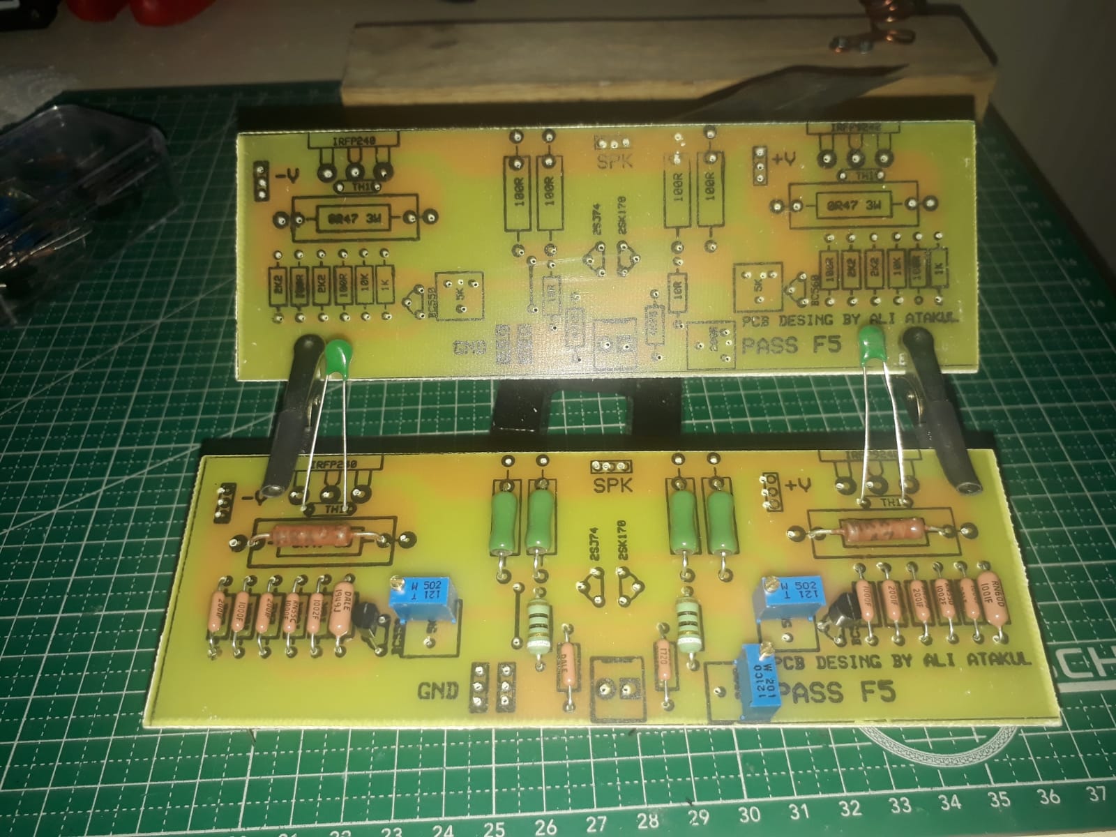

I've wanted to do it for a long time. Finally I was able to take the time and draw the boards.
Can you see a negative factor in the layout?
I haven't energized yet. If there is an error, let me correct it now.

I am not skilled enough to review for all errors. I admire your work to design the boards.
One thing though. With my own F5 using the schematics and boards from the DIYAudio store, the biasing process and the adjustment of P3 were very "touchy" even with 25 turn pots. I am not 100% sure, but yours look like they may be single turn. If you have the skills to design your boards, then this may not be any problem for you at all. However, just a friendly word to be careful when biasing and adjusting P3 if they are in-fact single turn pots. My hands are not that steady 🙂
