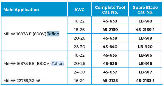

If you have a Stripmaster, there are blades for Teflon in their Military/Aerospace catalog: (One of my sons gave me a Stripmaster for Christmas decades ago!)

I used to work for a WHMA certified Military/Aerospace company and have dealt with the trouble of stripping teflon. Don't use flat or v-blades! We used "IDEAL" brand wire strippers, model: "Stripmaster", for stripping our teflon wire. Sometimes we would also heat up the head with a hot air gun first if we needed it. Ideally we would use a KOMAX/Schleuniger automated wire stripper with nick detection but those are several thousand dollars and understandably outside the range of non professional establishments.
