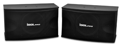

As far as subs, I have that damaged Yorkville and I have an Idol Pro powered sub
For "regular" cabinets (I won't call them full range since some are more mid/highs) I have the Idol IPS-550s that go with the Idol sub. If you're not familiar with that system it's an older karaoke/DJ setup that quite frankly was built for abuse instead of good sound. I have some JBL Control 28s (not high power and only an 8" woofer) and on the insane overkill side I have some 18" SP3Gs (not what I would call portable.)

Here is a picture and a like for the Idol full range
And the sub I can't find, but it's a single 10" (or maybe a 12"), reflex, 300w active. Model number is Sub-02
The Idol sub is currently my house sub at the black box. I suppose I could rebuild the Yorkville for the house and use the Idol for this project.

In the big scheme of things a 350w sub isn't very powerful these days and if the box is well build and fairly heavy there won't be a lot of vibration escaping. What effect the vibrations have on the mixer is a but unknown, electronics can and do survive being in the same box as a sub but an old analog mixer may not make out as well. There are ways to isolate the two though, the sub could be built in it's own enclosure and placed inside the bottom of the rack on some dense foam for example.If I build the sub as part of the case, how awful will the vibes be on the mixer? Am I asking for trouble with a massive magnet and 350w bouncing around that close by?
As long as you are realistic about the expectations for the speakers this can work, I doubt those idol speakers will get very loud so this won't be mistaken for a live band PA by any stretch, but it should suffice for some spoken word or light accoustic performances.
The Peavey SP3G(if that is what you have) are on another level, they can certainly get quite loud but require some EQ and don't produce much lowend despite thier size, so they could be useful for louder events if paired with some powerful 18" subs.
The SP3Gs will eventually go on the proscenium as house PA once the renovation is completed. I've already played with them excessively because I'm evidently 12. They're a fun toy.
The Idols will take a clean 400w without much complaining. They're built for loud and ugly DJ/Karaoke. More than enough output (sensitivity is a respectable-ish 92db) for vocals during a sitzprobe or in a larger venue where just a few people are talking. They start getting a little awful above about 7000hz, but that can be attenuated easily. You're correct that they aren't wonderful things, but they can be EQ'd to make decent sound for my needs.
