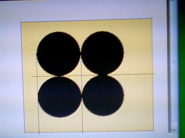

oik well everyone kinda jumping around on this mainly because they don't know what I intend for and amp.
For arguments sake let's say I'm using 4 speakers with a sensitivity of 93db. They are beside each other like I originally pictured.
The speakers are powered by 2 equal amps. An amp for the bottom pair and an amp for the top pair.
Each pair of 8ohm speakers are wired in parallel to give an impedance of 4ohm.
right?
Sp let's say each is putting out 1 watt/2.83 volts @ 8 ohm which translates to each speaker getting 1 watt. to each speaker right?
So saying that's the case what would the sensitivity of all the speakers total be?

If you are starting out with a 93dB/watt driver, then with 4 hooked up the way you want, you be getting about ~102dB with 4 watts. That's 2 watts from one amp, 2 from the other.
That's only 3dB more than you'd get running 4 watts (higher voltage) into a single driver, but all that cone surface will probably have more impact, and 4 drivers will handle a lot more power, when you really get it cranking.
You'd do well to use one amp for one side, another amp for the other side. Put the amps right behind the speakers. Using one amp per set of 4 drivers will give you a lot more punch than a single amp for both sides.
It will get crazy loud, no worries. 8x18 is a big PA rig, don't fool yourself.

Don't know if Mr. P is planning 4x18s total or 4x18s per side.
But with those $60 drivers, at least they won't be too stressed. Might be a good idea. Can move lots of air without taxing the cheap drivers too much.
If he just wants a Wall O' Bass, then 4 in the middle like his drawing could be cool. Then he could put his 12" "satellites" on left and right.
