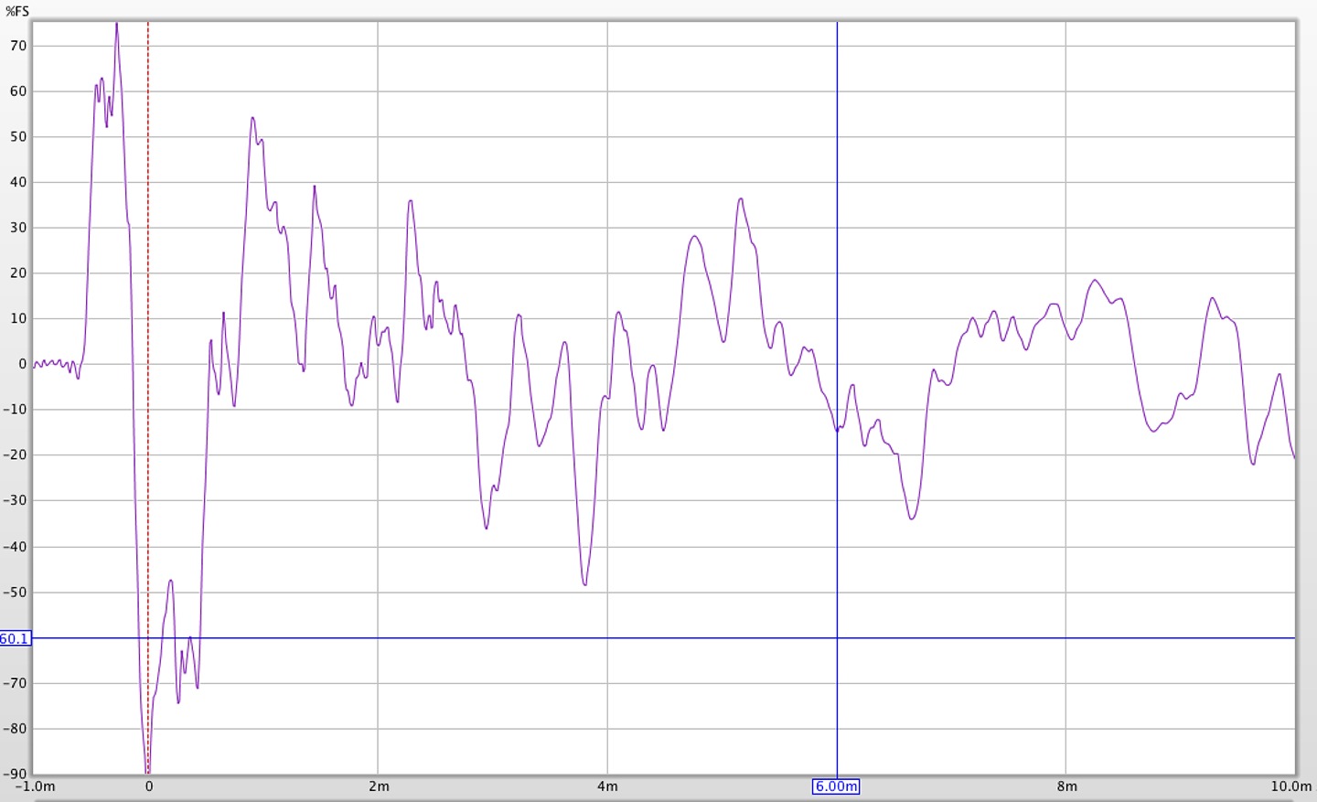

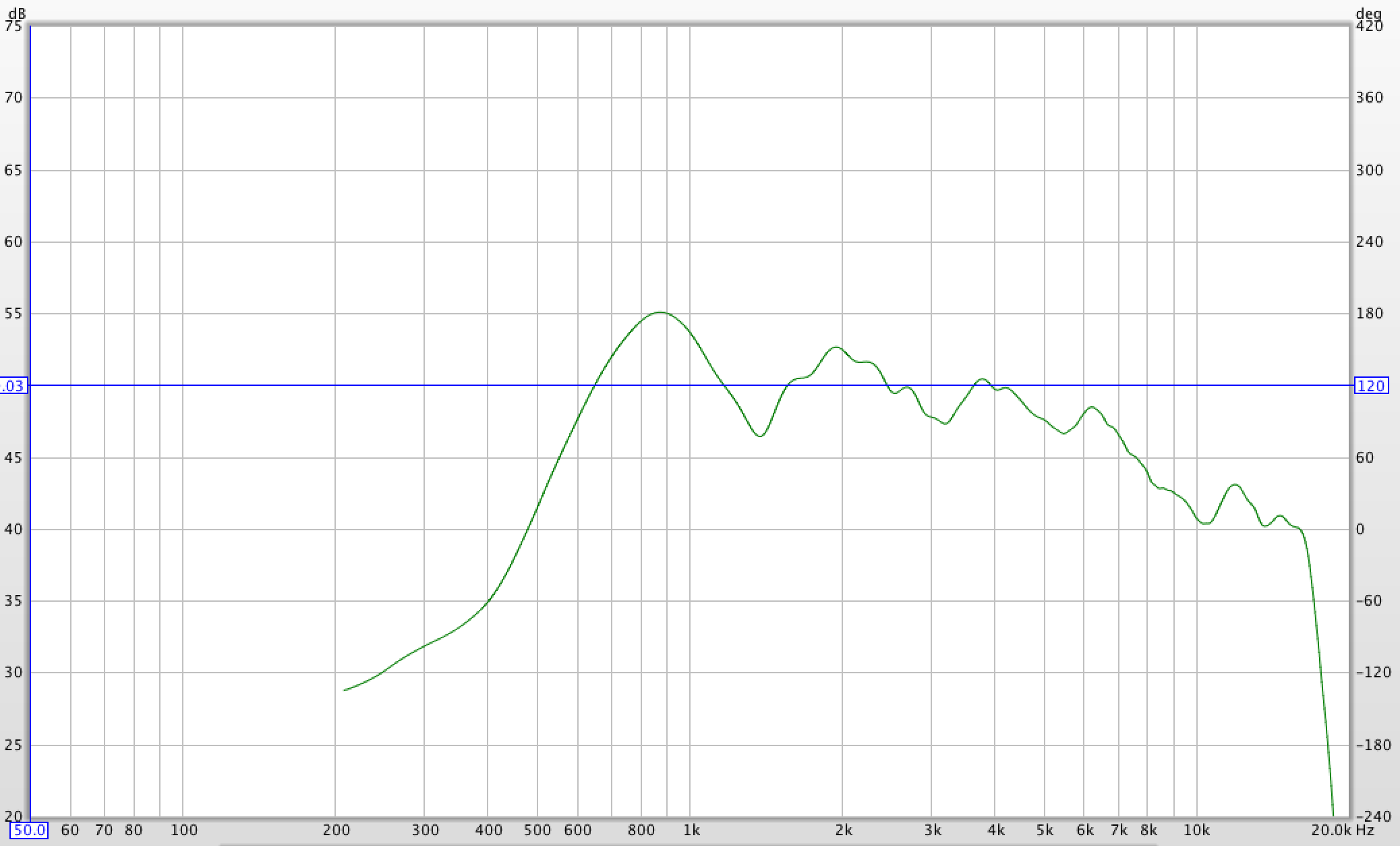

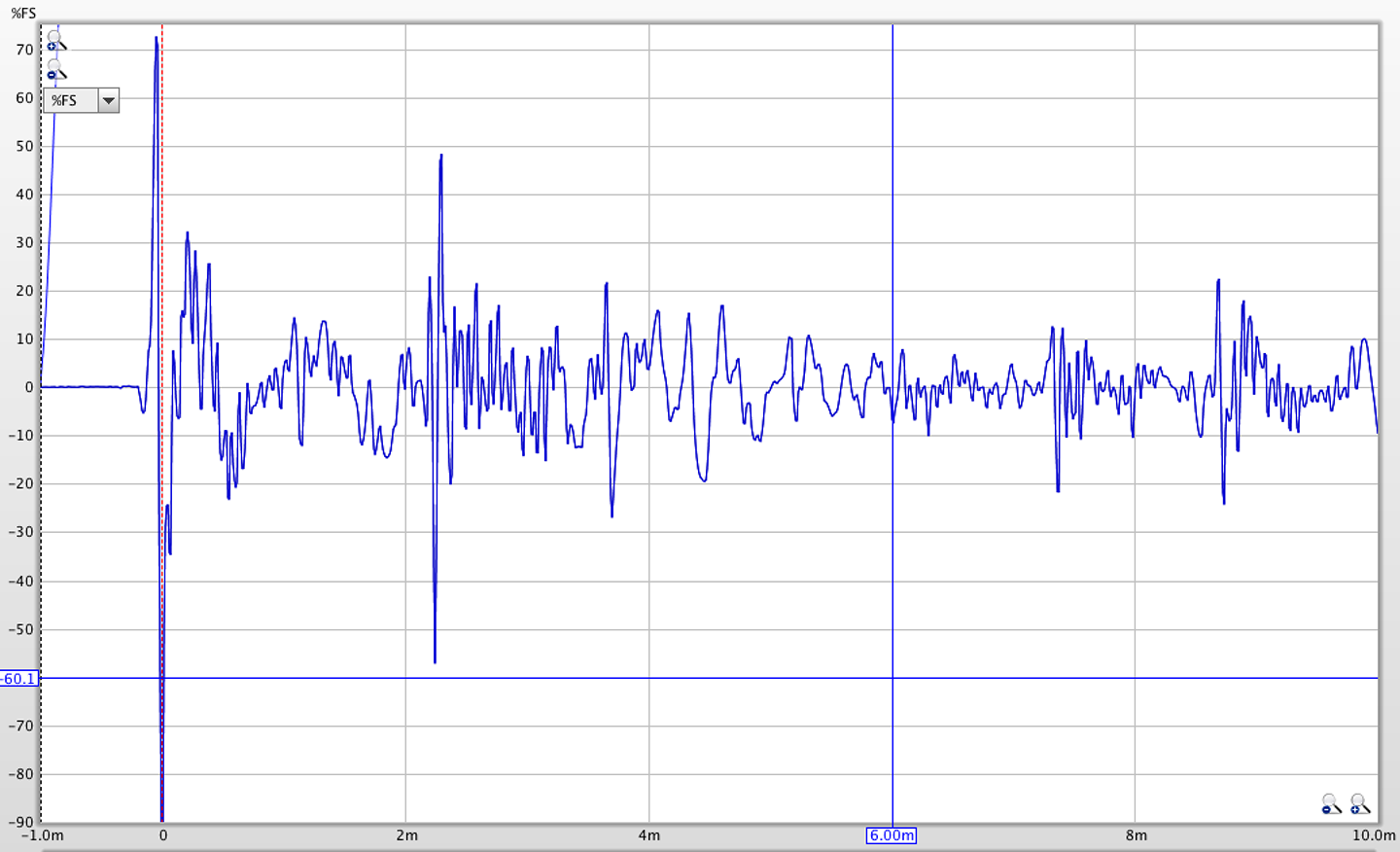

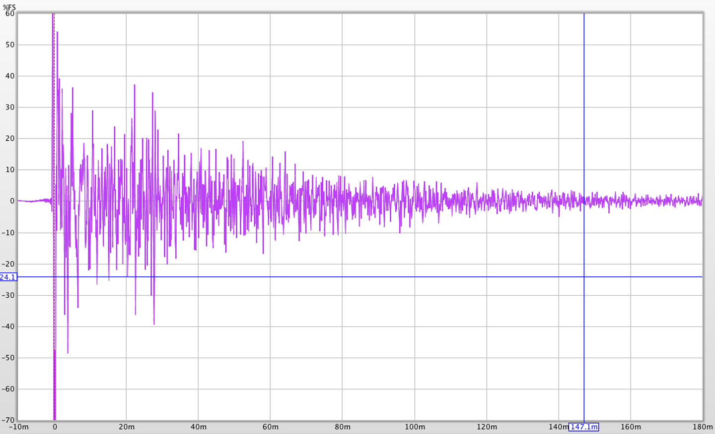

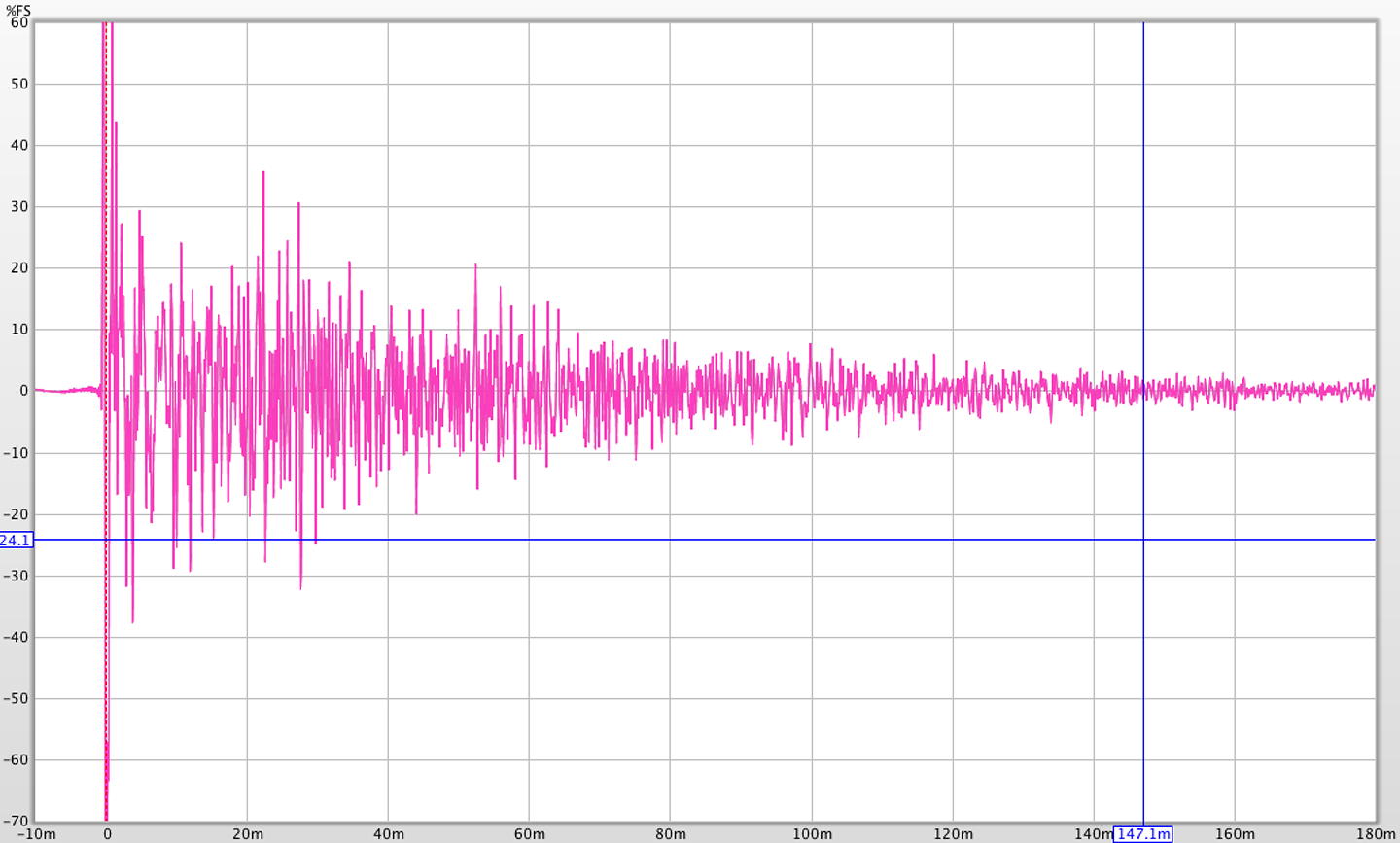

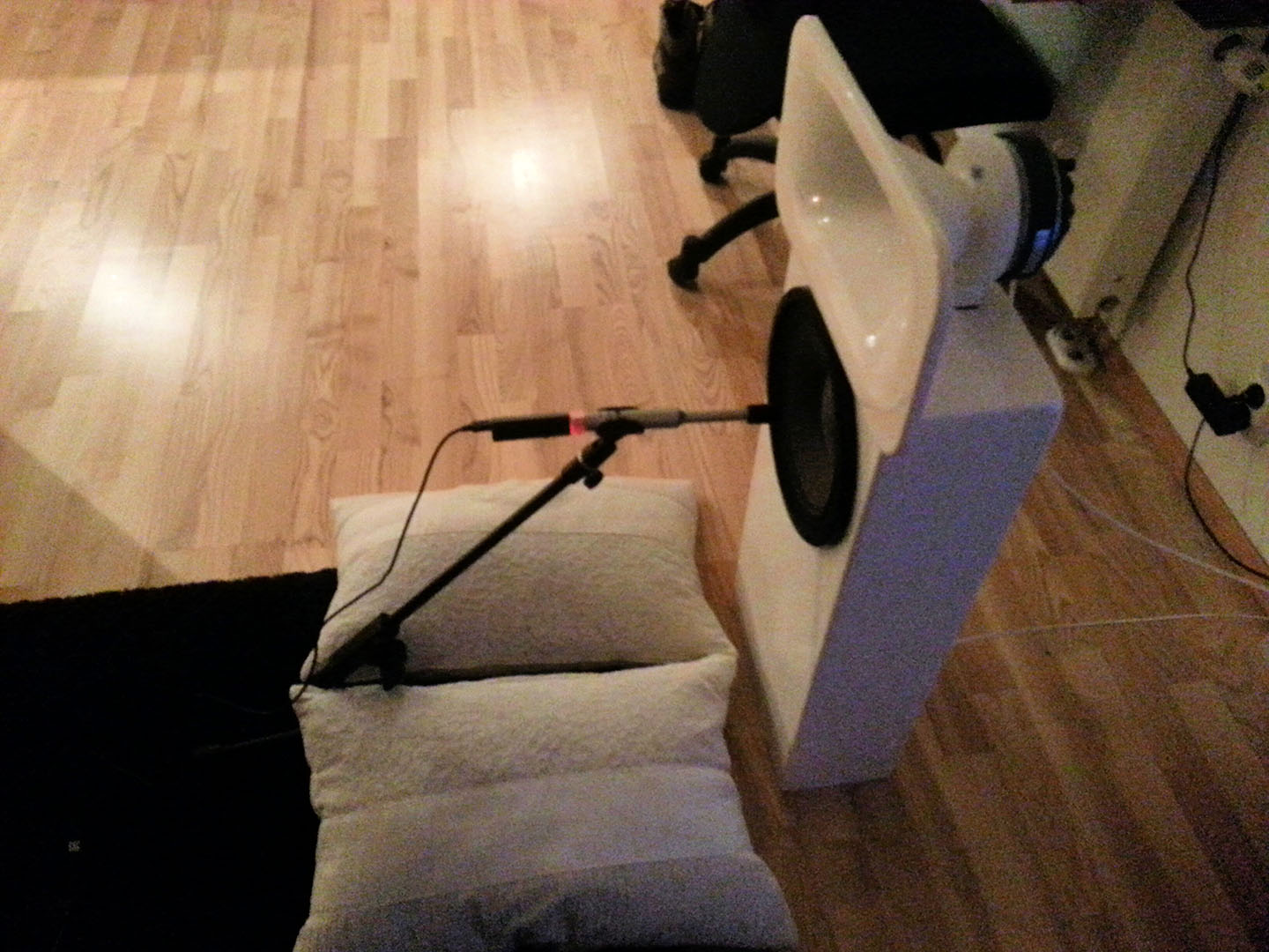

Here are the impulse responses HF, LF farfield, and LF nearfield. Any suggestions on what gate I should set for each one? (no gate on the LF nearfield I presume though).
Do you have some means of zooming in on the early part of the impulse? Most of what you are showing is the reverberation of the room long after the direct sound. You will probably want to gate around 5ms after the first sound arrival. As you expand the impulse you will see the decaying initial impulse and then the first reflection arrival. Gate just prior to the first reflection arrival.
Judging from your layout the arrival time before the floor bounce will not bee too great and it is unlikely that you will get an accurate low frequency curve. You still should be able to see the upper range of the woofer and the full range of the horn, both free from room effect.
David S.
Indoors, I have never zoomed out of the impulse response graph to show more than 2 meters. You generally have boundary reflections within a few meters, or milliseconds (don't need more than 10 ms, that is for sure!).
So zoom in to at least 1 or 2 meters, or less than 10 ms.
Generally, I can see the actual impulse wavelengths due to zooming in so far on the graph.
With how far out you are zoomed, it's hard to see the first reflections...
I had better luck raising the speaker off the floor so the CTC of the tweeter and woofer is about midway between ceiling and floor and as far away from 2 walls as possible.
I had 10 foot ceilings in one room, and the two closest walls were 10 feet as well. I got deep in the midrange with the CTC being 4.5 feet off the ground with no reflections from walls closer than that. The ceiling fan did cause a tiny blip that I was not happy about, but did not change the FR much at all. Not enough to matter for making a crossover.
I lucked out and had an empty room at my disposal for a while.
That was nice.
I did some measurements in the bedroom with the speaker on the bed, and I got pretty much the same results. So, the gating works nicely. I set small speakers with their back on the bed, on the far edge of bed away from wall. That worked well.
I put pillows and whatnot on the floor, and it did not help the bass or lower midrange at all.
I tried lots of things. You just can't be near a floor or wall. Pillows only do so much.
I think they might help in the crossover range for most tweeters, though. That is all you really need anyways. But, concentrate on getting the speaker as far away from boundaries as possible.

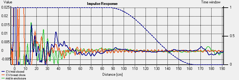

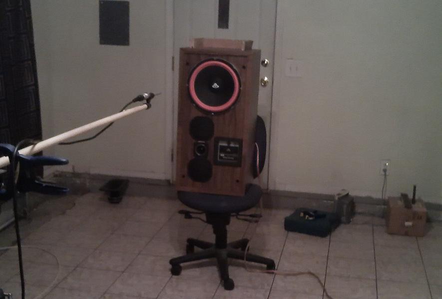

Here is an example of where I set gate on this speaker.
Holmimpulse.
You can see a tiny bump at 145 CM.
The major first reflection is at 170.
When you move the gate, you will see it will effect the bass response the most when you are in the shorter time domain, or closer distance, until you get deep into the farther distances and then the reflections will start messing with the highs.
I usually try to look at the impulse to find the first reflection, then move the gate around that area to see how the highs are affected. I try to get the frequency as low as possible without effecting the highs. It usually always ends up being as recommended. Just before the first reflection...
Keep in mind that the louder you play the signal, the higher the peaks on the impulse, making it easier to read. I keep the signal to the recommended -2db on holm. On every measurement. I always check.
I heard the recommendation that you don't want to "tape measure" anything, as far as what is around your speaker. Just keep everything away in the room, if you can.
I showed you the graph to give you a visual representation of what others have recommended. Look at the response itself to set the gate. Don't measure your surroundings. Don't waste your time pulling out the tape measure. Your eyes can tell you "hey, the speaker is high off the floor, away from the ceiling and walls". Good enough
The speaker I really wanted to measure is a big fat pig. I hate moving it. And the waveguide sits on top all loose.
So I used some tiny satellites to learn how to set everything up and learn holmimpulse. I recommend having a small test mule small speaker to practice with.
That way you can try different measuring techniques (distance of microphone and placement of speaker in particular area) and see what the changes are.
Heck you can use a loose driver or just a clock radio. Whatever is easier.

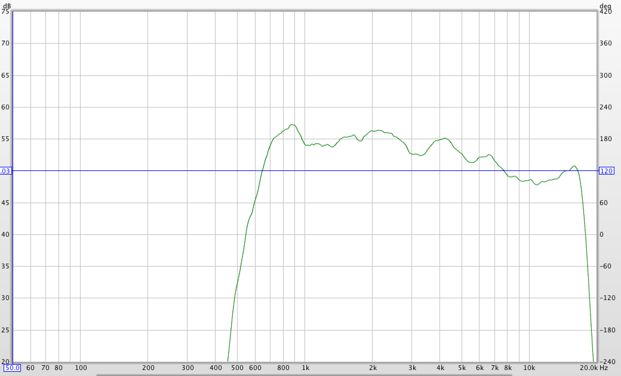

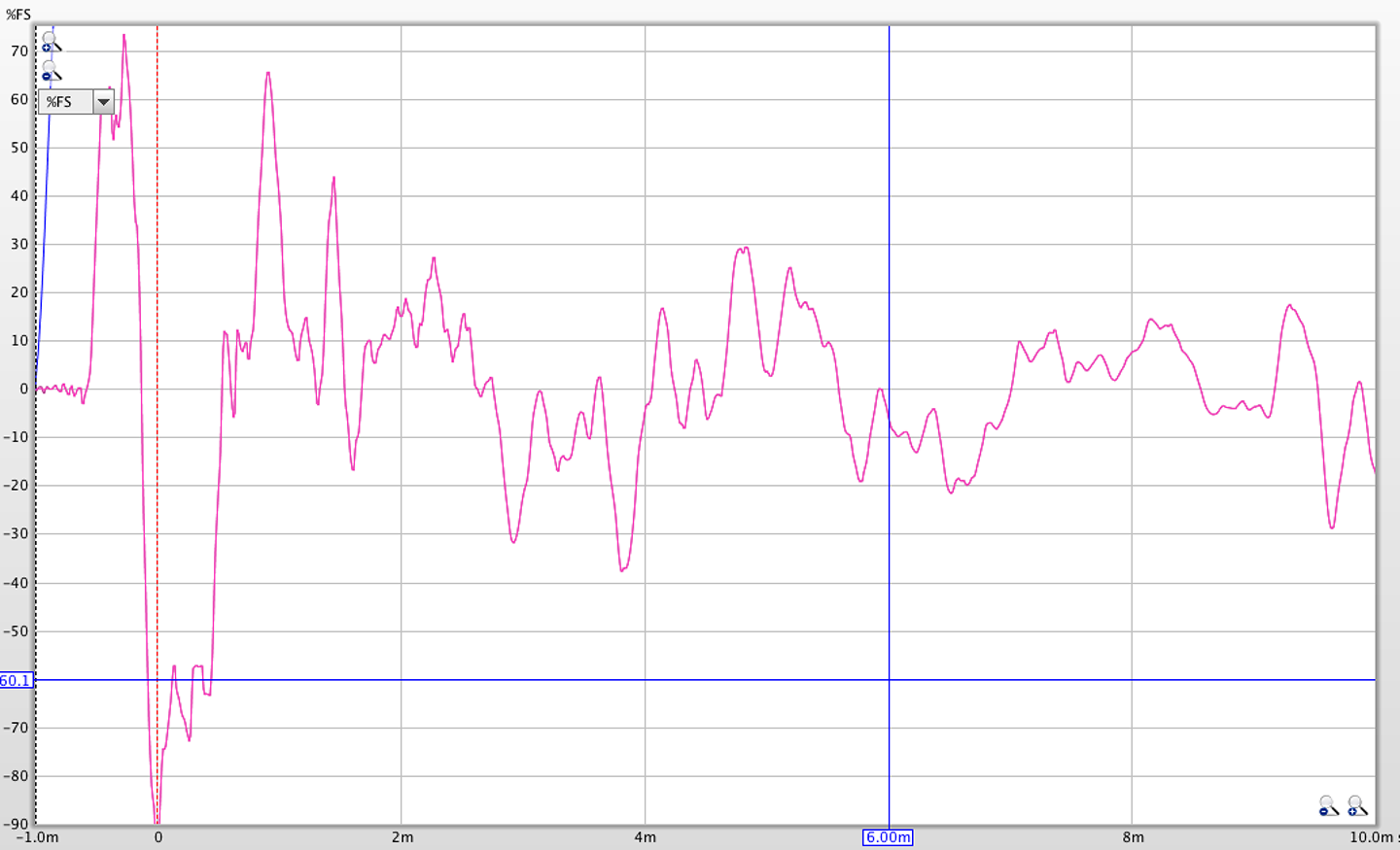

Here are the measurements zoomed into a 10 ms window. What I'm suprised of, is that the farfield and nearfield impulse response of the woofer is nearly the same...
I will try to raise the speaker, add more pillows, and raise the gain, and see how that changes the measurements.

Looks like there is your first big reflection just after 2m.
I would look into measuring the acoustic centers as they don't always match the voicecoil center... Then you know you are perfect.
Should the placement of the mic be on axis with the tweeter?
Or so that the length from each drivers acoustic center, to the microphone is equal?
I reckon the latter will be more correct for the midrange area, which is the area of interest here (1600 hz XO).
Yes to first one, as that is how you are going to listen to it. On axis with tweeter.
Also, when I put the measurements in PCD, I don't have to enter the acoustic offset, as I measure it at 0 and can enter the listening (and mic) distance along with driver vertical alignment. It will sim different listening distances.
You don't listen to the woofer on axis, so why measure it on axis?
But I am new to this, so others will chime in, I am sure.
You are going active, so you need to know how to measure the acoustic offset.
I think it's better to measure farther away (actual listening position) as the two drivers become more aligned as they get farther away. No one listens to most floor standing speakers from 3 feet away (especially a big waveguide or horn). Small nearfield mixing monitors are different, obviously.

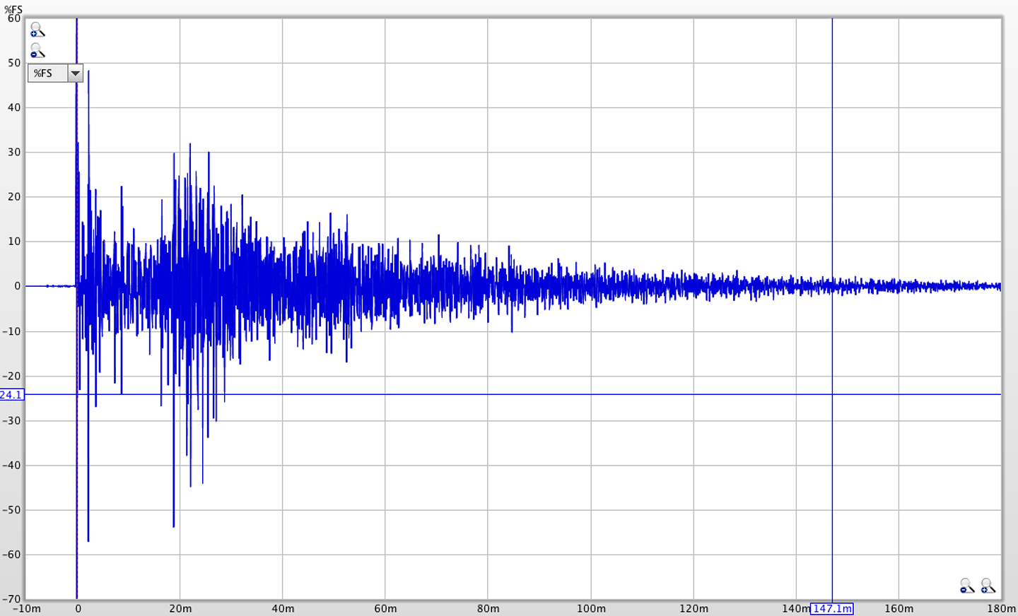

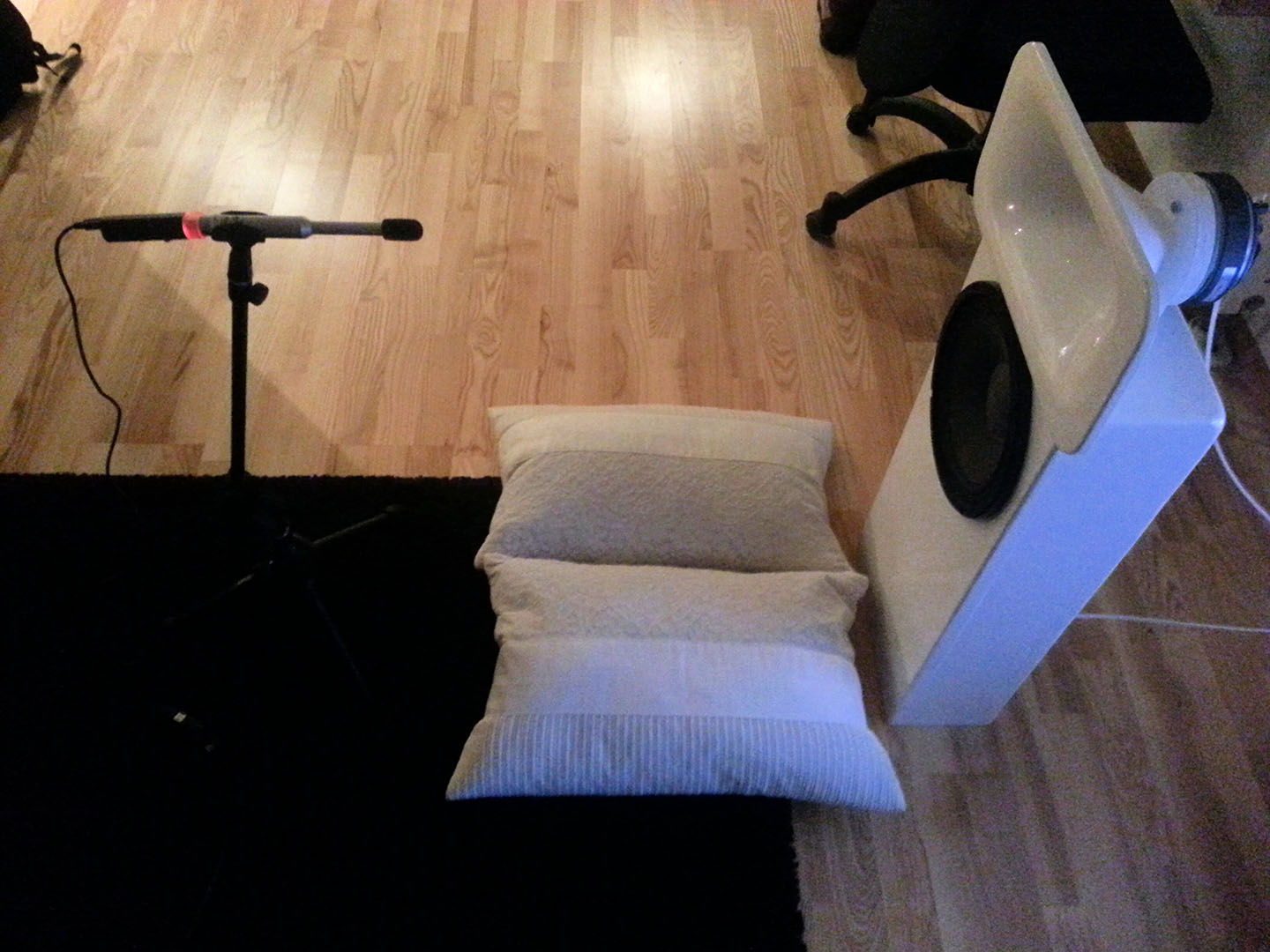

Made some new measurements with elevated gain, longer distance (1m), and experimented with and without pillows. I get the smoothest impulse response using pillows, so I stuck with that.
I've set the gate to 3.8m, just before the reflection on the impulse response.
What boggles me, is that the response is so much nicer without a gate... Makes it hard to trust the results I get with the gate set to 3.8m...
