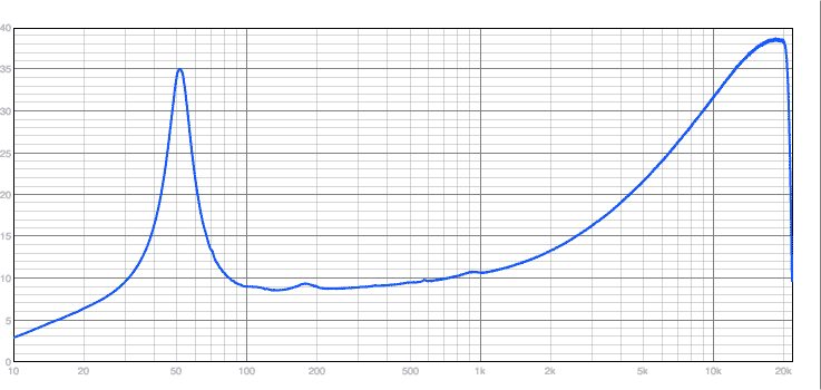

Perhaps the dreaded quarter-wave resonances don't occur because the drivers free air resonance is too low for it, by this logic they may occur below Fs, not a problem with sanely sized cabinets, except maybe large midrange cabinets, keen for round 3 with a longer tube and high Fs driver?
Do you suppose those superimposed ripples were cone breakup?
I don't see how the fs of the driver would change whether a quarter-wave resonance existed or not.
The ripples are most likely from assorted reflections inside the tube. Cone breakup was evident above 1.5kz, which is why I stopped the graph there.

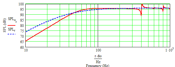

Applying the 1/3 octave smoothing filter in REW gives a clearer result......
The red line is the same as in the previous graph, ie the internal resonances for a 500mm spacing.
The blue line is whats measured outside the box, 100mm from the cone.
Again, no quarter-wave resonance is seen.
Cheers for the outer-box specs, you can really see that the pressure maxima near to the driver really does hold it back/drive it. Lucky we can damp these things at the velocity maxima. Those ripples were probably caused by the diaphragm being a cone rather than a plane eh?

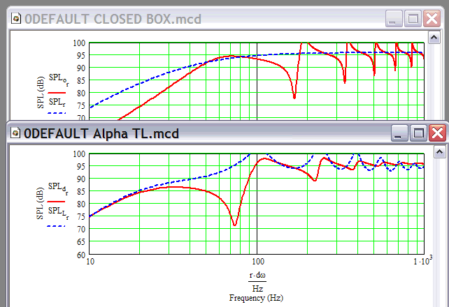

I was thinking that a wave would be reflected by the driver if it's Fs was too low for it to be displaced. By reflecting it, only a half wave resonance is reinforced.
If the length of the tube was such that the quarter wave resonance was Fs, maybe a quarter wave would be reinforced, and leave the cabinet through the diaphragm. Ok in theory?
OK, I just had remembered seeing the thread and noticed it hadn't been very active, so wondered if it was still on your 'radar'.
The other thread is interesting, but again, a sealed cab is like a room, all reflections, so just like a room it only has 1/2 WL resonances as long as all windows, doors are sealed airtight, otherwise there are Helmholtz resonances to consider, ditto air leaks in a sealed cab.
