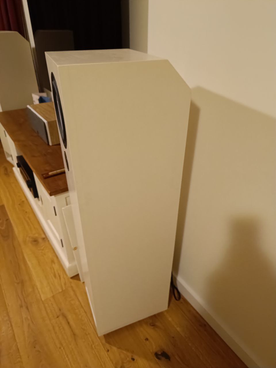

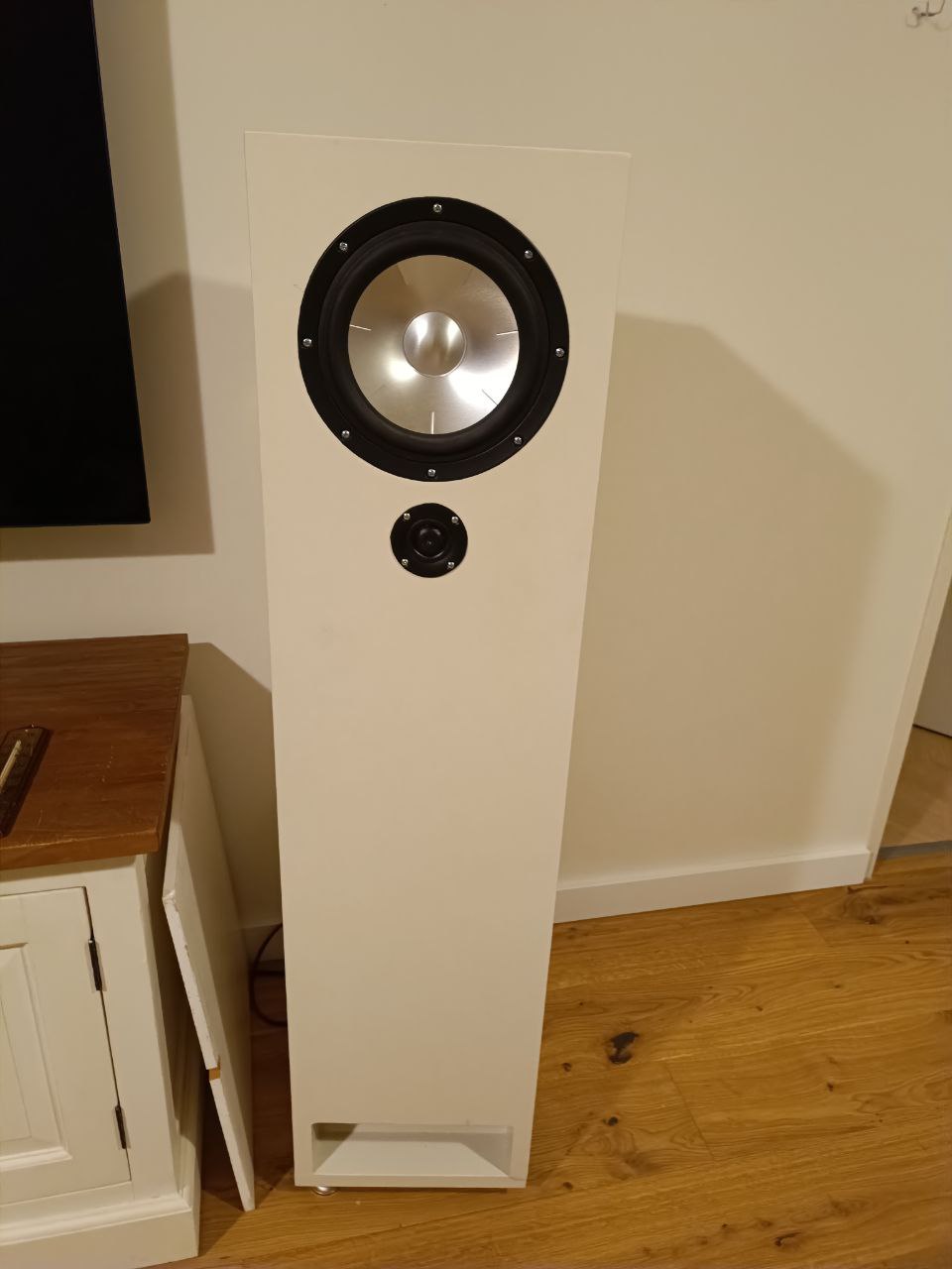

About 10 years ago I build my first (and so far only) speakerset. Being the ambitious uni-kid that I was, I thought building a transmission line speaker was a great idea.
I was inspired by the fantastic sound of the Impulse 54 speakers and didn't even really consider any other type of enclosure.
With sufficient EQ, they don't sound terrible, but given the time, effort and money spend on them, I hope I can safe someone else's project.

I was fully focused on the T-line design. I did not even look what the response would be for this driver in a ported or sealed enclosure. (It turns out this driver in a ported enclosure that is 20% smaller than this enclosure would be able to play significantly lower than this design. And it would also have been a lot easier to build)

Not knowing what baffle step is.
Due to this, I will really not be able to make these speakers sound good without EQ. It is fortunatly a relatively smooth function that can be resolved well with EQ, but some tweaks to the design could have significantly increased accuracy without EQ. (it is about 5dB louder at 1kHz than at 100Hz)

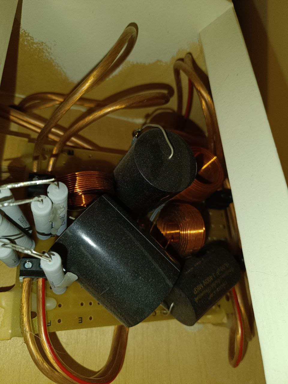

Get high quality components
So there is of course a limit to what "high quality" means. But I spend so much time and effort on the speakers, I'm glad I didn't safe a few euro's on the binding posts, the screw or the paint. It also means that now I am motivated to improve these speakers as (in my opinion) they look great and with all the components there is the potential for more.
