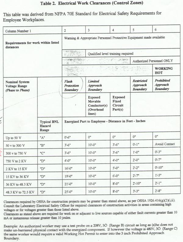

Here's the guidelines I teach...
Here, only up to "C is allowed..nobody I teach is qualified for range "D".
Important notes: High voltage hazard C is a supply over 300 volts and under 750 that can deliver in excess of TEN milliamps..which is defined loosly as fatal.
Ten milliamps can be delivered by a car battery, if the skin is sufficiently wet. The current through the body is entirely derived from the skin resistance and the supply voltage. How the current travels through the body determines if it is fatal or not..
Ten joules of stored energy is also considered a hazard, specified as :
Estored=1/2CV2
or
Estored=1/2LI2
Cheers, John
Estored=1/2CV2
or
Estored=1/2LI2
Cheers, John
