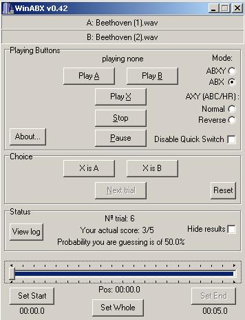

use one of the abx testers instead of just listening. Trying to sit and listen and find the difference is going to be too unreliable. I too "thought" I heard a difference, but then after repeated attempts at abx comparisons, I never did better than chance. I didn't do so on the best of reference listening setups, and will try again later in a room with less ambient noise and when I'm not so tired, but as I said, I didn't do better than chance.
It's also not all that hard to cheat on the ABX by making slight adjustments. I had never used software abx like the ones suggested, but the Foobar is the one I did best with (could have just been practice too). Anyway, you could fudge it by putting different wav files into each part, so different that they are easy to tell. You could insert a boost, a delay, etc. to all ensure the difference. I also did better with the short pieces than the long pieces, for whatever reason.
Yes, you're right, in WinABX 'play A' plays the sample that you loaded first and 'play B' plays the sample that you loaded second. Then try 'play X' and determine if it is A or B. After choosing A or B click 'next trial' and you see whether you were correct or not. Then you can listen again to sample A and/or B or directly listen to X again. You can also first listen to X, then to A and/or B, choose then, or first listen again to X, do what you want. X remains the same during a trial until you choose and go to the next trial.pjpoes said:let's make sure I used the abc/hr comparison utility right. So I load the waves into the setup, in doing this, the original can be either 1 or 2, and then I can load 1 and 2 into the later wave area's respectively? Then for setting up the abx, there is no reason to choose original, correct, A and B should be sample 1 and 2 respectively.
In all ABX testing that I did myself during the past years, I preferred short samples, but this could be different for other people. I use ABX-testing to find out if I can hear a difference. This is the first thing to do. If you cannot hear a difference, it makes no sense to find out which sample sounds better to you in my opinion.

Ok I've now run 3 people through a total of 15 experiments with 10 trials each. Two other people tried 3 different headphone combinations (so 6 "experimental situations") and then I made up the bulk of the rest of them. I did the best of anyone thus far, getting 7 out of 10 right. When I tried 20 trials the number became 16 out of 20. While I got more than half right, it's still statistically too low. I have a friend coming over today who will try as well, and I'm sending the necessary files to my brother to give it an attempt, but I doubt he will have the patience to do it right.
Peter, either you have much better hearing than all of us, or there is something wrong with what I'm doing. Given that I've done these as part of my work, I'm pretty sure I'm executing the experiment correctly. Biggest problem I have is ensuring the sound quality is "clean" enough. I found something was wrong with my headphone amp so right now I have Shure headphones plugged into my pre/pro's headphone output. My laptop is connected digitally to the pre/pro, and the processor is run in "bypass" mode, so should be a relatively transparent signal path.
Anyone else take the time to do 10 or more trials with one of the mentioned ABX softwares do better than chance? Technically you will need a full 10 out of 10 to be statistically better than guessing, but I would take 9 out of 10 (If you get that, try again with 15 or 20 trials, and see if you can do better than a 5% chance of guessing).

yeah I also realized that I miscalculated the p values from my guesses, should have just looked at the program. I did better than chance in my 20 trials attempt. Looks like, while maybe not a perfect 10 out of 10, I managed to do so as well.
