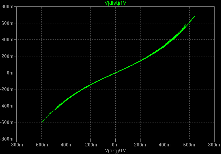

Scott, something seems to have gone wrong. I get a very neat xfer function, the typical (for electronics) expanding distortion(using LTspice's .WAV input).scott wurcer said:Last night I ran the two signals through "diffmaker" and the distortion looked more like harsh clipping than a smooth third order. I agree with the doctor, a simple out = in - A*in^3 where the peak distortion is 10% would not change the rms level much and I'd bet it was not very audible.
And that "10% 3rd" is very well audible in that sample (lot's of IM grunge). The question is, is it really 10% THD peak distortion of a full-scale sine, or did they actually mean the 0.1 factor in an x-fer like y=x+0.1x^3?

I guess you mean me. I will not say that the transfer characteristic I plotted is that of a pure 3rd-order polynom x+ax^3, although it looks pretty much like that. More analysis is in order to confirm that.jeroen_d said:Ok, I didn't check if it is pure 3rd harmonic. I will ask a friend who is able to do that. The previous poster confirmed that it is indeed 3rd order, so who do we have to believe? Will have to check out myself I guess.
However (and that's a big "however"), the order of a polynom has no correlation with what harmonics will be generated, I hope everyone is aware of that. It's just pure luck that the expansion of sin(x)^3 is (3sin(x)-sin(3x))/4, which has only the fundamental and 3rd harmonic in it. Similar with 2nd order polynoms, but above 3rd order the expansions gets more complex, e.g. sin(x)^4 gives the fundamental, 2nd and 4th harmonic.

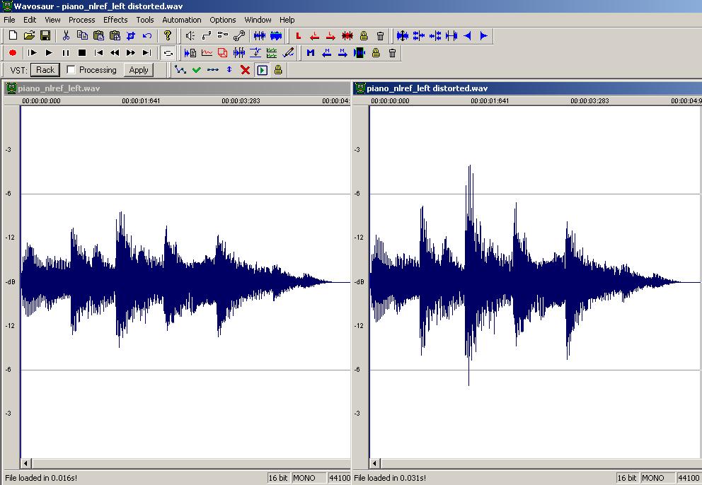

With the program AddDistortion v2.1 I have made some files by myself. I added 25% 3rd harmonic to the piano piece. First I processed this file to make it mono and then attenuated it 4dB to prevent clipping when adding distortion. It is nice that AddDistortion gives a warning if that happens.
I was surprised that the resulting file still sounded like music. If I added the 3rd harmonic without first attenuating the file, I got an audible result just like the sample provided by the PCABX website. Nonetheless, 25% is easily audible. 10% 3rd order, processed on an attenuated file, is not so easy to detect but it can be done.
So, I have more understanding now for the claims made by Earl, however, 50% 3rd order not being audible is a statement of which I cannot find prove, to put it mildly....
Here are the files:
http://home.kabelfoon.nl/~dezaire/piano_nlref_left.wav
http://home.kabelfoon.nl/~dezaire/piano_nlref_left distorted.wav
In the picture you see the wav before and after processing.
Here are the files:

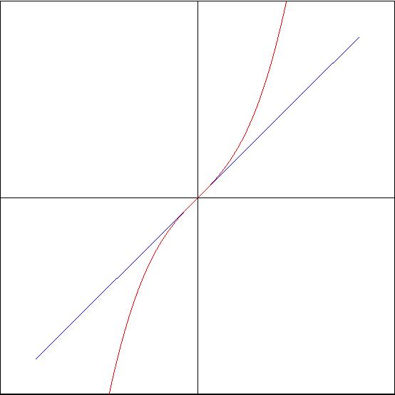

Here you can see the transfer function of the 25% 3rd order distortion as provided by AddDistortion v1.2. Now it is explained that, as long as the volume of the piano is low, the distortion is non-existent. Therefore 25% 3rd order harmonic distortion is meaningless if you want to make comparisons unless the full dynamic range is used.
To conclude, although Earl makes bold statements, I have to agree that distortion numbers as being provided by modern drivers are an insignificant factor in achieving good audio quality. In any case, as long as the higher order harmonics are low in level which is true for most of the drivers.
KSTR said:Scott, something seems to have gone wrong. I get a very neat xfer function, the typical (for electronics) expanding distortion(using LTspice's .WAV input).

jeroen_d said:Here you can see the transfer function of the 25% 3rd order distortion as provided by AddDistortion v1.2. Now it is explained that, as long as the volume of the piano is low, the distortion is non-existent. Therefore 25% 3rd order harmonic distortion is meaningless if you want to make comparisons unless the full dynamic range is used.
What kind of transfer characteristic would one expect for a real driver? I would expect a compression curve, instead of an expansion curve as you show.

The % THD from a transfer characteristic is indeed ambiguous because it depends on the level of the signal along the transfer characteristic. It also depends on the type of music with complex music being the most benign and piuano being an almost worst case because of its dynamics. So it is difficult to say that 50% is inaudble or that 10% is. What I said was that I could generate a 50% THD sample, but I would of course use benign music, not a piano.
The point that absolutely has to be stressed here is that no matter what number we throw arround its NOT 1% or 2% that is audible for low orders of nonlinearity. And lets remember that this is all playback level dependent because masking goes up with level.
Bottom line here is that it is impossible to say anything based on THD level and that is really the point. Its just not a reliable metric of perception and all the discussion here points out why that is.
