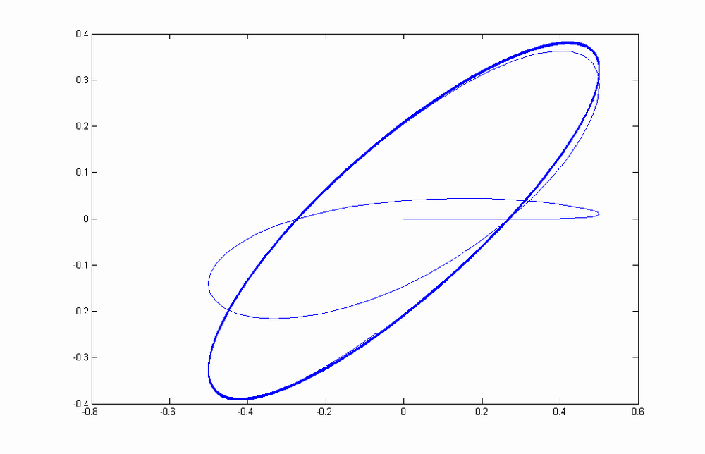

Intrigued by the I/O curve idea and seeing as I had a bad EMU 1616 which, for some undiagnosed reason, was putting out 1%THD, I thought I take a look at what could be done.
I started with a 1KHz sine generated in Adobe Audition, plotting output vs input I got the following plot:
I was really encouraged by this strange picture because it showed the latency in the system as a phase shift and the start-up artifacts showed up as wild deviations from an ideal lissajous figure.
