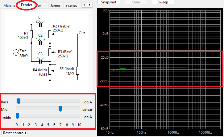

If you have a good tube amp, one that has the potential to sound good, here is how I find works pretty well to adjust the guitar and amp controls to get close to the sound you want.
Set guitar volume and tone controls to 5. Set amp tone controls to minimum. Adjust amp gain so you just start to get some breakup when playing two notes at once. Start increasing amp tone controls until you get a sound you like, but go for a midrange sound, not too much bass nor too much treble. Tweak amp gain as necessary to maintain breakup point at two strings at once moderately picked. Once amp is iteratively adjusted for breakup point and tone, then use the guitar volume and tone controls to fine tune the sound and breakup point.

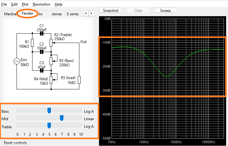

Re: setting controls...
I used to gig regularly with the following setup. That was something like 25 to 30 years ago. I've just started to hit jam sessions again, which is why I'm looking for a much lighter weight rig.
1. My guitar is a hollowbody Gibson, with a PAF-style neck pickup (pretty standard stuff). I have it strung with LaBella Medium flatwounds (livelier than D'Addario Chromes, GHS, etc.), gauges are .013 to .054 (very heavy by today's standards).
2. I set the guitar Tone control to about 7 or 8.
3. I set the guitar Volume control to 8 or so. That's going to be my 'as loud as it goes' setting.
4. I then go to the amp. With a stock Fender blackface tone stack, I set the Treble control to very close to 0. I set the Bass control to very close to 0. This gives as close to an electrically flat frequency response as possible. It does not have the scooped out mids of a standard Fender tone stack with its Bass and Treble controls set to 5. I don't like the mid-scoop, at least not from the preamp ('electrical EQ'). Here this is with the Bass and Treble controls just barely up, and the Mid control set to about 7, simulating the stock 6.8k R4 in the tone stack. Notice that the frequency response is close to flat.
In the stock Fender blackface tone stack, setting the Bass and Treble controls to 5 (with the Mid set to 7 as above) results in a lot of Bass and Treble boost (at 30 Hz and 5k Hz respectively) leaving a large midrange 'suckout' at about 500 Hz.
That's fine, but that's not the sound I want to hear. Too 'jangly' and 'Fender-y'. Sometimes I'd need a bit of extra Treble for louder groups, organ trios, etc.
4. I typically set the Volume control to only about 3 or 4. Maybe as high as 5. Anything more and I'd get too much grit and breakup, especially on full chords.
5. I never touched the amp's controls after that, except to make fine adjustments (which I typically wouldn't need to do).
