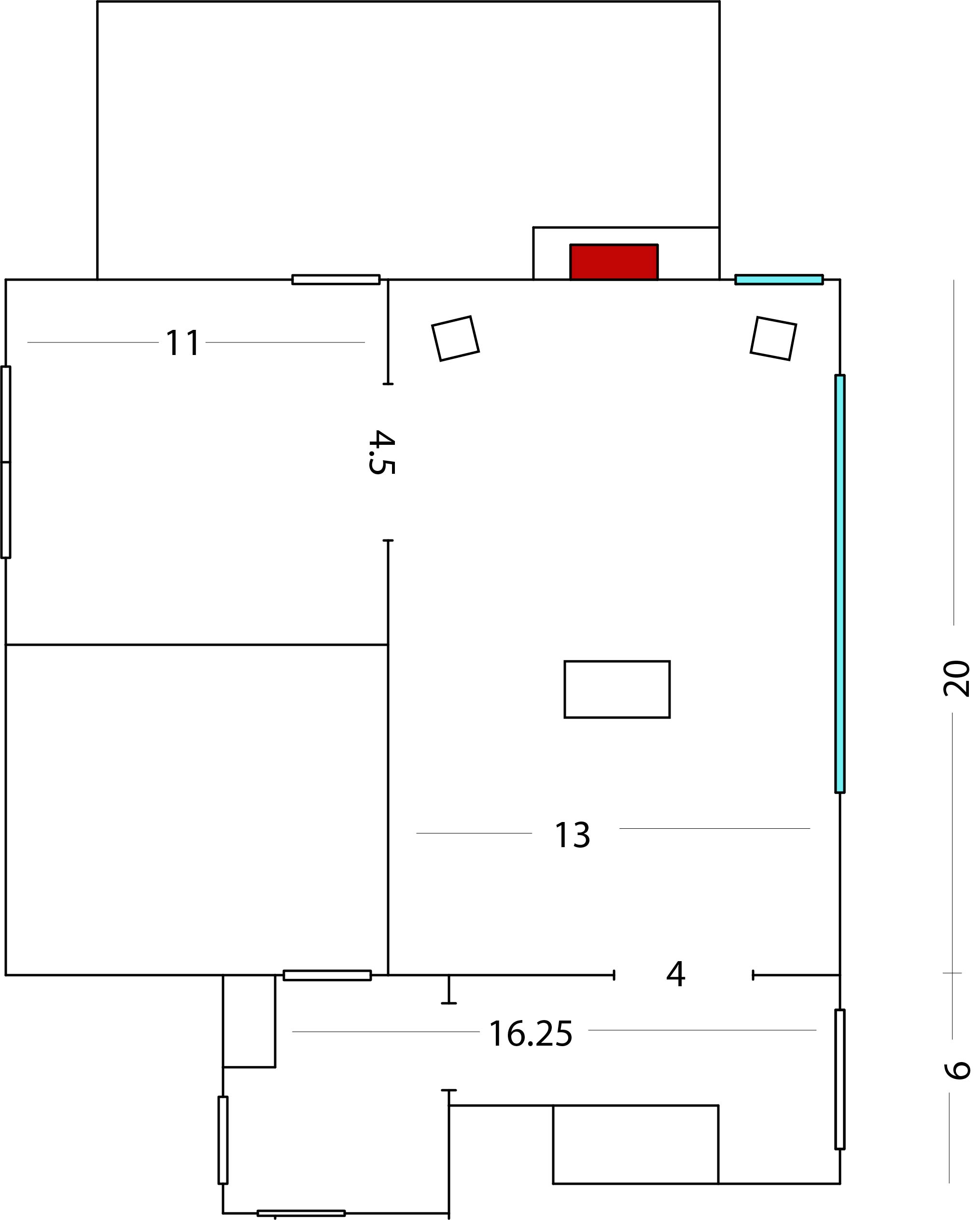

Attached is an approximate floor plan. the room is bigger than I thought. how does this work with the room gain? 2x the longest distance is the frequency where it starts? so if we're just counting this room at 20', I'm looking at room gain from about 28Hz? but if we count the room to the left, it's 24' x 2, and 23Hz, but to the back I have the other big opening and hallway that extends about 15' from the center of the opening until it's end, so 35' x 2 for 16 hz?
I'm listening to some music playing in the living room at moderate volume from a room at the end of the hallway, and it's kind of amazing how much the lowest frequencies are bumped up at this location compared to where I normally sit in the living room.
Given all of this messy floor plan, I'm probably going to get best sound in room from some kind of DSP, but to get closer to where I need to be, what would be a good lowest frequency for me to make the sub roughly flat to? I'm planning for the first one to be a 4th order band pass box, since it seems easy to keep the drivers safe from over-excursion by limiting input power, and designing for enough diver/box to get the dB that I need.
So I’m currently thinking I need to design for between 23-28 for the F3, and let the room handle the stuff below that, or do I need to go deeper if I want to reach down to hear the bottom at 20Hz? Looking for clean, but full sound more than boom and rattling.

I did some consulting for a recording studio with a similar floor plan and speaker location as yours, the clients sitting about where your LP is complained of lack of kick and bass, which was easily verified with a quick test.
The 11' wide room to the left of your speakers may cause a null at the LP, be prepared to move subs to a different location than the fireplace or close that room off. In the recording studio, we rolled a gobo in front of the opening, partially closing the secondary room smoothed out the main room considerably, and made a huge difference at the "client couch".
Somewhere there are doors for that room, but they’re sad hollow core doors. Either side of the opening it is built in shelves maybe 1/2” or 1/4” ply between them? I haven’t investigated deep enough to see. And above is about a 1’ opening to that room, so even with doors, it’s not really closed.
Would I do better to put a sub at the listening position instead of two up front? I know the old adage is that you can never have too many subwoofers, but I’ve got to start somewhere 😉
Is the hallway behind the room going to present problems? I can work out doors for that space much easier than trying to close the space to the left.
Also wondering how low they need to go to capture the deepest notes without overkill room boost. I suppose one way to find out is to build a closed box and boost the low end with eq, but hoping someone has more experience guestimating such things than I do. Not looking for perfection to start, though it wouldn’t hurt, but I’d like to start with more informed guessing than to rely on pure luck.
The answer to your question lies in your expectations. Being a lopsided space, if you get the listening position response to keep up with the highs at 25 to 30 hz, you'll be rattling things not so nearby. Bass travels MUCH further than voices. Be careful what you wish for.
This situation gets worse, not better, if you put subs right next to you. Experiment around the space with a test sub with decent response, then figure out how much more volume you need with the sub in that spot.

So subs nearby the listening position make higher spl elsewhere in the room than they do at the listening position?
Depends on the space. In many spaces, with the subwoofer close to the listening position, listeners feel the sound better than they hear it. With the bass source further away, the surround sound blends in with the low frequency content more seamlessly.
Another easy test to do is to place a test speaker at the listening position and then crawl around the room while playing test tones to find areas where the spl tops out. Placing the speaker in a peak zone will induce the same peak behavior at the listening position.
