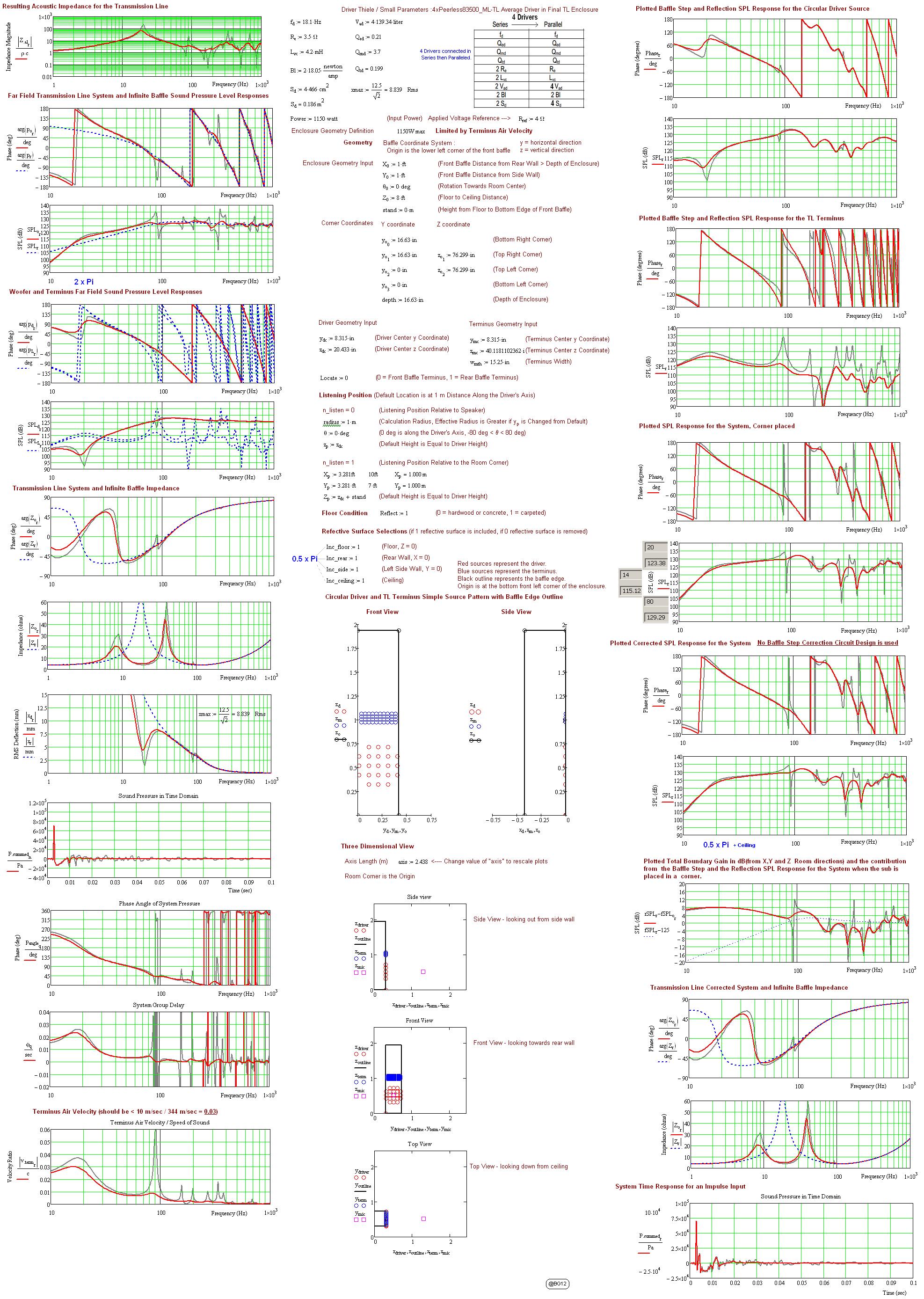

Now with a subwoofer, from what I understand, you get the majority of the output from the first 100watts of power. So after that, half of what you are fighting is power compression.
Not really. Power requirements are exponential vs SPL regardless of the type of speaker. Woofers do tend to suffer most from power compression but if you check the figures available, it is not "half" of additional power above 100W.
