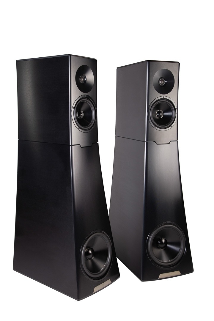

Main advantage of a 3 way is giving the smaller midrange driver the opportunity to concentrate exclusively on what his supposed to deliver- a clean midrange reproduction.
At any SPL it will free the cone from those demanding bass notes and clean the soundscape. Here is an example of a commercial loudspeaker YG acoustics being bookshelf+sub.
Sounded in the last munich fantastic. BTW this design of course doesn't take more place then a bookshelf and being a closed design is not too intrusive in small room.
