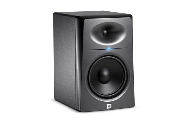

The JBL LSR28P is a perfect illustration of that point. It uses the same tweeter that the LSR32 / LSR6332 3 - Way, but mounts it in a large waveguide and pairs it with a very good 8" woofer. It has a similar ruler flat response, but the directivity is narrowed by the waveguide. The LSR 28P can also be found used for $250 - $400 each. They are my daily drivers along with the JBL 12" sub. Here is a pic of the newer LSR 2328P, P for powered.
https://jblpro.com/en-US/products/lsr2328p
