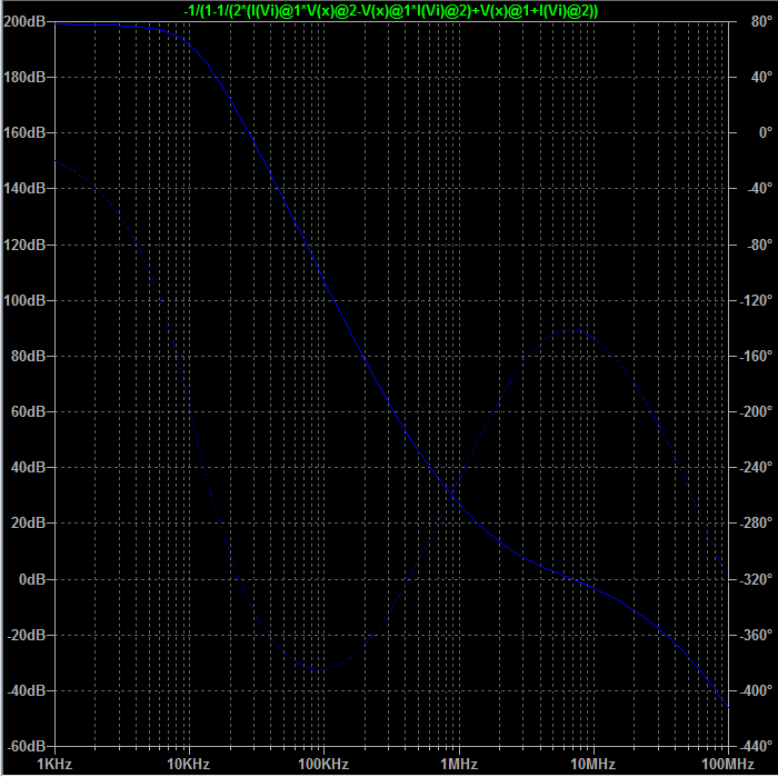

How much feedback depth you can cope with?
Of course at a given UGF (realistically for audio power amplifier with known power transistors an ones of MHz's, for example say 3-7.)
And how much do we really need?

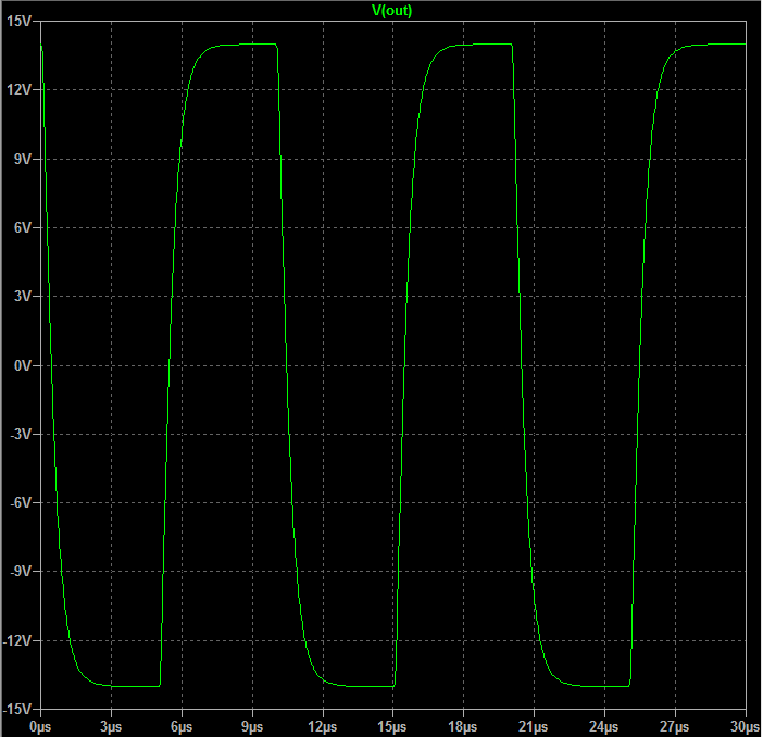

Fifth-order conditionally-stable loop?
Yes, now compensated to a gain of +26dB.
If everything is perfect as simulation, it will be stable.
Can you share the schematics?
Of course, but let's start from there:
Opamp + Common base
VAS input is a low impedance emitters of Q5/Q6 but they are driven from high impedance collectors of Q1/Q4.
And since drive currents can be easily summed we can just duplicate opamp+bjt stage picking additional stage's input from previous output. Voila, +80 dB.
