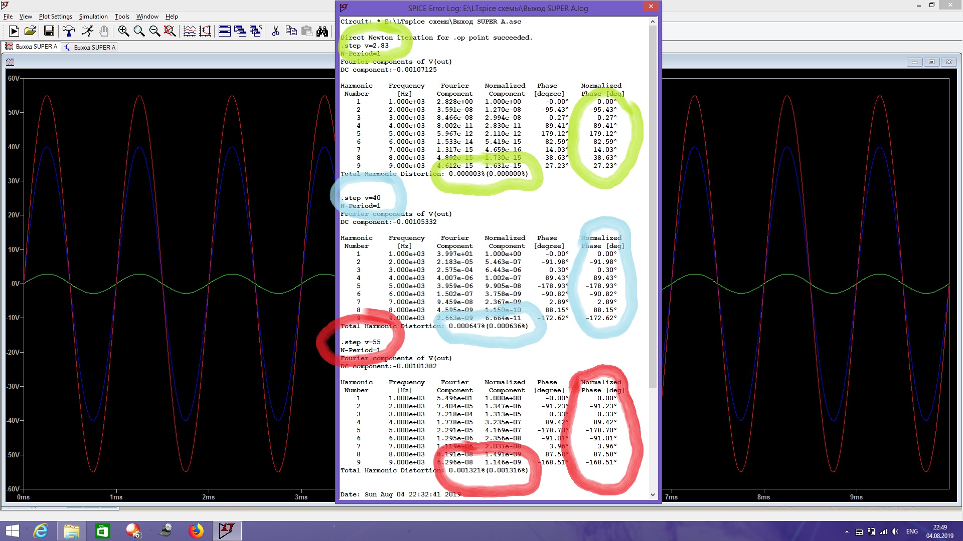

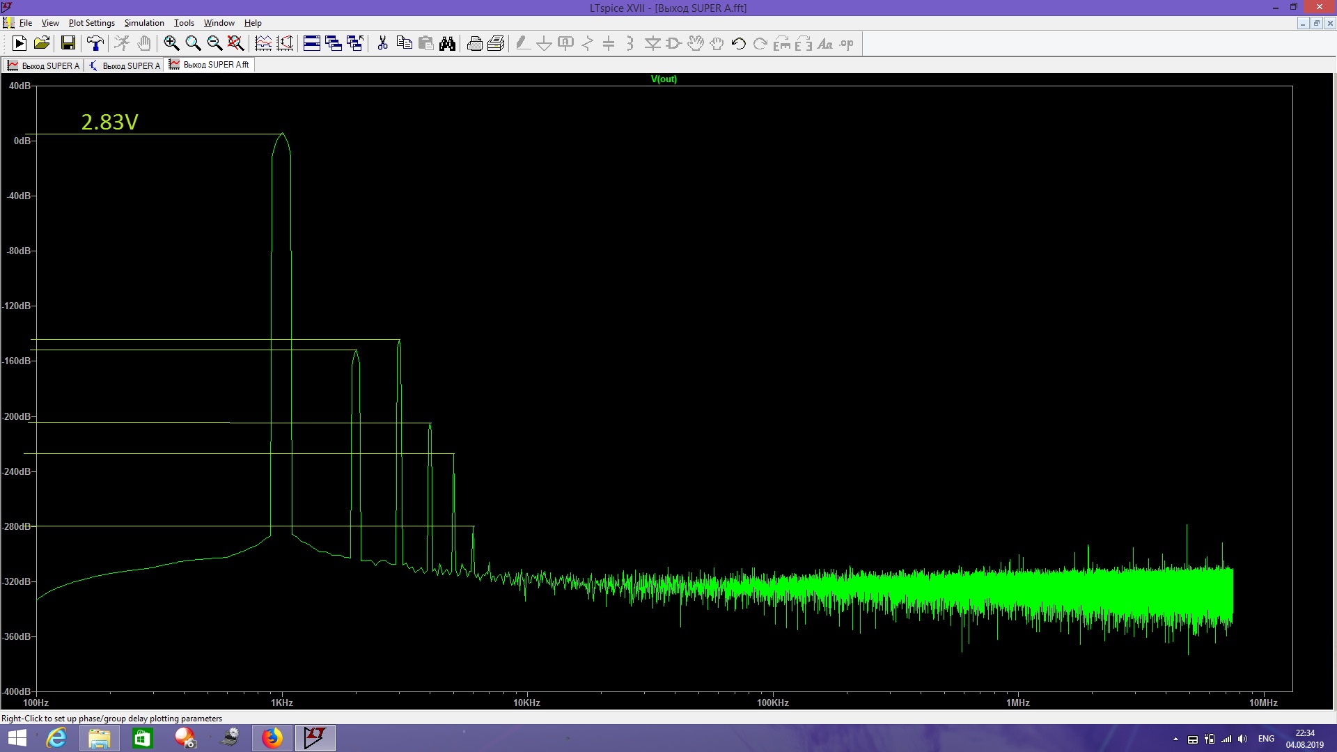

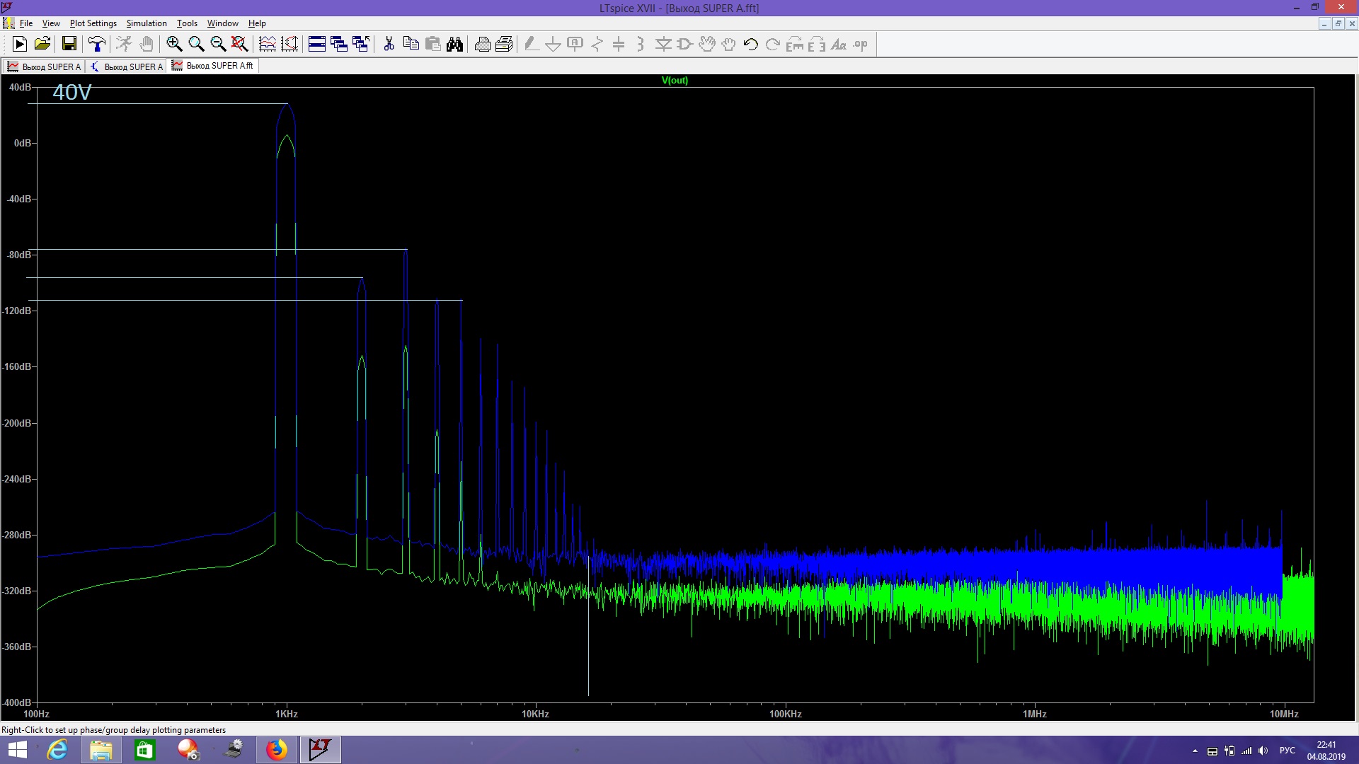

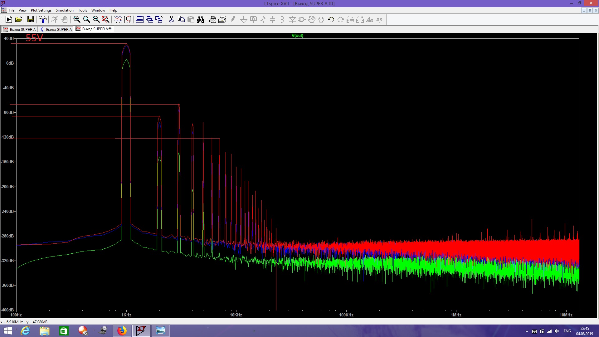

I did not understand your thought. If you are talking about the number of harmonics, then you need to evaluate their amplitude level, and it is extremely low compared to any other circuit.Gunfu your just full of it. Period
