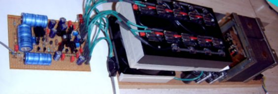

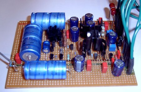

Hi David Lumanauw,
I have followed your 'diyAudio' enquiries and information seeking with interest, and I must admit that I have been sitting back for some time to see if any new answers might appear.
You ask. Very fast ? Class-A ? It is the fast and unfortunately big plus hot running class-As that are the very amplifiers that are less upset by back EMF !
We have new designs by Susan and Pavel but so far these are not of higher power. MikeW is working on a 10 output device design, and Nelson is working on a JLH type of design. I myself have a novel design based on the JLH which our enthusiastic Carlos built in a day and had working with devices he had to hand, though he is now studying class-D.
My personal rules for 'AUDIO' as opposed to audio frequency amplification are;-
Low propagation delay; i.e. low path capacitance and fast transistors.
No signal/NFB delaying C.dom with good open loop frequency and phase responses prior to NFB; for stability this means a maximum of two stages, as with the JLH class-A.
NFB to minimise forward distortion, and to damp a dynamic loudspeaker.
A very low NFB loop generated output impedance to protect the amplifier itself from phase shifted loudspeaker back EMF.
Constant class-A operation so that there is no break of gainful conduction for either output half no matter what the loudspeaker reaction, and thus no possibilty of reverse driven bias commutation prior to class-AB overload or high power operation.
To improve overall efficiency, as with a Quad Current Dumper, have a class-AB or class-B output arrangement running simultaneously, or even both together with the class-A. All conduction increases and switch-offs to be staggered so that there is a smooth transconduction characteristic, unlike parallel devices where all switch and glitch together.
All of these arrangements are in my new circuit, as per attached photos of my Class-AABB amplifier. It too has 10 output devices and is currently quiescing at 80W. So far it has peaked about 150W levels. Design is for at least 200W - 4 ohms, and it has a really authorative immediacy on cleanly amplified transients.
Note that this is only an open prototype arrangement so that I can try different mods and updates, the wood is 2ft/60cms long.
Yes there are two 2SC3241driver transistors on the circuit board, these are in a signal driven active dynamic bias arrangement which increases/decreases output current on a per-half basis to maintain input signal voltage waveform at output irrespectively of momentarily asymmetric loudspeaker load demands up to 15A (or more).
I will reveal the circuit shortly when I am completely happy with progress at intended maximum power. That's if my loudspeakers and ears last out !
Cheers ........ Graham.
