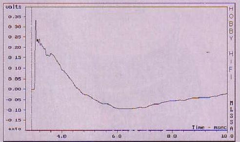

so every newbie should look for facts, like measurements,
step responce, membran movement if this info isn´t there
it might be only believe.

not much I believeOriginally posted by VanJerry Just how much can you add to a full range single driver design before risking its unique qualities?
the most important and unique quality of single driver can be seen on an image attached (real life example)
it is time coherence, transient and waveform fidelity
I think that the only thing You can really add safely is more same type full range drivers - this is what EJ Jordan or Roger Russell (IDS25) do
the second thing is active line level frequency response linearization - but nothing between amplifier and the driver
any crossover splitting the signal, any addition of a woofer or a tweeterOriginally posted by VanJerry
