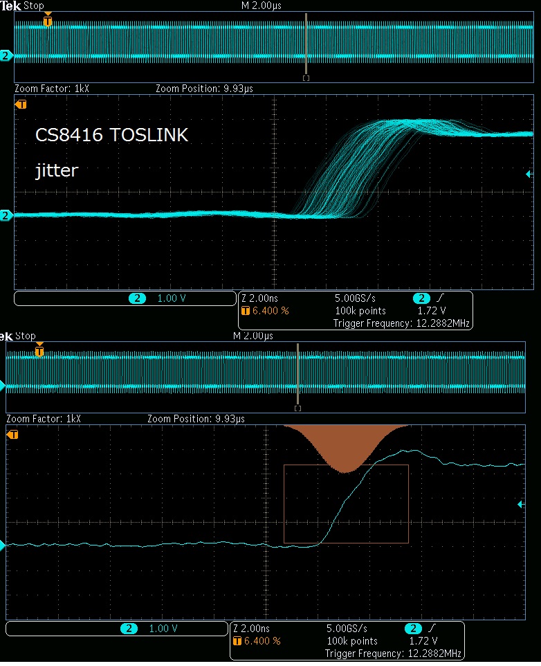

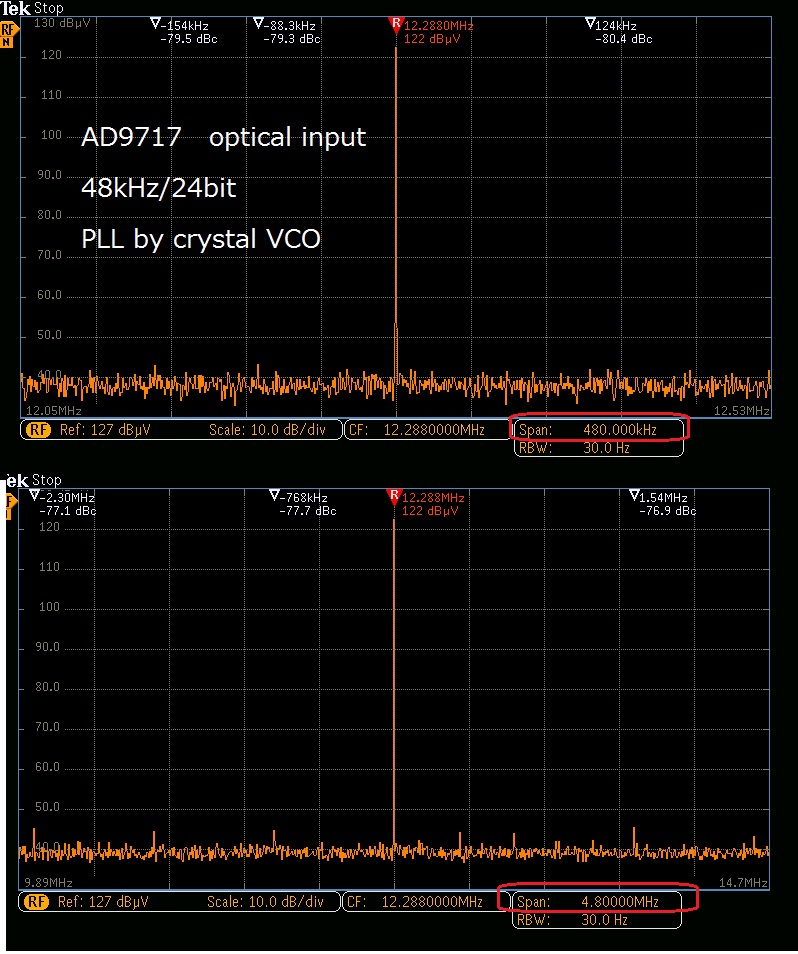

I measured the real performance of TOSLINK(CS8416). The recovered clock has jitter with the normal distribution(1st pic): -2ns to 2ns. The FFT isn't ideal, of course(pic.2). But the FFT doesn't mean the inherent flaw of the optical interface. SPDIF has a burst clock in the preamble for clock recovery, and the receiver doesn't have an Xtal oscillator for PLL. I'm sure both are the fatal failure to have excellent clock recovery.

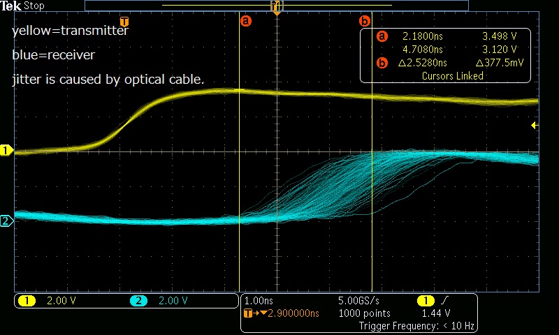

In my setup(from transport to DAC), the interface is optical but not in SPDIF. My protocol has a continuous clock for precise clock recovery, and the receiver on the DAC has Xtal for the 48kHz family. The input through optical cable is jittery(pic.3). But the recovered clock is far better than SPDIF. Besides optical one, you can't have perfect isolation up to HF. The floating capacitor decreases the isolation at HF even if you use a transformer.
