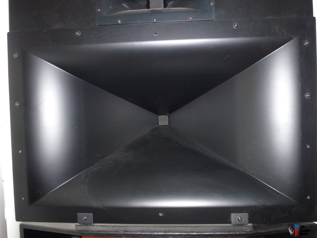

Corner horn design is not "simple" if some degree of performance optimization is to be achieved.
The Harris article, "Horn Loading Revisited" [1], will provide some incite into design details of PWK's work not found elsewhere.
Extension of frequency response upper bound is addresses by Delgado's collaborative effort [2], particularly in regards to the second decade where he added a large tractrix horn [3] to augment performance in this frequency band.
For those articles you may already have, please consider them placed here for the benefit of other readers.

Hi Bill -- thank you very much for the references. The Harris article is new to me and had not read the Jubilee paper in-depth.
