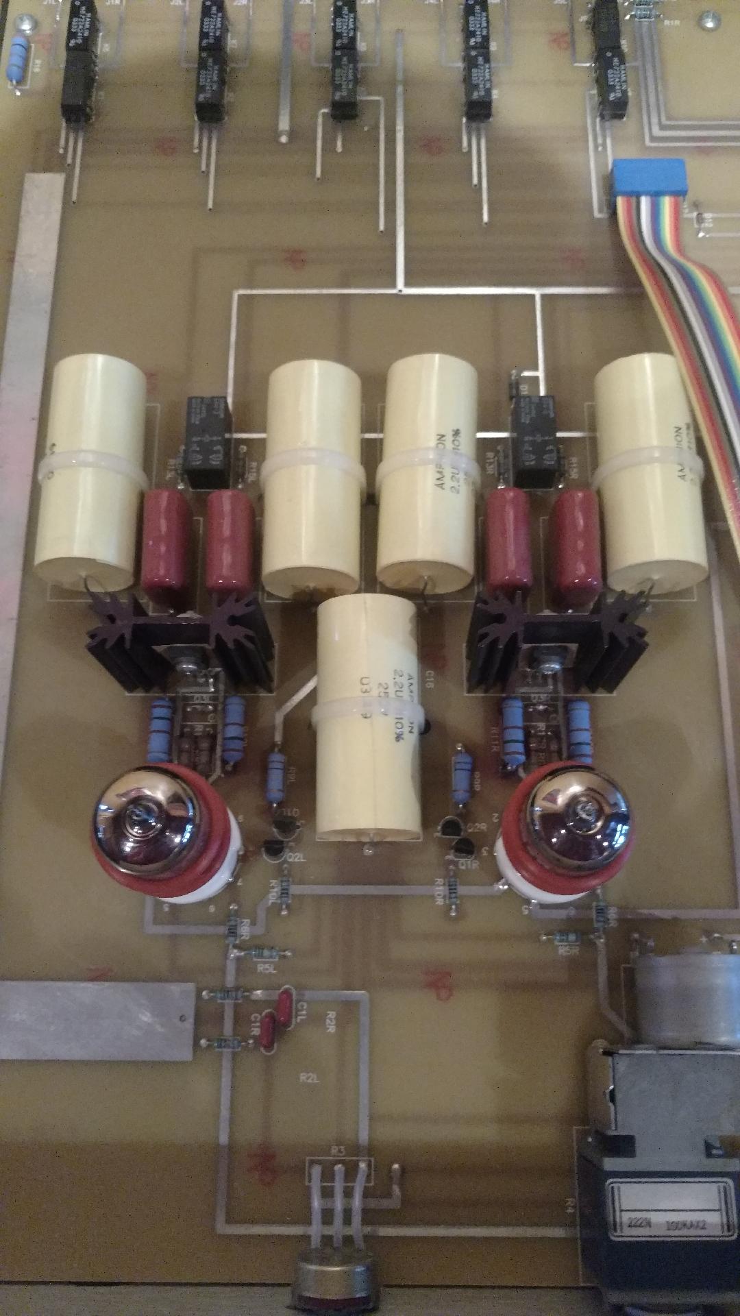

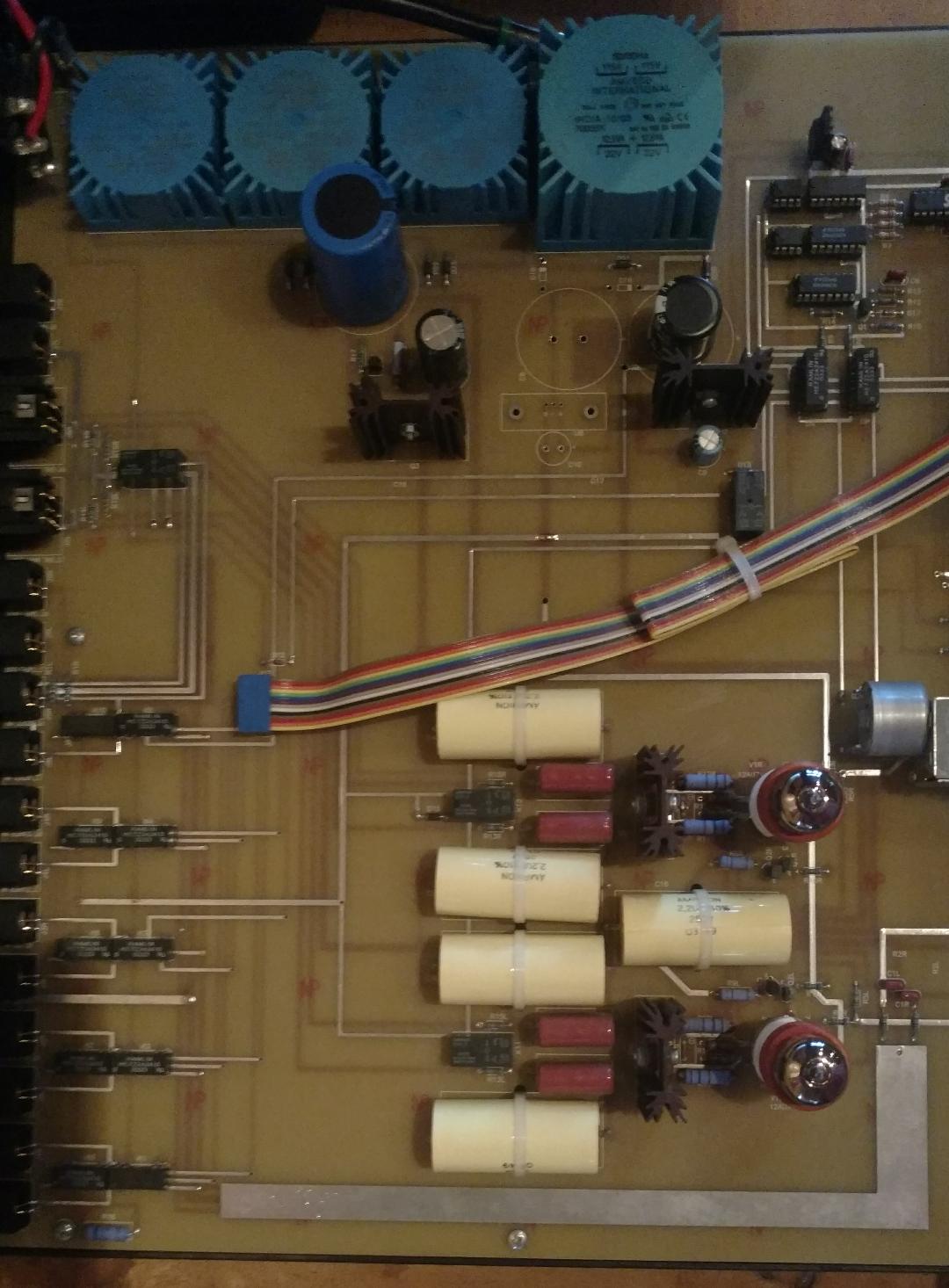

How may coupling caps should there be?
Mundorfs have a good reputation.
One thing to look out for is lead diameter. Some times these audiophile caps have oversized lead diameters and don't always fit in the hole! This probably won't be an issue for you, but I thought that I would mention it. If it ends up being an issue just use a scrap lead to create an "adapter". What ever you do, do not drill out the hole... it will damage the solder pad.
Right. I was also considering Auricap XO 2.2 uF 400v capacitors, but each lead is comprised of a twisted pair of insulated multi-strand wires soldered together at the end, rather than a solid wire lead. I didn't see any wire diameter specs listed, and I was worried they might not fit the hole, so the Mundorf Supremes gained an advantage.
There are two signal lines plus a ground for each channel of a balanced connection, so it requires four signal lines (and 4 cap) to make up a stereo pair. An RCA connection only has one signal line per channel, plus a ground, so only 2 caps for a stereo pair.
I thought that was clear, but now I am wondering why I don't have four caps for the balanced XLR outputs, and another two for the unbalanced RCA outputs, for a total of six! I guess they must tie in or split off from the XLR outputs somehow.
....I guess they must tie in or split off from the XLR outputs somehow.
