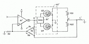

Hi Mike, I don't think so.

I am familiar with this patent....and related Hafler designs.....
....but i think you'll find this is merely a commmon-source output stage...(rather than the usual source follower configuration)....
....with local shunt-shunt negative feedback about the output stage...
This is easily seen by merely performing a delta-star transform on Ra, Rb, and Rc....
Contrary to the patent, there is no positive feedback designed into this circuit as far i can see...

Yes, a common source output stage with local negative feedback by Ra. Then overall negative feedback by Rb and Rd.
But then also positive inner loop feedback by Rc around A1.
Steven
Steven
AAHH yes....i missed that.... 🙂
Thanks Steven.....

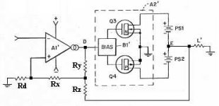

Performing a delta-star transformation with respect to Ra, Rb, and Rc, (see figure below), gives new resistor values Rx, Ry, and Rz...
This shows that a finite amount of +ve feedback, (controlled by the ratio of Rz to Ry), is applied to gain block A1.
Setting Rz=0 for instance eliminates the +ve feedback loop.....
Note however, that since both minor and major loop feedback are derived from the same node, BIBO stability (or lack thereof) of the major loop may only be ascertained by choosing a test point that simultaneously accomodates, (or 'breaks') both minor and major feedback loops.
see section 4 here:
http://www.ece.ucdavis.edu/~hurst/papers/FullyDiffRR,CAS.pdf
Clearly then the system's overall loop transmission must be BIBO stable, notwithstanding the +ve feedback minor loop.
In other words, any propensity to local instabilty in the system must be compensated for elsewhere if the major loop is to be stable.
In this case, the local +ve feedback loop is clearly controlled by the major loop....
What happens then when when the later is momentarily disabled by anomolous operation such as clipping...?
At best you'll have excessively delayed recovery from clipping overload, at worst sufficiently prolonged 'sticking' to the supply rails to activate your DC offset protection....if such a system is employed.....
It is for these reasons that my doubts persist regarding such systems......at least in the context of nominally linear time invariant designs.....
