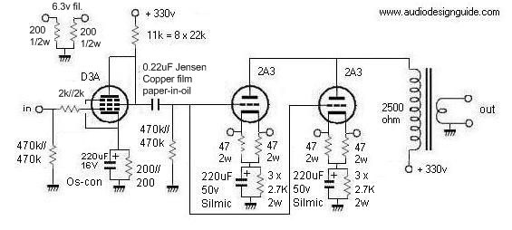

He'll get lost just in the part count! K.I.S.S. Try this one from 'Andreas'" schematics listings.....
Class A, really simple....just to get his feet wet. The idea of running a full PP is just asking for him to get discouraged. Besides.... kits really take away the real "fun", point to point wiring, the layout, dimensions......all the real good stuff.

The OP asked for a kit. He also wants to keep his speakers. The speakers rule low power SE circuits out. More than 1 ST70 has been successfully assembled by somebody "following the dots".
