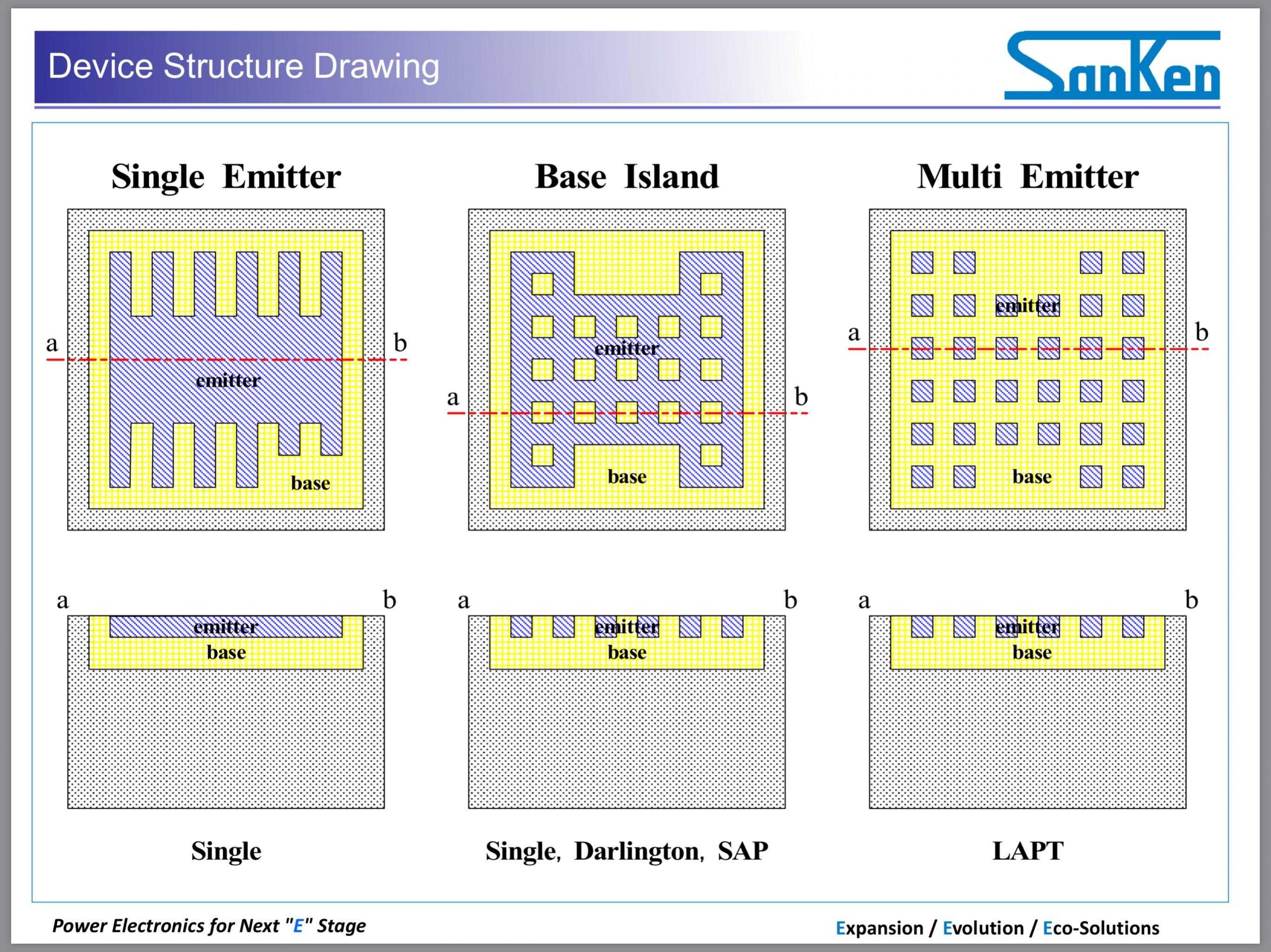

Can you explain how you can tell with a regular microscope how many emitters a die has ?
I can understand it for a ring-emitter transistor, as those are clearly visible. But ime the dies of e.g. Toshiba A1094/A1095/C2564/C2565 do not look all that different to regular finger-emitter bipolar dies seen from the top.
Add to that, that A1301/A1302/C3280/C3281 are a totally different breed.
(Fujitsu has a patent for a power device with a multi-parallel transistor die, btw)

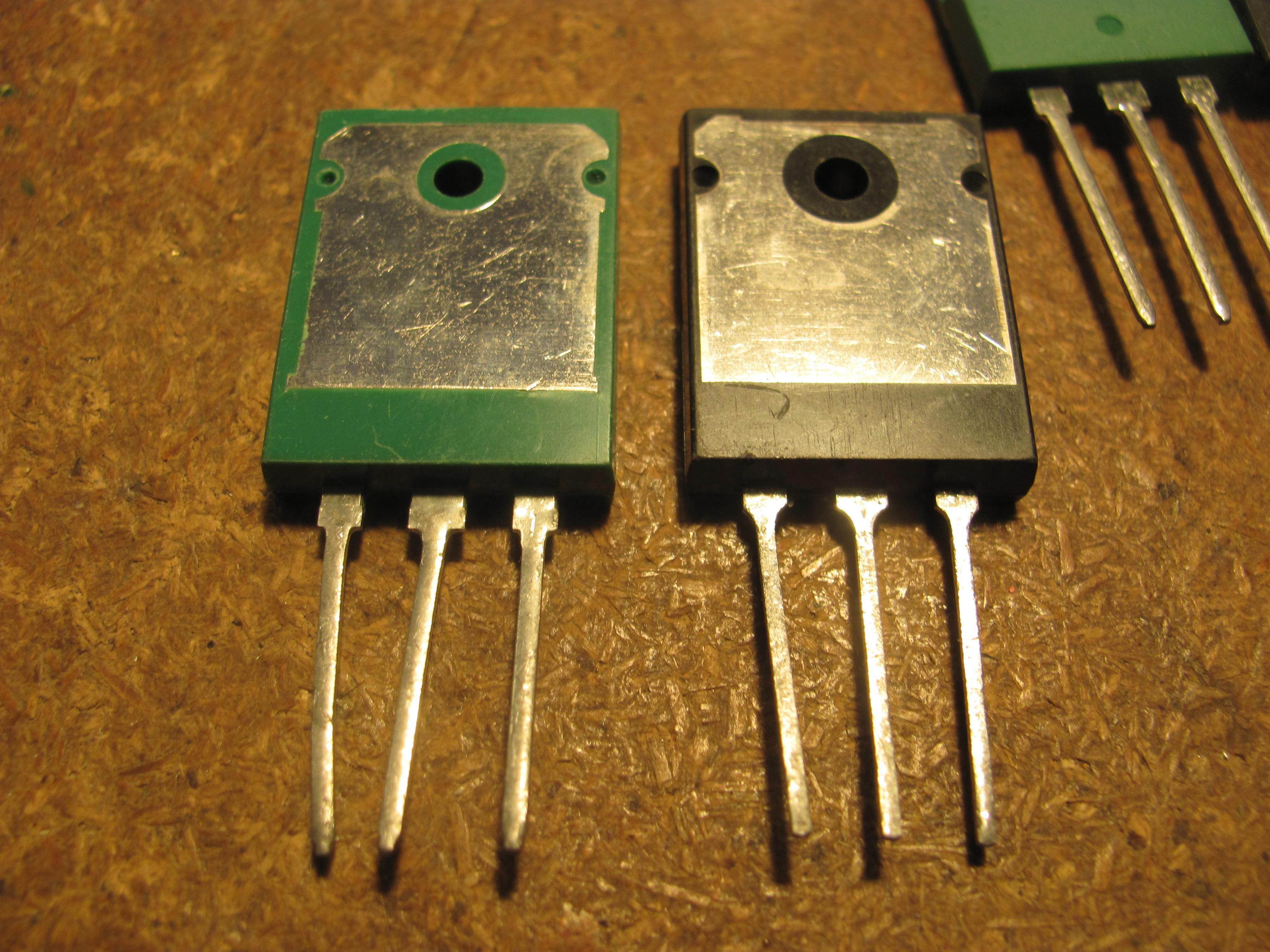

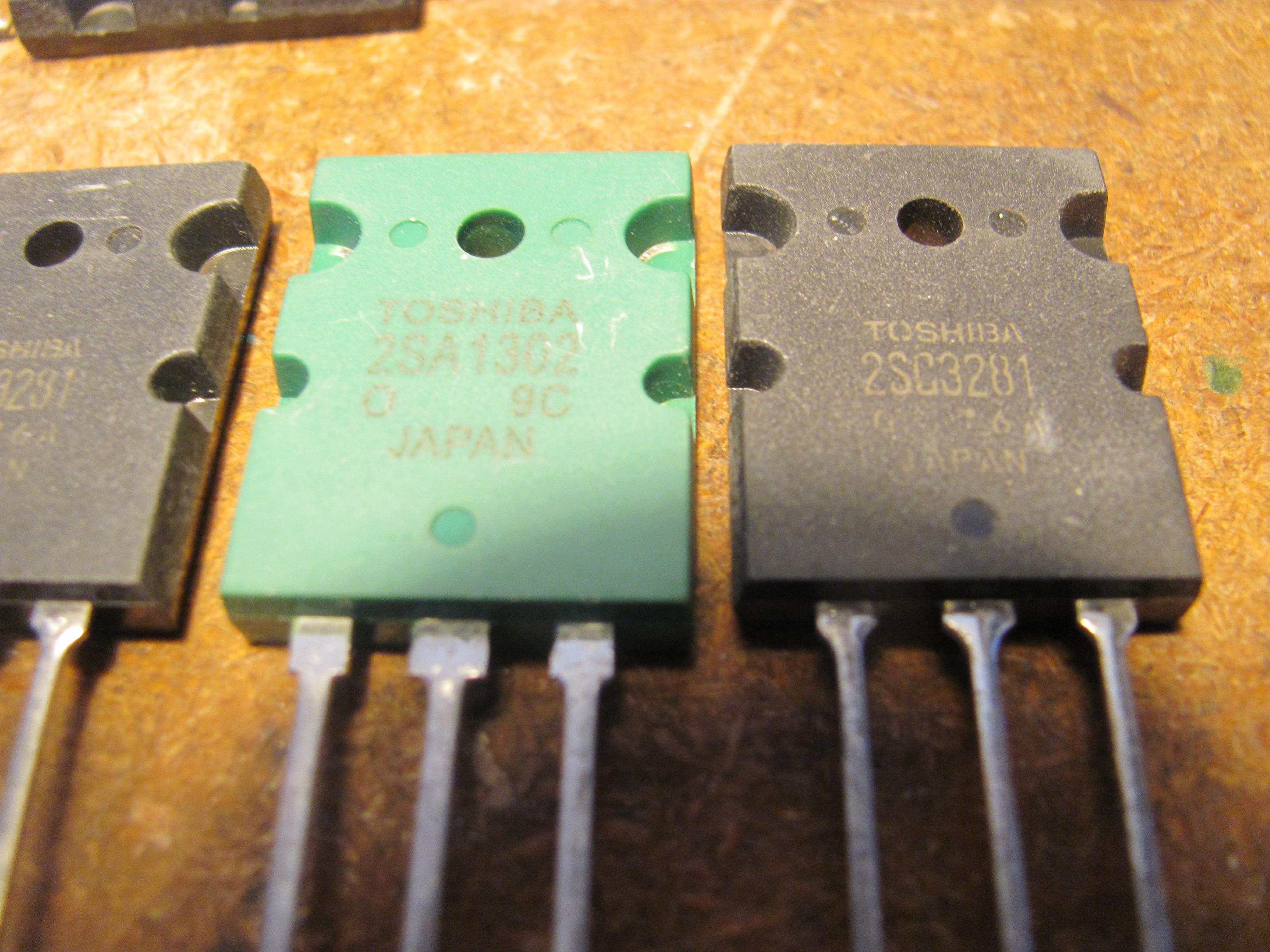

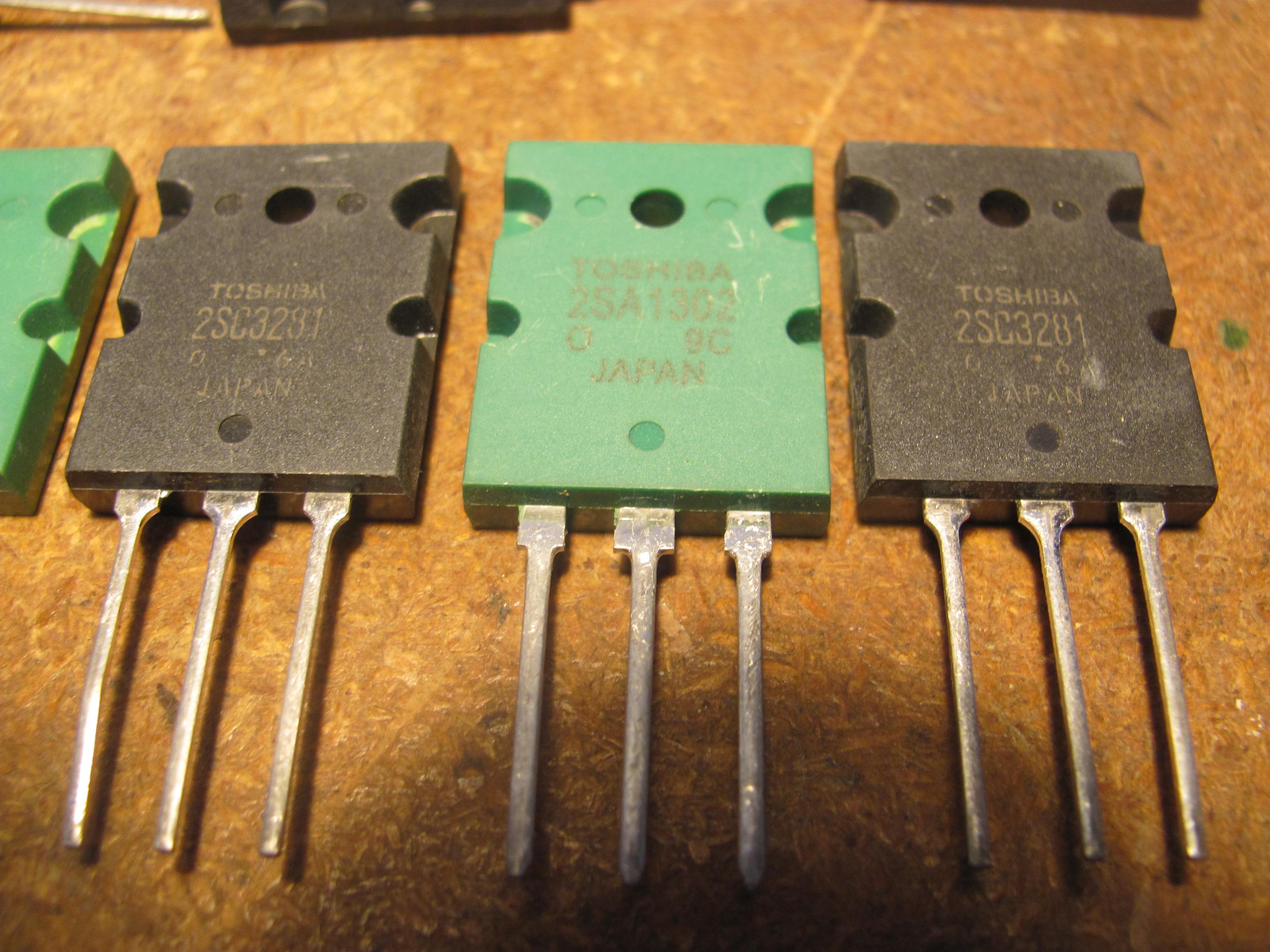

Today i went to visit an old friend who has a small repair shop in a city nearby, and speaking to him i asked if he knows this transistors (2SA1302 and 2SC3281) then he said he used some and still have some left in stock, and bought them many years ago, so i bought 4 pairs, and post here the photos for you, maybe can tell me if they are fakes or the real ones. Personaly i think are real ones, because he told me that bought them more than 10 years ago...so what is your opinion ? Maybe later i will try to "open" one to check,but if they are real,i will miss one pair. He bought them, he said for about 5 Euros each at that time.

They look really fake to me. Toshiba had veeeery high quality standards, and the printing on those is all off (never seen that on an original part). Also, the legs aren't the same on the green and the black parts you have there.

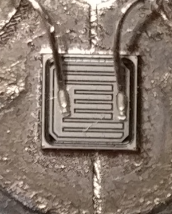

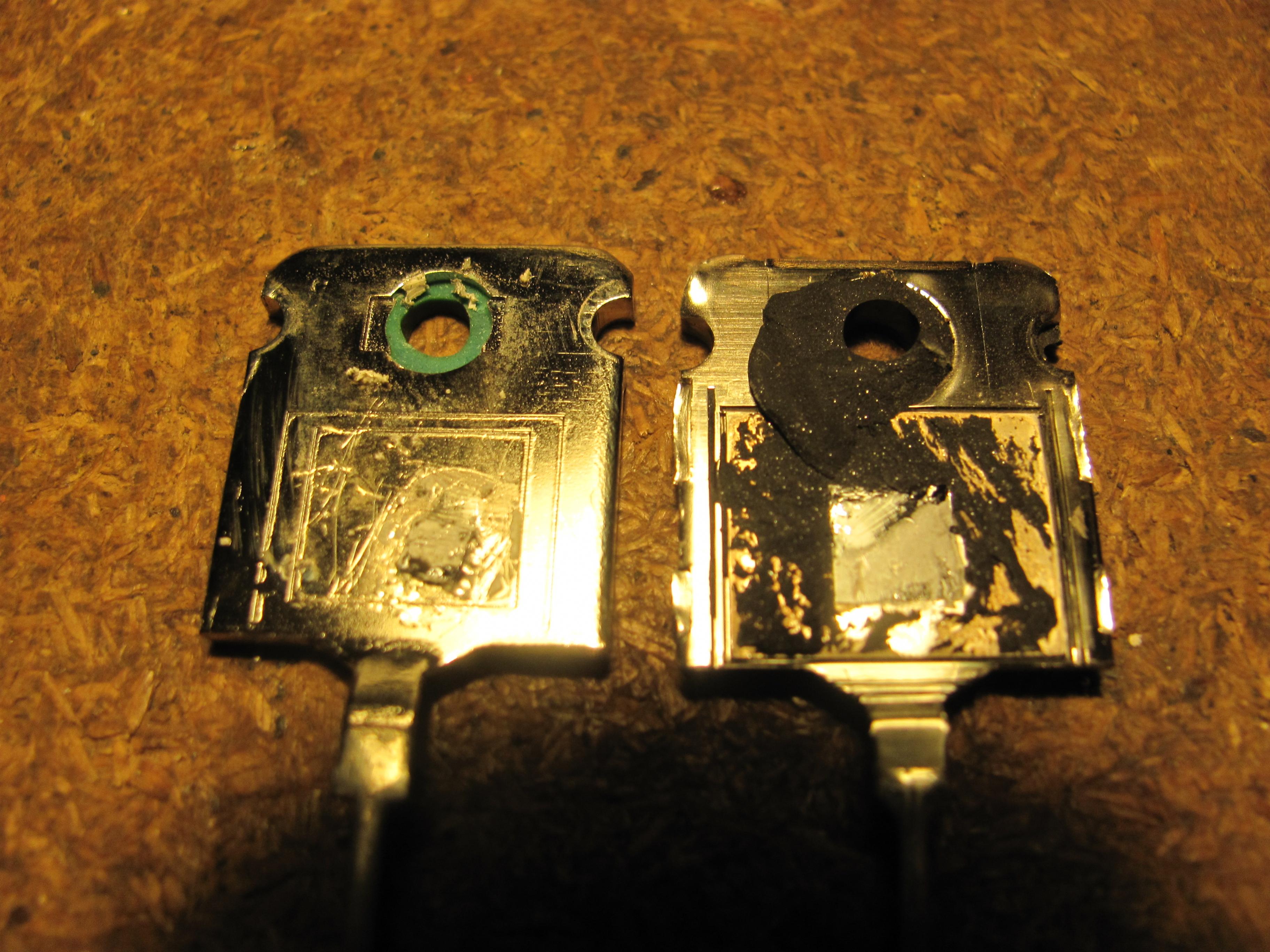

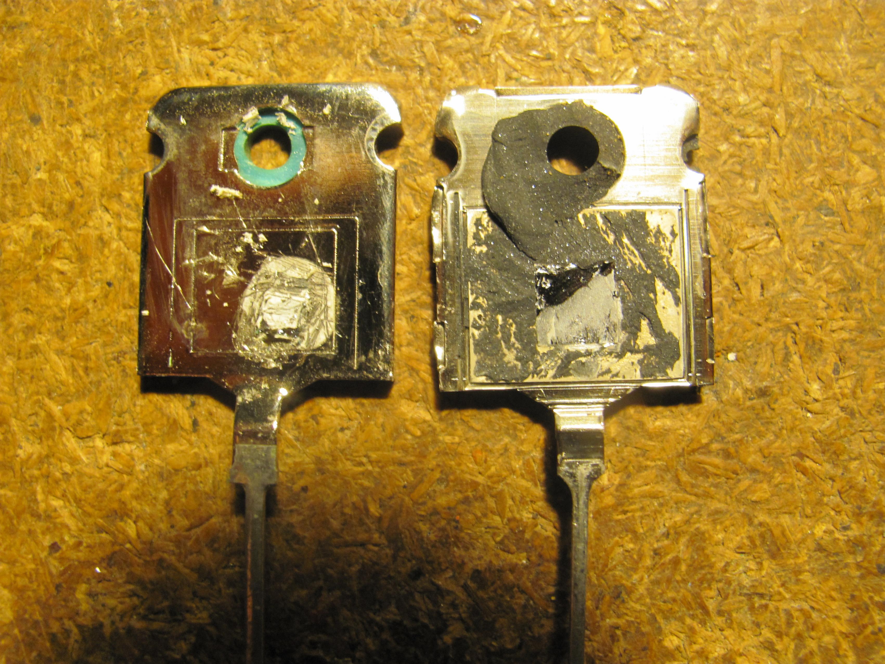

OK ! i just used the hammer and it worked ! The picture in the left is the 2SA1302 wich is clearly a fake with only 2mm die, but the 2SC3281 has a die of 5 mm, so i assume it is a genuine one.

EL's green ones are fake, the black ones are probably real. The black ones use modern laser marking - and the green ones are supposed to "look" like they do. But back when they did make the green PNPs, they were screen printed like Welcome's -which are real. (How can you *really* tell? They came out of working equipment...) EL's green ones have the wrong leads - Toshiba never used ones that were squared off by the pacakge. And the mounting hole size is inconsistent.

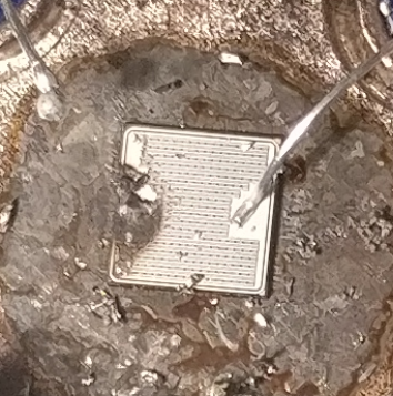

Oics attached show a(blown) die from a 2sa1065, clearly visible the many emitters

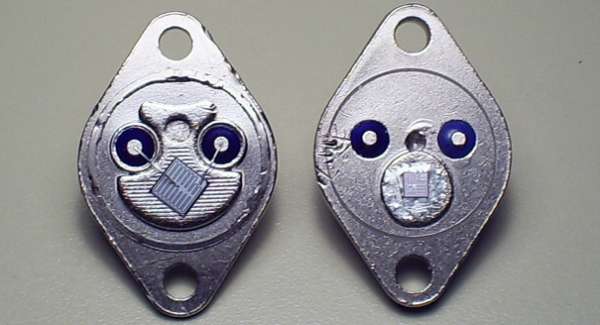

a philips high Ft bdy90 with only a third of the power of the toschiba and a picture of a real and fake mj15003.

That looks like 80-some-odd emitters. And one of the highest fT Toshiba ever made in a die that large. I liked to use those for *drivers* for big banks of TO-3’s back in the day. Still have a couple of big EF3 amps with the C2565/A1095 in that position. It gave good composite fT and gain linearity using rugged outputs. The others are just a single 10 to 20 *finger* emitter structure which is typical.
