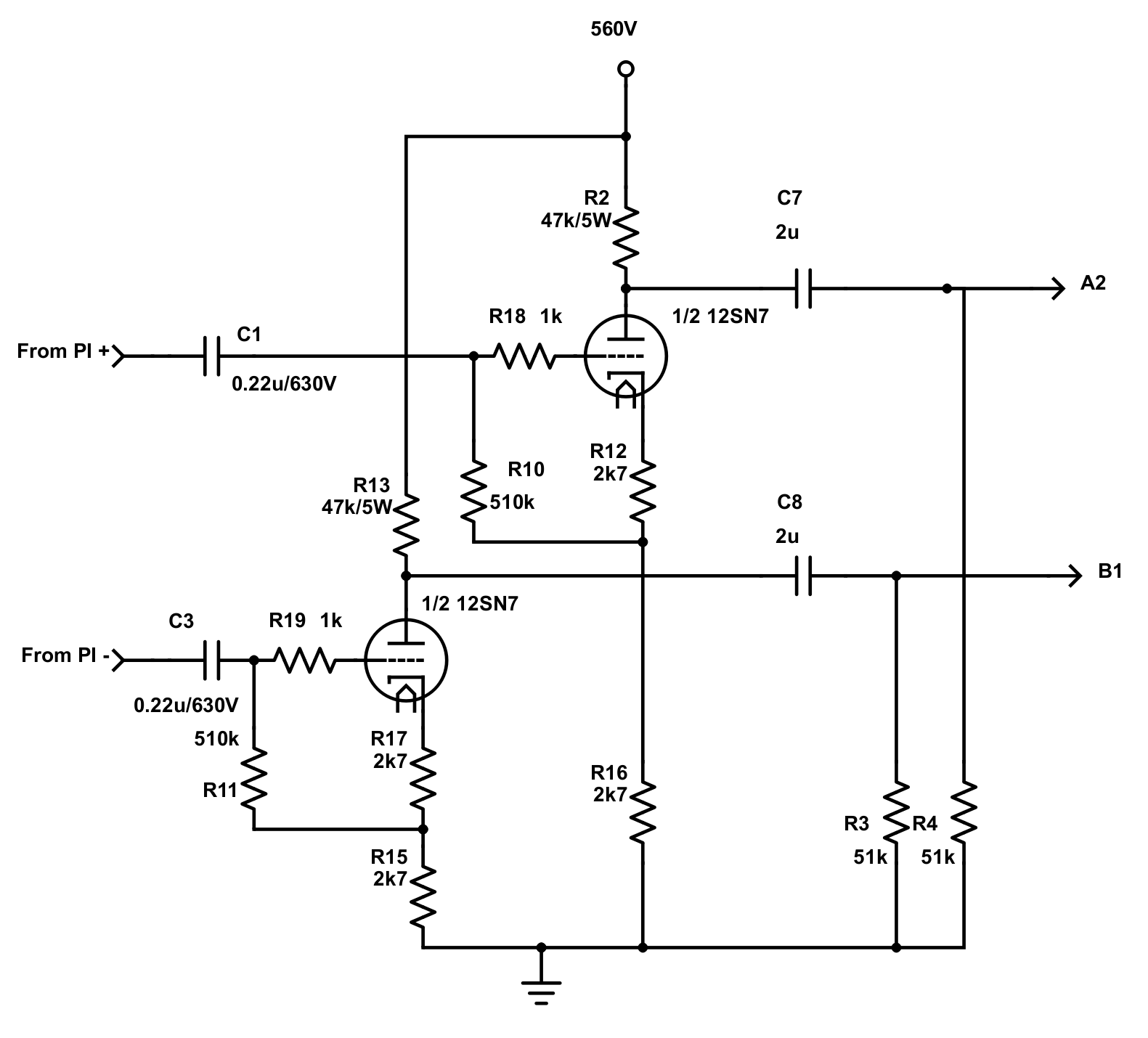

Wik Member Joined 2021 2023-04-05 1:07 am #1 2023-04-05 1:07 am #1 ? Attachments 12SN7-Driver-final (1).png 44.4 KB · Views: 150 Reactions: lineup Galu Member Joined 2018 2023-04-05 2:23 pm #2 2023-04-05 2:23 pm #2 I think you mean mA, i.e., how many milliamps? Reactions: Wik lineup Member Joined 2005 2023-04-05 5:21 pm #3 2023-04-05 5:21 pm #3 Like maybe 6 mA per tube. 6 + 6 = 12 mA Reactions: JMFahey and Wik JMFahey Member Joined 2009 2023-06-01 12:35 pm #4 2023-06-01 12:35 pm #4 Yes, assuming plates sit roughly at half +V, total woud be around 560V/47k = 12mA. Reactions: Wik You must log in or register to reply here. Share: Facebook X (Twitter) LinkedIn Reddit Pinterest Tumblr WhatsApp Email Link
