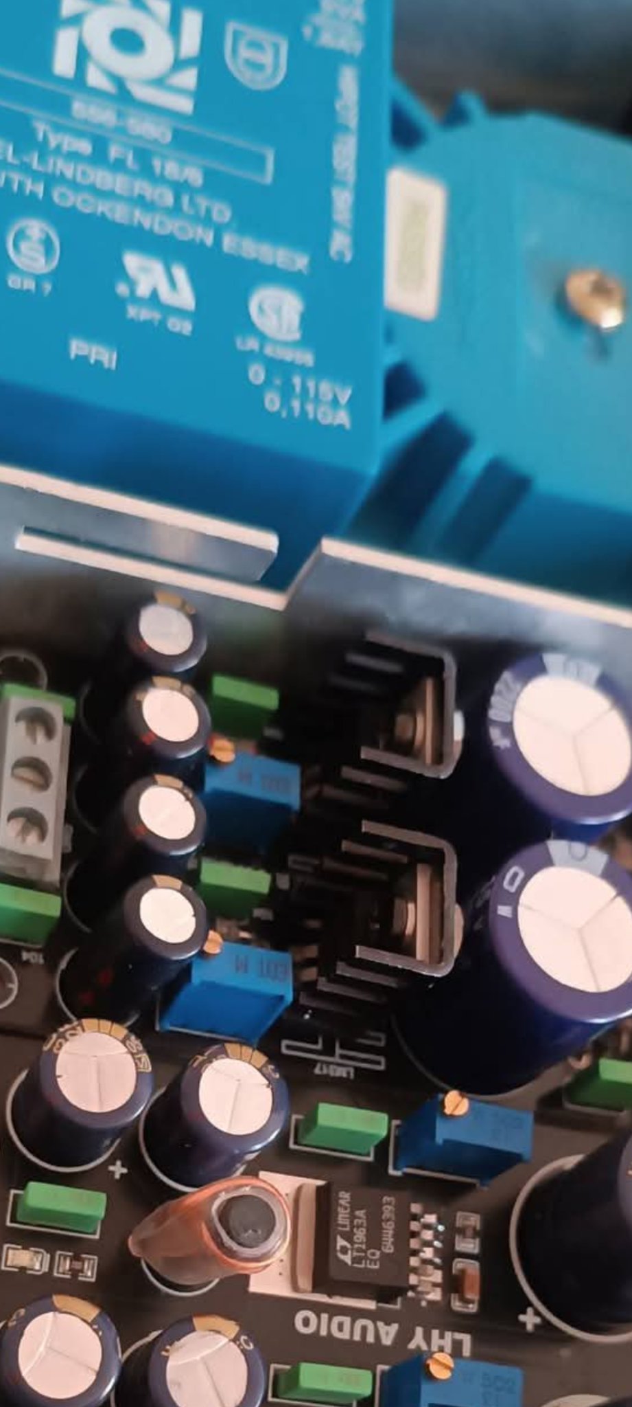

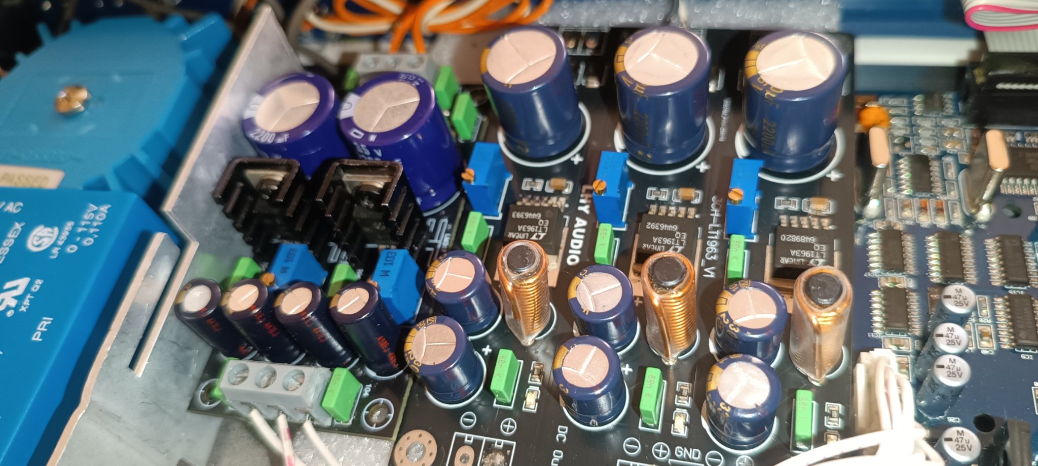

How many mA does 1 opa1656 opamp draw from the transformer?
That question has been asked before and the answer was it draws 3.9 mA per channel so let's say 8 mA for 1 opamp. That will still be the case as things haven't changed.
Maybe you can do the work and find out what the current draw of the existing opamps is? You know OPA1656 draws 8 mA. Possibly the PSU also feeds other sections so most handy is to compare the old and the new opamps.
The 2 x 12V AC 2 x 417 mA 10VA transformer can deliver about 2 x 300 mA into rectifiers/filter caps + load continuously but it is better to stay below that. I would derate to 2 x 200...250 mA.
Are the current opamps defective? If they are OK there probably is no need to replace these for 50 MHz capable CMOS opamps and have the risk of defects because of being unexperienced, ESD, oscillation etc. Opamp rolling is pretty useless when not looking at how stuff is implemented. It is like replacing the motor of your washing machine for a random other one expecting improvement and whiter than white bed sheets.

Rectification means you need about 50% margin on current.
First it is the 1.41VxVAC that gives you the DC. Then the charging current rms of the.capacitors is larger than DC current draw.
Transformers are actually current limited.
So 11 OP at 8 mA = 88 mA.
Transformer is 420mA, so I say about 250mA DC current draw is safe, plenty of margin thus
We know nothing about OP load and circuit so it is hard to say how much they actually draw including loading.

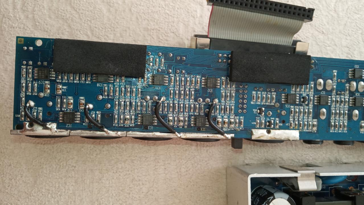

Thanks, right now 11 jrc4580s are connected, +15v 90mA, -15v 90mA is drawing current.

The current opamps are solid, I have a sample opa1656 from jrc4580 behringer deq2496 ti, I thought I would evaluate it.
NJM4580 in SMD or TH? If 11 of these connected to +/- 15V consume 90 mA then 11 x OPA1656 will not be an issue with regards to current.
However they are way faster/higher bandwidth than NJM4580..... don't know the device but what is it you want to achieve? NJM4580 is used a lot in pro audio as the numbers are usually high and the costs of opamps a key parameter. I don't like NJM4580 but maybe OPA1656 is too much of a risk.

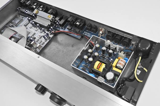

I will use 11 opa1656 for behringer deq2496
