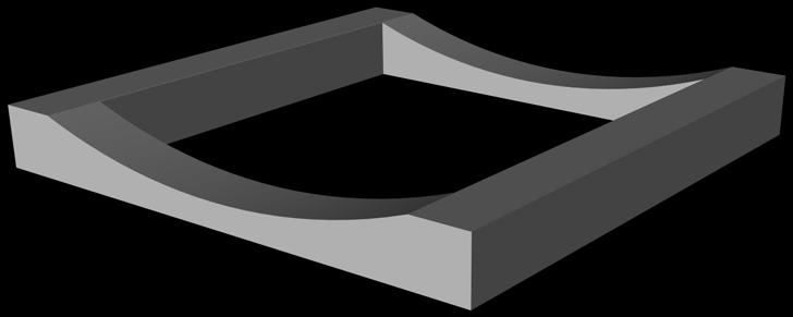

I've got access to a machine shop
im going to make a cylindrical mount for the glass that will look something like what i've attached
I won't really have to heat the glass very much, because there isn't much of a curvature
i will then screw the lexan onto the metal, so that the lexan stays intact with that mold.
Then i will fill everything up with mineral oil, and but another piece of lexan on the back of the mount

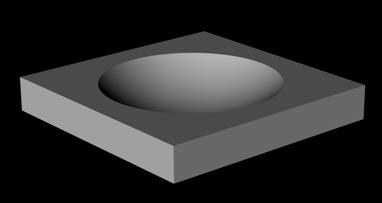

Im going to find a way to machine a mold like what I've attached. How this one will work is I will put the piece of lexan ontop of this mold, and then use a torch from a distance to heat the lexan, and let it melt down to form this mold.
Then i will:
a) cut a piece of lexan that spans bigger than the hole
b) fill the glass hole up with mineral oil
c) machine a gasket for the glass hold and the bottom piece
d) attact everything together
This is my design for a fresnelless projector. There is a chance that I may have quite a bit of money coming in in the future, so if that happens I will be moving to a large high resolution LCD.
Im still working out the logistics of this, its going to be alot of work to get it right.
Psionic can you attach some graphics onto that bracket on how the cyclindrical lense would attach to it and how the light would pass through (like, does the light pass through the long side of the lense or through each end -- may be a dumb question, but ??)

JudeBarnes said:like, does the light pass through the long side of the lense or through each end -- may be a dumb question, but ??
yep dumb question 🙂
it passes through the bottom hole and travels throught the top.
What did you use to mount the glass?
And did you take the glass paper off before you cut it?
How did you know you had the curvature correct?
Are you saying the image passes through the bottom hole on your BRACKET with the cylinder in place? Which would mean the image actually passes through the SIDES of the cylinder? Or, do you mean it passes through the bottom and top of the cylinder itself, as well as, or instead of the bracket. Send an updated graphic w/ the cylinder in place so we can see how it's mounted in the bracket, and a simple arrow where the image passes through, your project sounds very interesting!
In my lexan version of the standard anamorphic lense project (two prisms filled with liquids), there was no glass whatsoever. I "mounted" two pieces together with E6000 compound, and had no leaks on my first try. I knew I had the angle (not curvature per say) correct because I had a piece of wood cut to the appropriate angle which I used as a template to wrap the heated lexan around.
This model was the one unforunately that didn't provide a very good image so it was trashed right away.
On my glass version, there was no glass paper on the glass I got, which was scrap picked up at a frame shop for free. The pieces were also "mounted" with the same E6000 compound.
