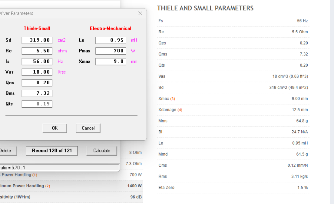

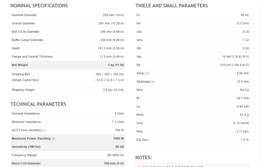

I am still interested in what people think is a suitable upper limit for a compression ratio here. Given the high motor strength, long xmax, 4 inch voice coil and moderately high mmd, I would have thought that this woofer would be a good candidate for horn loading, however I am certainly no expert here.

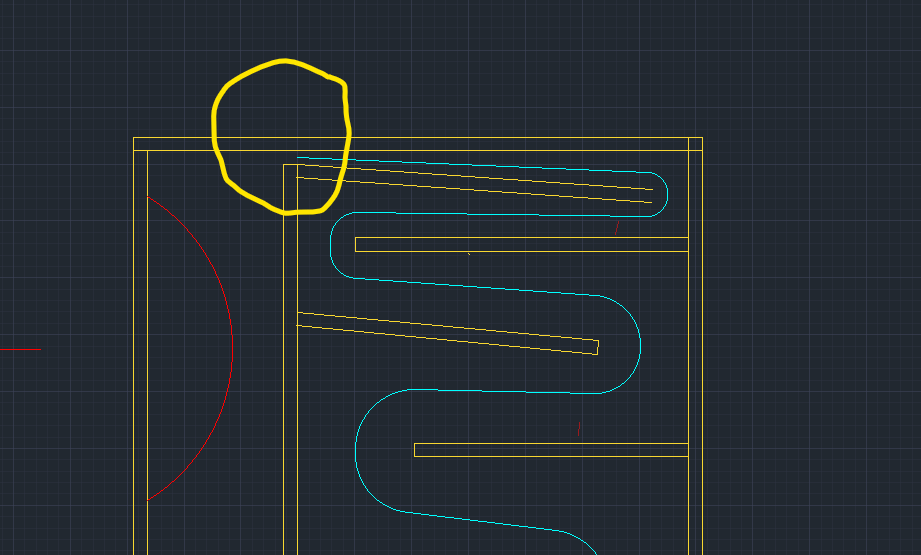

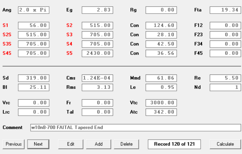

OK @GM Here's a compromise with a 4:1 ratio. We aren't talking "sub bass" per se here, given this will run with a 50hz 24db/oct high pass.
I reduced the height somewhat, and still managed to get ok 60hz performance.

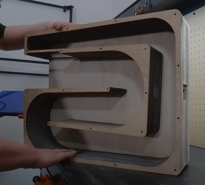

A scale drawing for your viewing pleasure. the rear chamber will be divided, so that it is only as narrow as the driver (not the 500mm width of the cab), and packed to reduce the volume as much as feasible

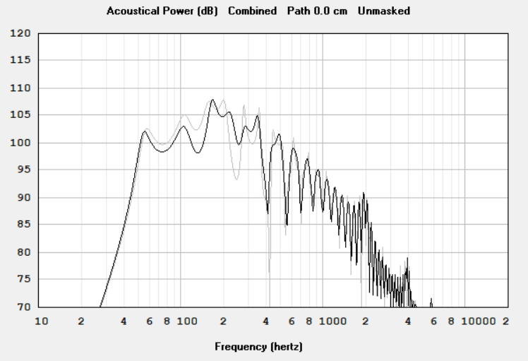

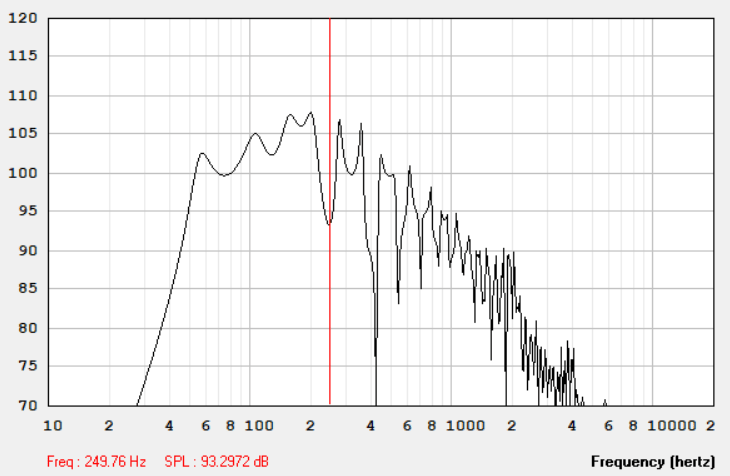

Hornresp file is also attached. I am wondering how big the nulls will be at 250hz and 400hz. I am hopeful that the bends in the horn will smooth things out a little up that high.

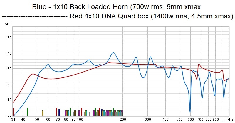

Going to different topology as suggested in the post #12 you could achieve attached results, no dips, with the same total volume but you were not interested. That could be optimized further like trying to adding front chamber, etc. All depends how wider and smooth the results needs to be and how much complex.
In order to minimize the dip in the BLH You could add damper material in the horn segment, you can simulate this effect with Loudspeaker Wizard tool inside hornresp, but the improvement will have some costs.
What does a person do with freq response that look like 💩🌪️💩🌪️💩🌪️💩🌪️💩 Versus a simple offset entry TL?

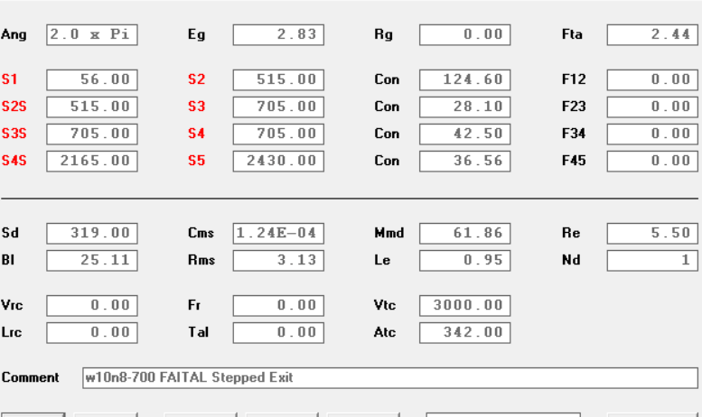

Here's another topology that achieves my goals with a much smoother delivery.
A front loaded horn with a vented rear chamber.
While the response is much smoother, it also drops like a rock below fb. Whether this creates an audible problem or not, I am not sure. The graph shown is with a HPF that will allow 500w input without exceeding xmax.
Hornresp file attached if anyone is interested in critiquing it.

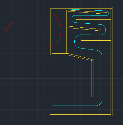

To improve the response, avoid offset driver, you easily remove it adding one panel and a throat adapter. See attachment #1 and the result it will give you in the attachment #2 red line. Attachment #3 show you where to add it.
Check group delay, you will see that the vent improves the low end but at certain price (increased group delay).
Ice volume isn't a problem and for sure power will not be a problem playing only guitar with the box, so you can go full sealed.
HessBH layout, revoing off-set drive may offer a good layout to achieve your horn lenght, otherwise you can go the SuperBassHorn layout that need to remove the offset too.
While for Subwoofer offset isn't a problem for wide range it's and you will see the result in the simulation.
