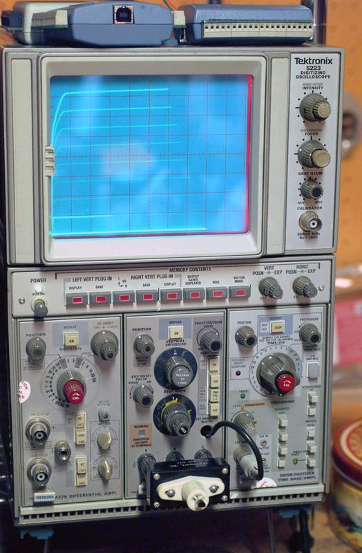

Tektronix changed over to incandescent bulbs from Neon bulbs in some equipment in the early 1980s. One of the plug-ins for my 5223 was quite difficult (impossible) to read -- and one of the incandescent bulbs had failed -- seems to have fried its legs off. Oh, they're wired in series which means that none could be read. Darned if I didn't have the correct LED, but a grommet and another series resistor always helps. Further suggestions are welcome.

How many are gone? If its only one and a few are in series then either short the dead one out if your brave, or add a resistor, maybe 10-50R.
Measure the voltage and current for the whole string. If you used a resistor factor it in to your normal Ohms Law calculation to work out the voltage and current of one bulb (or use it for your current measurement😉)
Alternatively:-0 rip am all out. measure the open circuit voltage for the string and work on 20-30mA for a string of LEDs. Work your series R accordingly. This current may be a bit much for modern LEDs but its something to work from.

Just thought, if you only want to replace the dud one with an LED then its the same good old Ohms Law stuff. Just use a resistor of appropriate power rating where the bulb was and factor in your 20 or so mA for the LED. The LED then be in parralel with the resistor.

Fixed
Above a certain serial number Tektronix changed to incandescent bulbs in series (was neons in parallel). These run off the -30V rail with a small silicon rectifier and an 820 ohm resistor. I put a 2.2K in series and a pair of white LEDs. The 5223 scopes are actually quite nice. This one came from a medical equipment company and was in almost new shape, and the cost was very low. Folks don't like them as the bandwidth is quite low. The 5223's have XY Plotter and pen-lift output on the backside, so you can take the output and dump it into a data acquisition card (you can see a couple of McDAC's on top of the scope.)
