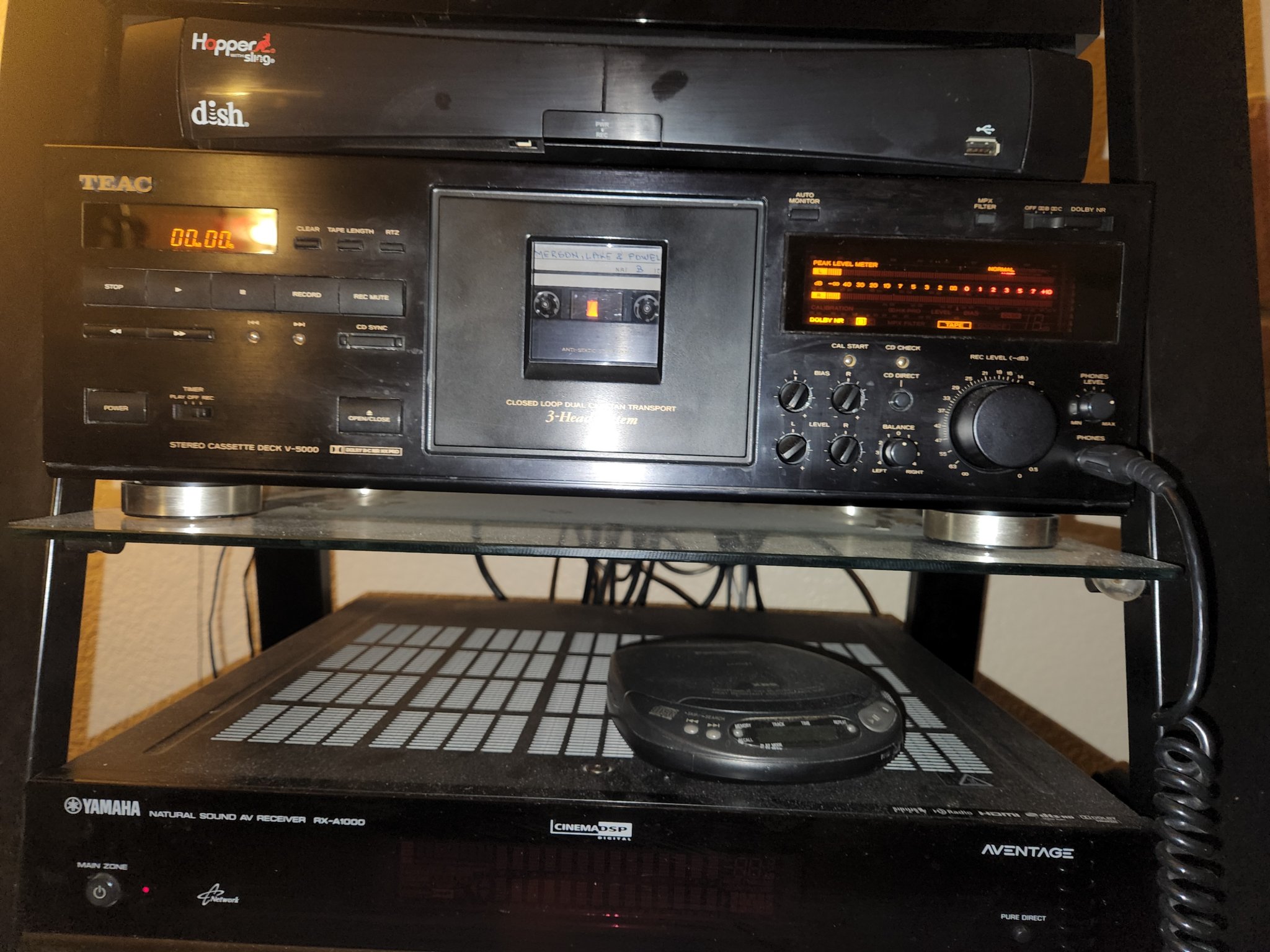

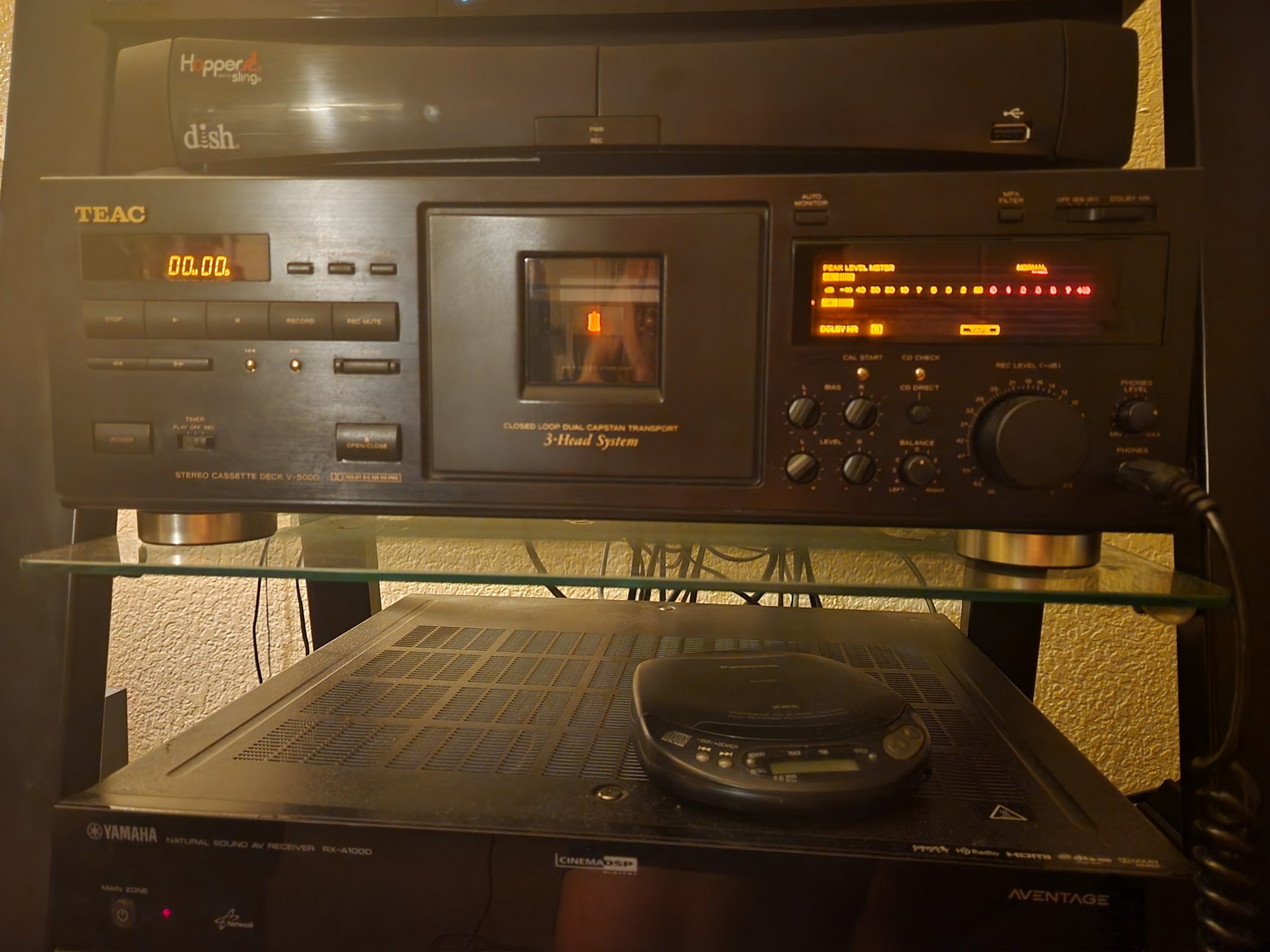

I am having a Teac V-5000 from ebay which works with a slight problem.

A Service Manual would be a good tool for troubleshooting problems.I am having a Teac V-5000 from ebay which works with a slight problem.

Available here, you just need a (free) registrationA Service Manual would be a good tool for troubleshooting problems.
https://www.hifiengine.com/manual_library/teac/v-5000.shtml
Thank you for the tip, Sir. I am printing the service manual now. Greetings from California!Available here, you just need a (free) registration

Ralph, thank you. I downloaded the manual. I opened the case, and what I saw was a monstruosity! 🙂 This cassette deck is built like a tank.Available here, you just need a (free) registration
Not to mention that in order to access the head mechanism you need a lot of dismantling. I decided I dont continue. I opened a top plate assy which covers the cassette hole sensors (the cassette type selector), but I didn't continue past it. The take up spindle is driven by its electric motor via a clutch. Why it stops roating, I don't know. It's like the motor suddenly stops turning. I could try to see if the motor receives power when the spindle stops rotating, but I didnt do that.
I tried to make a search online for this kind of erratic operation, and one of the answers was, clean the heads??
What is happening is that by the middle of cassette playing the take up spindle stops rotating, randomly and then the machine senses the thing and stops.
If I try to clean the heads with a non abrasive special cleaning cassette soaken in alcohol, then the problem somehow disappears. I believe this has to do either with the take up spindle motion sensor, or there is something else, but I dont think I will send it to repair, or try fixing it myself.
Clean the pinch rollers, capstan etc.
A drop of thin lube suitable for the materials used would also help in sticky mechanisms.
All is clean and rotating freely. There is nothing to lubricate. It's just the take-up spindle which stops rotating, randomly. It looks like either a control problem, or the electric motor which is driving that spindle, stops rotating. I cannot understand why. I cannot figure it from the service manual.
