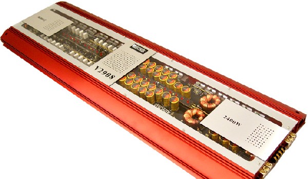

I dont want to be the car! its for a show car , my car has an old electrical system and it wont handle large current draw, a 1990 Saab 900, so i need a second battery, i cap am told is pretty rubbish?
I dont want to damage my electrical system or damge any wires!
I cant afford to rewire an old car?
u need high power only for the "show" so i think that wont be a problem , after the "show" 🙂)) u can remove the battery without charging 2 at once
Thats a good idea SSS!
Just for the show but the main amplifier will always be in the car, it is over 1 metre long with 48 mosfet transistors per side, its long and slim! and it draws to much current,
I think for the show a second battery is a very good idea, but i would want to charge it from the cars altenator, its would be less trouble in my life! and i have lots of trouble guys.
I dont like to much loud bass but people want to see what my subwoofers can do so they want to hear the limit.

I think i will get a second battery, i just dont want anymore weight in the car, The amplifier is a Visonik,a V290 its not a high quality amplifier but i only got it because it was very cheap and powerful, i ahve upgrader the transistors and capacitors, it sounds much better now!

Ther has Been a lot of grat advice poested but this is my 2 cents.
I would first try the inexpensive stuff first. Get a few pices of 4 guage wire and up grade the following connections:
A) Ground between the battery and the chassis
B) The chargeing wire between the altanator (this is probably where the weak link is in your system.)
C) The Ground between the Engine and the chassis. (a Side effect of this will be a Slight increase in performance. NOTICE I said slight.)
once I had gone that route then you might want to constier Caps Spare batteries ect.
The reason I said this was because it would only cost you about 20$USD and it might take care of your problem instead of the other 100$USD+ options.
another option is if you have a shop near by that rebuilds altinators. if they are a reputable Shop and know what they are doing they can wind you a beefieer alt for a little extra $$.
