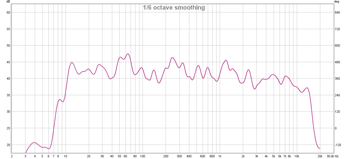

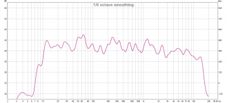

Until somebody shows me FR of their sub-sonic home speakers, I remain skeptical of their claims. Yes, there are systems that do go down low. I'm not saying it can't be done.
See attached.
Not a particularly impressive system, 2x12" on one side and a single 21" that's doing a good impression of a side table at the other.
The main speakers go down to about 50Hz, so the subs are only covering the VLF.
Chris

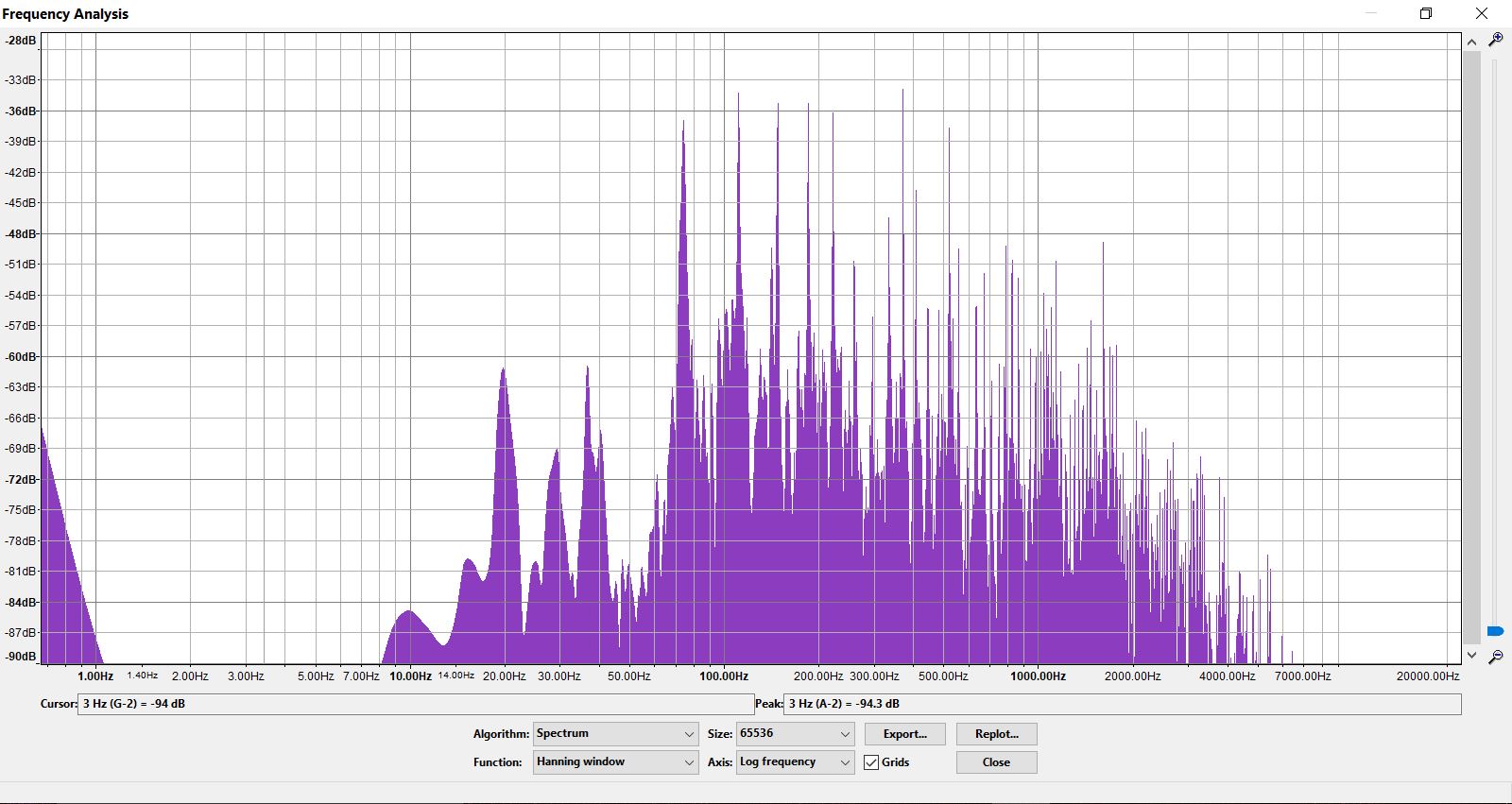

I wonder how much fundamental is in the lowest piano notes relative to the harmonics. I suspect the vast majority of the power is in the harmonics, and that's surely the way we recognize the pitch of such low notes. The fundamental of the lowest half octave could be totally filtered out without being noticed as missing.
Here is bottom D on two grand pianos and the FFT. The audio samples are attached.
I forget the context of it now, but I remember reading years ago that if you played Bach's Toccata and Fugue via a tiny 6 transistor AM radio to a musician who had never before heard the piece, they would be able to correctly transcribe the lower organ pedals. In other the words the harmonics had all the audible clues of the fundamental.
The fundamental on these piano samples is 36.7Hz
Thanks Mooly. People tend to forget that much of the energy in a note isn't in the fundamental, but in its harmonics. Your graphs show that well.

If you apply a steep high pass filter at 55Hz to these piano notes, you will hear a slight difference, but it doesn't change the perception of pitch, only a slight change in timbre. On a system that doesn't play below 50Hz (most) you might not notice. I was using headphones.
