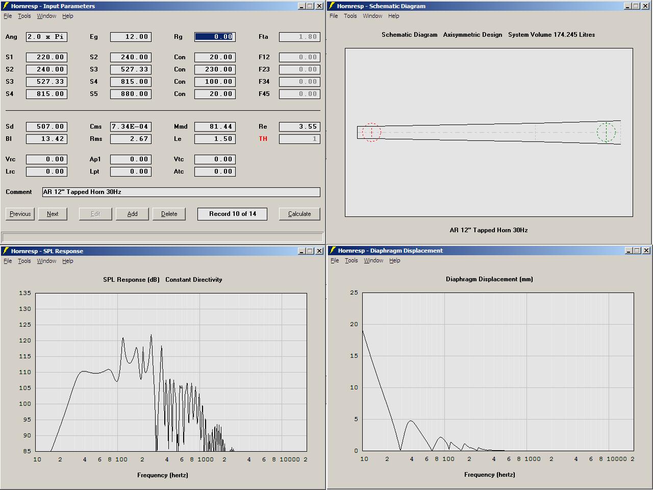

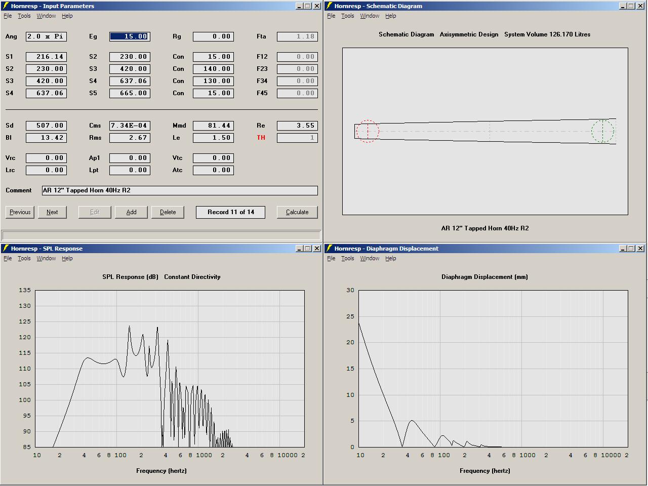

How low should i tune this TH?
I have spent quite a bit of time on HR trying to come up with a TH design for this driver. I hope to get some feedback from the more experienced TH builders out there.
The limitation of this driver is its 5mm XMAX. I know, i got it cheap, hope i can make a decent TH subwoofer out of it.
Should i tune it to 25 Hz, 30Hz or 40Hz? It will be a mainly for music, with some movies duty. since 5mm XMAX is not much for HT. I was hoping it could make up with the higher sensitivity from the TH.
Where is the sweet spot for the trade off between max SPL and extension?
25Hz - 108dB
30Hz - 110dB
40Hz - 113dB
Thanks for comments!
