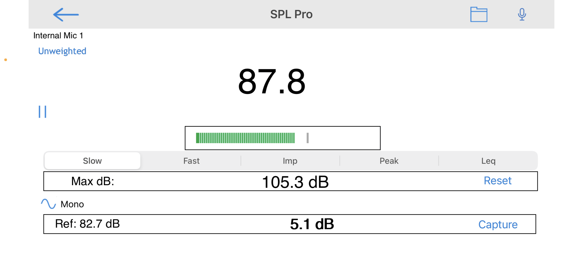

Recently watched a movie with my daughter- Kung Fu Panda 4 at our local cinema. We were 2/3 towards the rear and in the centre. Most of the dialogue was jumping around ~75dB at our listening positioning. Quiet scenes were few and far between in this kids action movie, but got just below 60dB. During the explosive action scenes SPL pipped just over 105dB on few occasions.
This was screenshot during music at the end credits:
This coincides with my preference for movies at home. Adjust for clear dialogue ~70dB at MLP

Do you have this measurement saved? What's peak level?Recently watched a movie with my daughter- Kung Fu Panda 4 at our local cinema. We were 2/3 towards the rear and in the centre. Most of the dialogue was jumping around ~75dB at our listening positioning. Quiet scenes were few and far between in this kids action movie, but got just below 60dB. During the explosive action scenes SPL pipped just over 105dB on few occasions.
What you describe is EXACTLY ATMOS reference level! 30dB for speech to explosion is a little more as I expected but 75dBSpl for speech is already relatively loud, I stay with 65-70dBSpl at home for dialog.
100-105dBSpl for an explosion is not really that loud - when the speakers can do it with low THD. That's very different to listen to music with 100dBSpl, which is about "normal" concert level. We can take loud, short events pretty good, but 100dBSPL for an hour needs earplugs.
