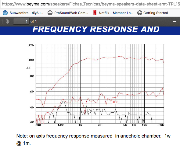

So interestingly, if I'm reading it right, the Beym TPL 150H has significantly higher distortion than a JBL D2430K compression driver, but a much MUCH better impulse response? Poor impulse response would be a form of distortion though right? Is it not catered for within THD figures?

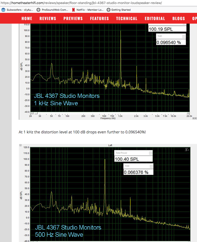

From the TPL150H spec sheet, THD at 100dB one meter appears to be around -50dB at 1kHz, rising to -40dB at 10kHz.
From
JBL 4367 Studio Monitor Loudspeaker Review - HomeTheaterHifi.com
the JBL D2430K (dual annular diaphragm) in the 4367 at 100dB one meter appears to be around -60dB at 1kHz, rising to -50dB at 5kHz. The D2430 woofer at that level has a bit less distortion.

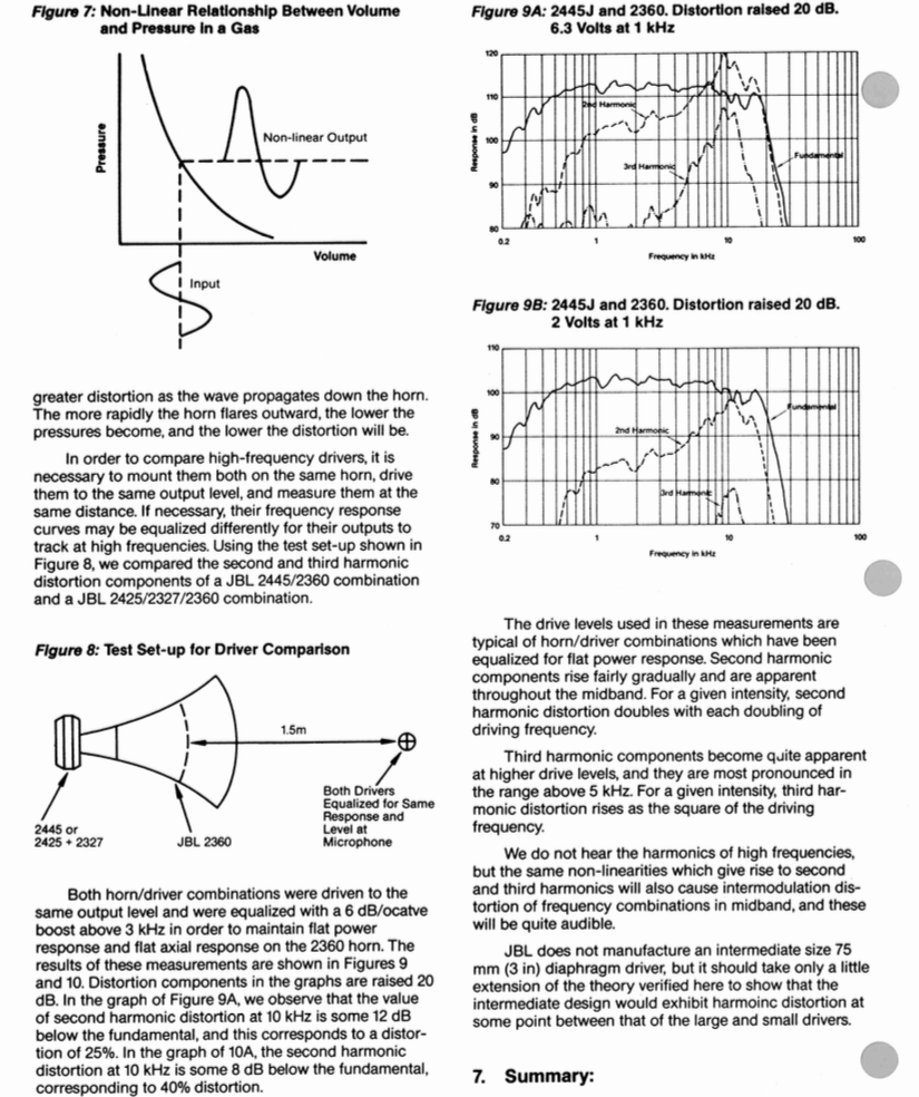

The 4" diaphragm 2445/2360 combo at 1.5 meters and 100+ dB comes in at around -40 at 1kHz, rising to -20dB at 10kHz.
At typical home listening levels for most of us, the distortion components for speakers like the above will be below ambient noise levels. When listening at 100dB plus, you may find, like me, your hearing, rather than the speaker distortion is more of a problem.
So yes, academic pursuits. But take a listen, compare your distortion sensitivity to others:
