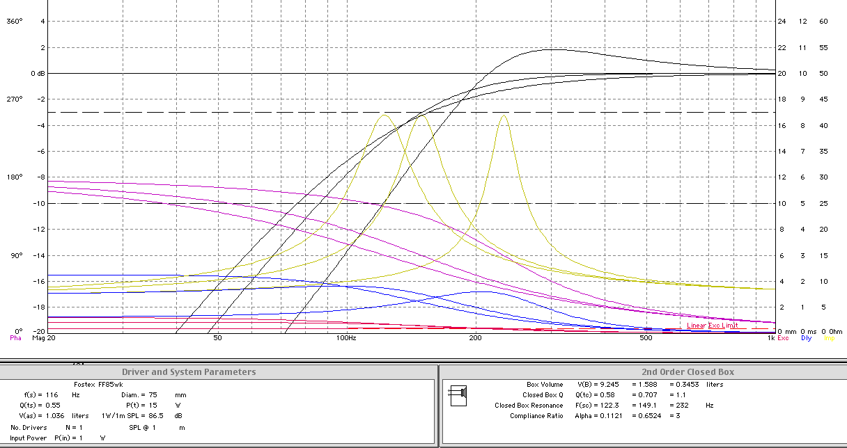

Are Fostex' quoted specs accurate enough for box modelling?
Yes.
Run FR we get about 90 Hz out of them.
Crossed and used as you suggest, they can be used this low.

a sealed box
Theboxi referred to is the uFonkenSET
Sealed sims attached.
dave
