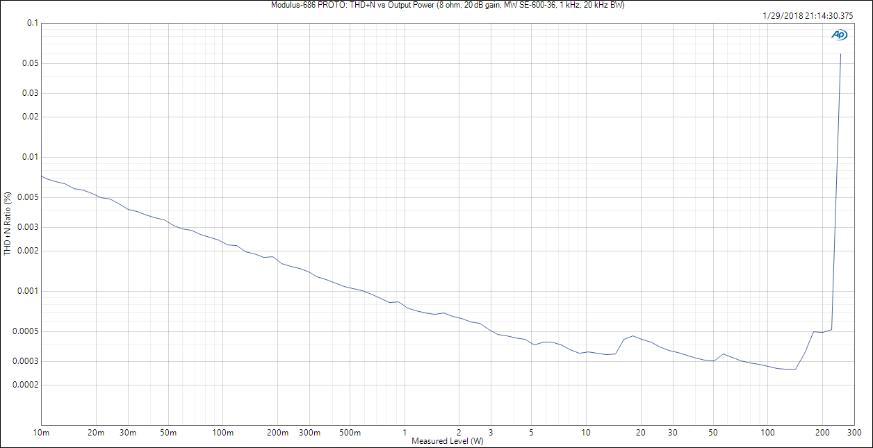

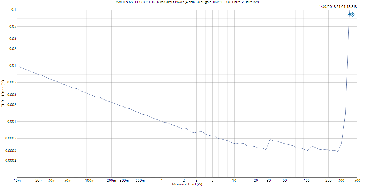

It was suggested to me that I throw my name in the hat here. I am measuring the following on my Modulus-686 prototype.
Gain: +20 dB
THD+N: 0.00026 % (140 W @ 8 Ω)
THD+N: 0.00029 % (260 W @ 4 Ω)
Onset of clipping: 0.0005 % THD+N @ 220 W (8 Ω)
Onset of clipping: 0.070 % THD+N @ 380 W (4 Ω)
Noise: 15 uV RMS (A-weighted, 20Hz-20kHz)
Build cost: $300/channel + power supply, connectors, heat sinks, etc.
I've attached the THD+N plots. I'll start a separate thread for it in the Vendor's Bazaar over the weekend, so if you have questions, please keep an eye out for it there.
You can find the numbers for my Modulus-86 here: Modulus-86 Rev. 2.2: Composite amplifier achieving 65 W (4 Ω) at 0.00006 % THD.
A brief summary:
0.000061 % THD (1 W, 8 Ω, 1 kHz).
0.000067 % THD (40 W, 8 Ω, 1 kHz).
0.00038 % THD+N (40 W, 8 Ω, 1 kHz).
