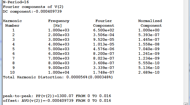

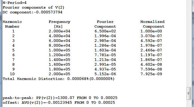

How about collecting in one single thread, the specs (and features) + description + link, of all amplifier projects, finished or ongoing on this forum, instead of having them buried in thousands of pages and hundreds of threads?
Benefits:
1. A general Reference to easily find, compare and chose an amp for builders,
2. Motivation to design or build a better amp,
3. Competition and reward for designers,
4. Motivation to actually measure the performance of an amp objectively (virtually or physically), instead of guessing and having no clue about its actual performance, playing a Russian roulette, or relying on subjective colorful poetic words like "the best" 😉
5. Unburial of forgotten projects.
In my view, faithful reproduction is the ultimate goal for an amp (provided it is also highly stable and reliable) that means: the least altering of the input signal.
Adding 2nd harmonics for example (tubes), while might sound good to some people, it is NOT a faithful reproduction, it was NOT the artist's intention (he can take care of all that in the mastering stage, no need for the user to add more) and it can even be added artificially as a sound effect that you can switch on or off if you want, instead of having it permanently and always coloring all kinds of music you listen to.
The level of distortion and quality one can hear is unknown, it varies depending on the content, the conditions, the person, etc. so we just aim for the least distortion (=highest linearity) possible. Of course, important is also the signal to noise (SNR), power bandwidth, etc. In my experience, one great benefit when aiming for perfection is that you end up discovering new methodologies and topologies, that aside from contributing to the amp technology, they can lead to an increased overall quality (not just THD).
Suggested specs (the more, the better):
- THD % at both 1Khz and 20Khz at full output and load and at a given input voltage,
- Power bandwidth range in khz at full load,
- Bandwidth -3db,
- Max load,
- SNR (signal to noise ratio) in db (can be easily calculated from rms output noise and peak output signal): 20*log10(VPEAK/sqrt(2)/rmsnoise) -even Google can calculate that)
measured at 0 input resistance and at an average real-life value.
- Amplifier's input and output impedance (when applicable),
- Phase, Group Delay graphs for the audio spectrum,
- Gain,
- Gain flatness for the full audio spectrum in db (16hz to 20Khz),
- Damping factor,
- Power consumption, efficiency, Class,
- Operating temperature range (for the claimed specs),
- Other specs, pros, cons.

Project: SS DC DD Electrostatic Headphones Amplifier.
Status: Under development.
(to be slowed down to a minimum for a few months, as I have to finish another project first (software), that will help earn a living.
That said, I just received the first batch of components, in order to have them when I'll need them, as the availability for some of them is very limited. I'll also use them to verify some parts of the simulated design in practice.
Description: Solid state, Direct-drive, DC, high voltage output, extremely-low distortion and noise, capable to drive two+ ES headphones simultaneously at full specs via two connectors.
Specifications: (preliminary, simulated for the time-being in LTspice, just a few specs for now)
THD at 20Khz: 0.000068 % (0.68ppm, -123.3 db)
THD at 1Khz: 0.000056% (0.56ppm, -125 db)
SNR (signal-to-noise ratio): -132 db
DC-20KHZ freq. response flatness: 0.0000428 db (42.8 micro-db)
DC-20KHZ phase difference: 0.044 degrees (44 milli-degrees)
DC coupled,
Direct drive
Conditions for the above specs:
Input voltage: 1V pp.
Max output voltage: 1300V pp. (gain = 1300).
Max load: 400pf (equivalent to more than two ES headphones driven simultaneously (eg Stax SR-009 = 150pf).
TODO: (I hardly have covered 30% of the total development).
DC servo, output protection, regulated supplies, addition of xlr inputs, digital inputs, a high performance DAC chip to be embedded, system health monitor, self-test, user safety, an attempt to solve a couple of essential unsolved amplifier issues, actual testing and development incl. reliability and stress-tests, a custom futuristic case and interface, PCBs, etc.
THD @20KHZ:
THD @1KHZ:

Mr.Magic: Just as a point of interest: ES headphones are typically driven differentially, that is, separate amplifiers driving the two stators in ooposite phase. So, is your 1300Vpp for one output or measured across both outputs?
I built a batch of ES headphone amps that are symmetric throughout and are 360ppb20 (20kHz) at 160Vpp output. Since the headphones have high efficiency of 100dB at 100Vrms across the stators (meaning 50Vrms per side, 70Vp per side), I decided that I was only going to design it for whatever output +/-100V rails would provide. So, the performance for the total system, including balanced input stage, EQ, width control and ES drivers:
140Vpp: 300ppb20 120ppb1, 100dB SPL
14Vpp : 10ppb20 <10ppb1 80dB SPL
I have no interest in average SPLs above 80dB, and even at that, it is very loud and takes a long time for your ears to recover.

@nauta,
-It is for one output, (it's a dual supply design in order to be capacitorless, all-dc) so diferentially the amp provides 2600Vpp between the two stators.
-I understand your point since you are making those amps for existing sensitive commercial headphones.
I decided to provide such a high voltage output, for two reasons:
1) After the amplifier, I am going to design and build a custom pair of headphones, that will take advantage of the high-voltage output to provide an extended and more powerful low frequency range (they will have a larger diaphragm area and a larger DS spacing).
2) I want the amp to be as powerful as the more powerful amps on the market (but with far better specs), capable to drive insensitive headphones.
For example, the Stax SRM-T8000 (in production) outputs about the same voltage (1330Vpp) but it's a hybrid one (tubes/solid-state).
An old discontinued hybrid Stax model SRM-T2 could output 1782Vpp! So there are insensitive old ES headphones out there.
