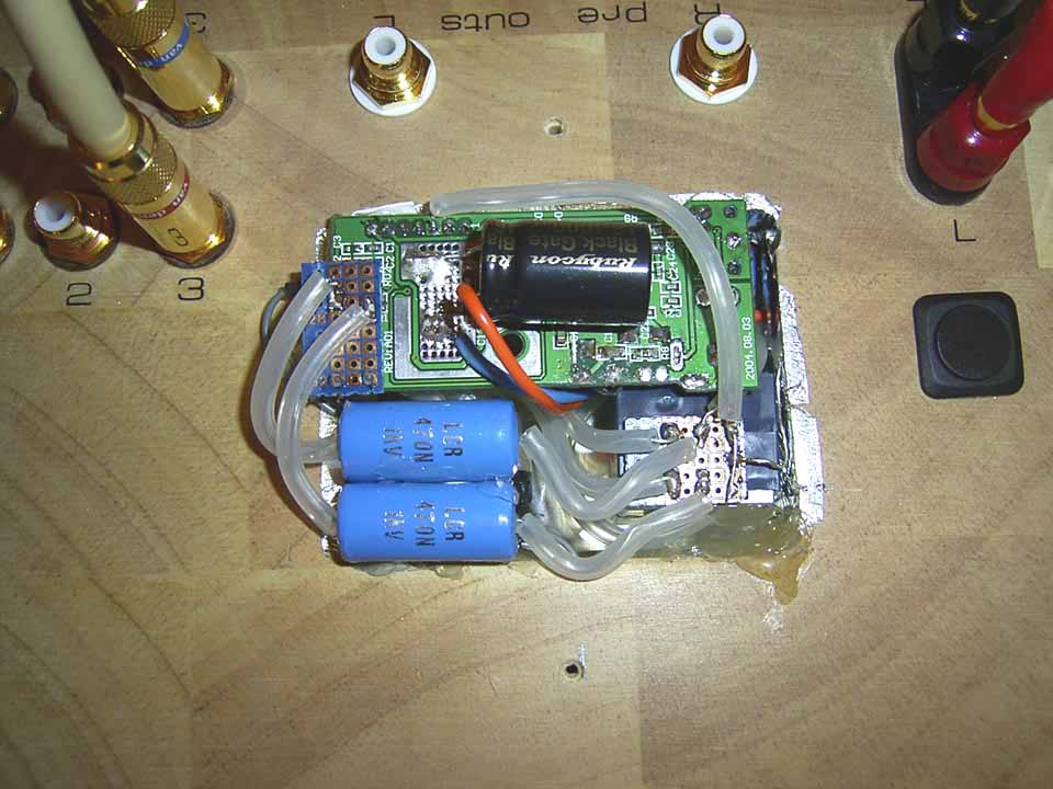

This question gets asked all the time. Let me try to make it clear. The input opamp of the Tripath chip runs at a Vcc of +5volts and is grounded for the 2nd voltage. The correct operating point for the input circuit is ½ Vcc which means it is operated at 2.5v above ground. If you short the cap out the chip won’t work as the input circuit is now referenced to ground. In order to make a higher quality off board cap work, the on board one is shorted out and the input to ground resistor is removed (If there is one as on the SI). Its equivalent is now placed across the input RCA connector, anything from 100k to 1meg will be ok. Now a 2.2uf cap can be connected from the RCA hot pin to the circuit board input pin. This circuit can not be directly DC coupled and still work with out some form of circuit to set the correct input voltage! It certainly is not worth the effort to do this when a cap does a fine job. If you have DC coupled it with no other cap the chip shuts down with an input overload error flag set. This will not harm the chip and it will work fine when you fix the problem.

and 50kohm would require twice the value or 4.4uf. In this particular case you would use 4.7uf as the nearest standard value
Is this the same as having a 50k Pot across the input?
Are we useing the big Poly' Caps used in crossover cct's as input Caps and must they be directional (polarised) or does it not matter?

Just to let you know I managed to find some compact 2.2uF Caps on the internet, so now all is well and sounding just as it should with all it's bass.:D Thanks for the explanations.
