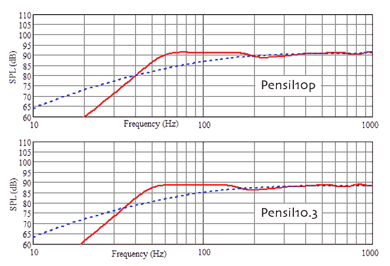

So Pensil 10s over the M10-A10? What sort of F3/F6/F10 will I be getting with those?
As far as floorspace is concerned the M10-A10s have a depth advantage. I'm a little apprehensive about the Pensil 10Ps as there is no spec out there for them.
Look at the posted anechoic sims. Add your room, then guess.
dave
Hmm... Brines M10-A10 goes about 10Hz lower 😀 . F10 is at 31Hz instead of 42Hz.

I would say that the M10-A10 -- a MLTL for the A10.3 is one of my better efforts. I did build a pair of Pensil's for comparison. There is a fairly significant difference in the tuning of the two boxes. My take is that the M10-A10 is better for classical and girl-and-a-guitar and the P10 better for rock. For what it's worth, my M10-A10's are the mains in my HT setup with a long NLA Peerless 10" sub.

So, how low do you think they actually go in-room by themselves? Feel free to post your measurements 😛

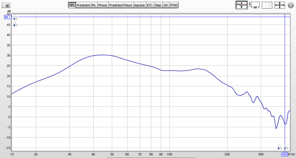

Here is another happy Pensil 10.3 user.
Yes 10.3 goes very low (15x15ft room)! After smoothing out two high frequency spikes (5100 and 7800Hz) and tweaking a little baffle step in mid frequencies perceived bass response is superb. I have used 1.5 pounds of Acusta Stuff for filing and some thick felt behind the driver. At 1.1 pounds total (0.4 less stuffing behind driver) will give you 1-2dB more Spl at 100-200Hz at cost of having couple of uncontroled resonances in mid and higher freqencies. Attached nearfield port measurement tells the story about bass extension.

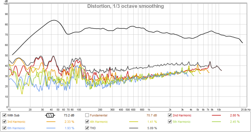

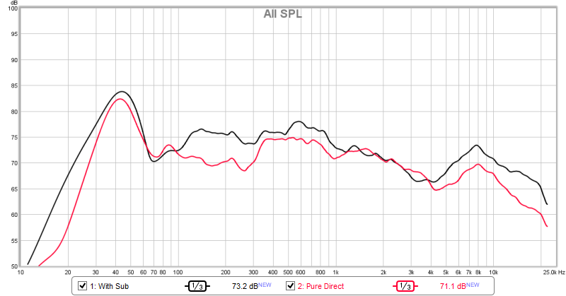

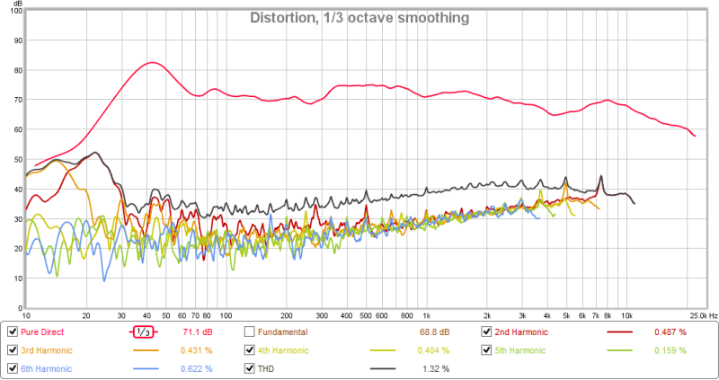

I got an opportunity to take some measurements on my M10-A10 (Alpair 10.3 in a 40" MLTL). The AVR is a Yamaha RX-V665. The sub is a Peerless 850148 in a 3'^3 ported box. The center channel is virtual. The rear's are Fostex FE167E's in ported boxes. The mains and rears are defined as small and the cross-over is set to 150Hz. I ran the automatic setup, then tweaked the EQ, although there are only 6 bands, so it is coarse at best.
The black trace is the Yamaha processed response. The red trace is "Pure Direct", i.e. mains only and no processing. I did not adjust the volume between runs. The "Pure Direct" sounds lower in volume, obviously. The big feature is the 43Hz hump produced by the relatively small room -- 13'x15' and open on one side. It is interesting that the distortion on the low end of the cross-over is higher with the sub on than with the sub off.

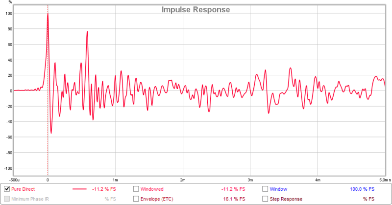

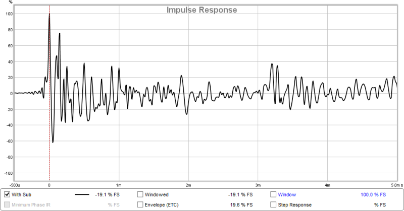

Looking at the impulse trace for the "Pure Direct", there are two distinct main pulses. This is because the listening position is slightly off center -- about 1' to the left. The Yamaha has correctly time aligned all five speakers.
OK. The A7.3's in my MLTL have an in-room F3 of 29Hz and F10 23Hz. This is based on the 1kHz level. Sort of indicates that model output and 1m on axis measurements are only vague indicators when you actually set up your system.
