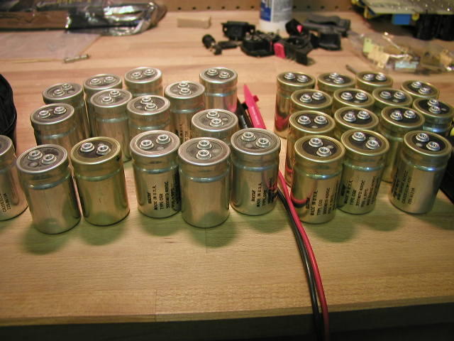

I have just removed some electrolytics from my preamp with a thought that I might use them in my SOZ. After I checked them I was quite dissapointed. They measure nothing and don't get charged when I connect them to PS. They've been in a preamp for 7 years and the power was always on. Four caps in parallel, 3,000uF/40V ea. Is that normal? I've heard about caps aging but never observed it first hand. BTW I still have the same caps which I never used and they measure perfectly. The ones that are more yellow are the defective ones.
Thanks for your advice.

I'd say about 10 -15 years, but with the improvements in capacitor technology you could get a whole lot more capacitance in a smaller space with lower ESR to boot, maybe it is time to replace those cans.

There are many factors
1. Technology: Dry electrolytics last "forever"
2. Wet ones: Depends on a) physical size (takes longer to evaporate), temperature exposed to, core temperature, construction of seals.
3. Overloading/loading -- voltage and current.
Caps that are smaller than .75" diameter should not be trusted for more than 10 years unless particularly high quality or if kept at low voltages, or better still low currents.
If they have not been used for a while, you might want to charge them up 10 120% of rating through a resistor so that current is kept low + leave with voltage on for 10-15 minutes. You could use say 100-1000 Ohms, it is not critical, but you probably need a high power unit.
Petter
Electrolytic life is highly dependant on how you use them. The big killer is heat. Heat can come from both external sources and internal sources. If you put those in a power amp that runs hot, that could be an issue. In a low temp pre-amp, that should not be so much of an issue. Internal heating is of course from losses in the cap from in-circuit use. One thing to watch is that you are not exceeding the ripple current. That can drastically shorten the life! If you look at electrolytic data sheets, they generally have a stated life at a given temperature. Reduce the temperature, and that life increases significantly. Not too long ago, most were rated at 85 celsius. Now, some of the better ones are rated at 105 or 125 celsius. That is better in terms of life, you still need to determine how they will behave in your system, though most of the high temp ones are also very low ESR and hence may make a good power supply capacitor.

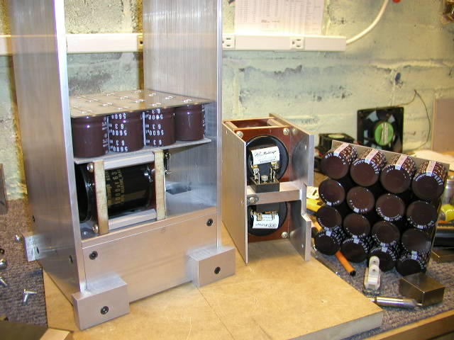

I am sure your new cap bank will sound better. Several audio manufacturers have replaced large electrolytics with many smaller ones. Lower ESR and better high frequency characteristics.
Your new cap bank looks good.
Jam
P.S. You must have a machine shop at home, you have got most of us jealous.
Your design looks very sexy
Your design looks very sexy. You may wish to solder wires onto the capacitor to increase the thickness of the Copper.
What I did was to use 2 copper sheets, and make large/small hole patterns + use spacers. That way I had .5mm Cu to handle current. I was further able to fold these plates so as to get very short distances to output devices.
I notice that you are using rectifier bridges. Shame on you! Get into some Hexfred's. I decided to standardize on 16ETH06 -- check out the specs at www.irf.com, but if you are using low voltages, go with Schottky units!
Qudos to you for doing the right thing while keeping the thing looking great!
Petter

I checked IRF site and I found 15ETH06 (16 is not listed). It's 15A diode. I had bad experiences before with blowing rect. bridges at turn on (I'm using thermistor as inrush suppresor). In your experience is 15A enough and what is the difference in sonics when compare regular bridges and Hexfred's?
