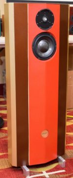

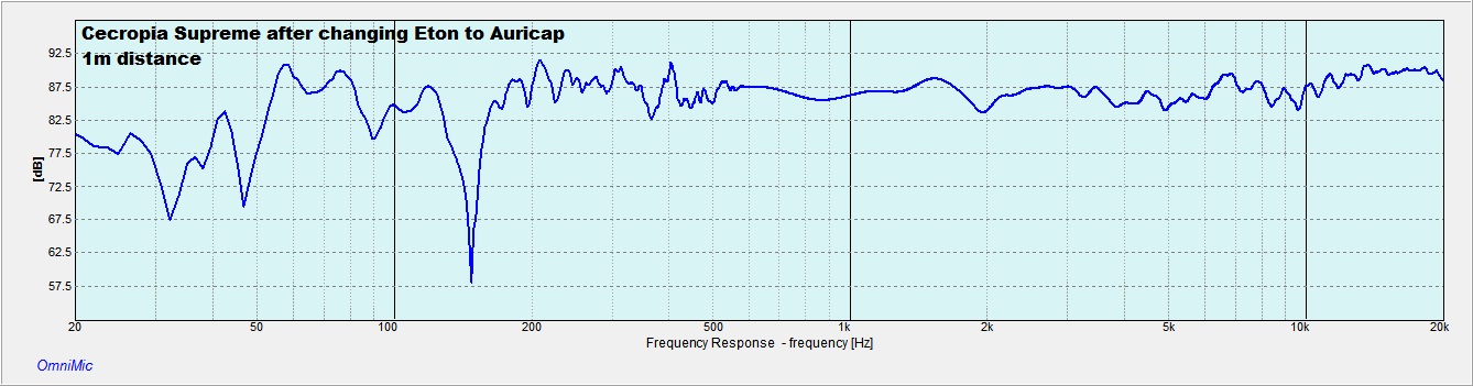

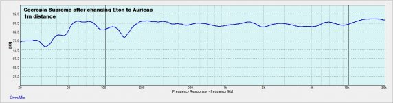

I finished my Cecropia project a little over a year ago. The initial thought process started 3 years before that. The actual building process was about 9 months. Then I wasn't happy with the midbass driver and swapped for a higher end driver from the same manufacturer. The transition was fairly simple, but took about 4 months to get where I wanted in the xover. Now I'm happy with them, and they are the best work I've done in a 2-way. The first full length photo is more exemplary of the color tones.
Very clear, open, and wonderful!
