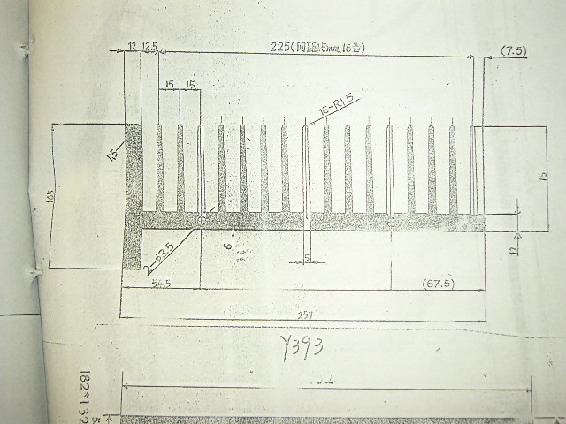

How large of this kind of heatsink for Aleph2
I want to make my Aleph2 2 mono in 1.
use the following Heatsink X 4
150X257mm
how High I need to make the Temp. not over 60dergee C or better 50 dergee below??
thanks!!!!
