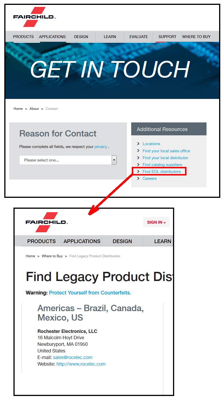

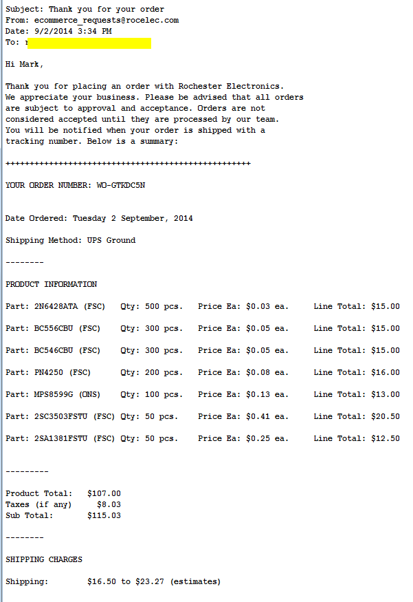

Rochester sells Fairchild 2SC3503F ("F" = highest beta bin) for $0.20 and the 2SA1381F for $0.12. (link)
I bought fifty of each back in 2014 when prices were higher. I paid $0.41 and $0.25 respectively. The invoice is copied below, see line items 6 and 7.
If you wish, I would be glad to sell you any amount up to 20 pieces of each, although I prefer that you support the new-old-stock ecosystem by purchasing from Rochester instead. To encourage you to source from Rochester, my price is $2.50 per transistor, either type, plus $5.00 per order for the shipping envelope and for my time spent at the post office waiting in line, plus $10.00 per order "convenience fee" if you prefer to use PayPal. If you pay by check or money order or cash, disregard the PayPal fee. Send me a PM with your order.

I checked with octopart/rocelec.com (rochester) and they have a minimum line charge of $100. They are worse than hamilton/avnet. So I don't think I can use 910 each of 2SA1381/2SC3503 in my life time, as much as I am hoarding leaded parts for my furture projects.
